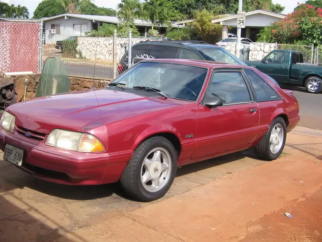

It is a 1993 Mustang LX 5.0, Electric Currant Red Pearl Metallic in color. All power, pony wheels, and an AOD. I got the car in 2007 as a trade through my 98 GT. only two owners and 93k miles at the time. The car was completely bone stock, save for a conical filter and an aftermarket CD deck. Everything worked except the cat back was rusted out. Thats okay, i was gonna change it anyway.

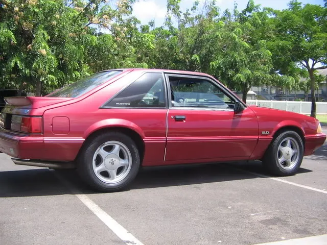

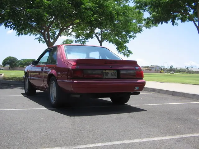

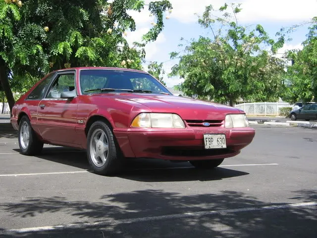

Pics of it stock: (Circa 2007)

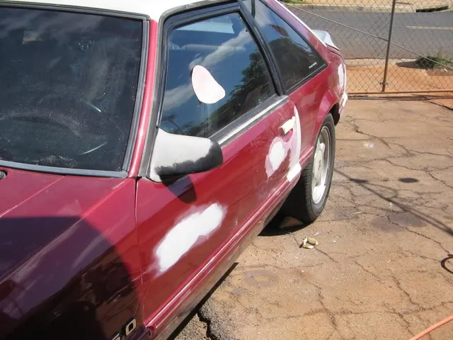

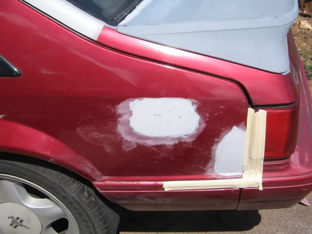

Although it looks clean, it really wasn't. It suffered from all the usual rust areas: Around the antenna, the lower part of the back window, and the edges of the hatch. Other than that, the car was clean.
About a couple years later we started to do body work in preparing it for paint. We were just going to repaint the car the stock electric red.

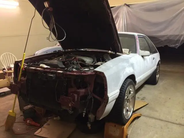

Some pics from that time:
So after filling dents, repairing rust, we sanded down the whole car and basically shot a gray primer around it. I also bought a set of 4 lug 2003 chrome cobra replica wheels from a friend.

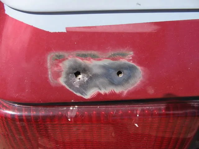

I wanted to get it back on the road again. I scraped up the money for the back registration, and got it road legal and fully insured. Now, over the years, weather and the elements took its toll on the car. Most of the rust areas on the hatch have come through again, so now that has to be redone. I polished the wheels and reassessed the car.

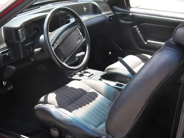

The interior was still in awesome shape, But there are some worn pieces that could be replaced. All the exterior trim needs to be replaced, as well as the headlights and taillight lenses. The car still ran perfectly. At first it had a hard time starting. We later found it was the fuel pump. 170 bucks later, a new one was in and it started perfectly.

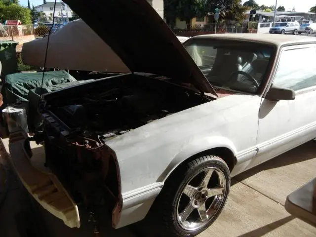

We then removed the front bumper to repair the core support. Apparently, the last owner got the car stuck somewhere, and had the car towed out with a hook. Well, that hook bent the bottom of the support. I thought about getting a new one and just cutting the old one out and welding the new one in place. Now, in hawaii, it is difficult to get stuff shipped here for cheap. My dad decided against that, and repaired it himself using some old jimmy-rigging and old school body shop tricks.
Heres where we stand in its current state:

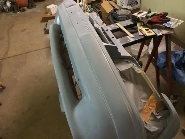

For now im just focusing on getting the body work done. Front bumper should be painted either tonight or tomorrow so ill have an idea of how the two-tone is gonna look.

The front bumper should be painted today, ill take some pics when i get home. Itll really give yall an idea on what the color scheme is gonna be like :)

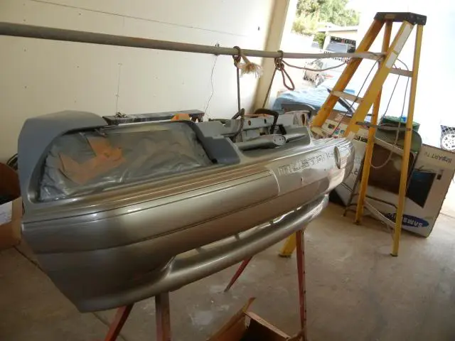

Happy New Year everyone! hope it was a good one for yall :)

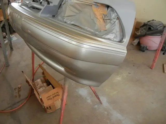

On a side note, we painted the silver yesterday :) it came out nice. I thought it was gonna be a little darker, but it looks to be the right shade. There are some small imperfections we have to fix before we can paint on another coat, but this one was basically a "test coat" to see where the break is gonna be made on the front bumper between the red and silver. Its not like the GT where its just a solid molding all the way around. We have to figure out some sort of break where the MUSTANG lettering is. Today we should paint on a test coat of the red and then yall will have an idea of the color comb. Ill get some pics up later today after work.
Stay tuned!

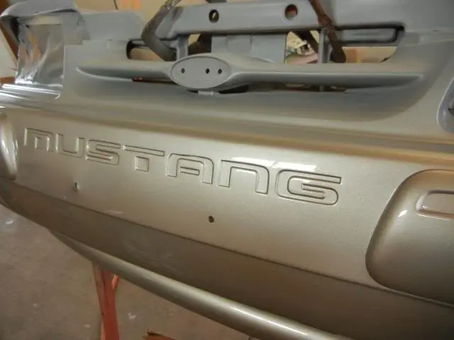

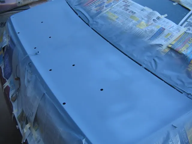

PICS!!!!!!
As requested... Pics :)
Its not much progress, but its something.
Should have the red on by tomorrow or friday :)

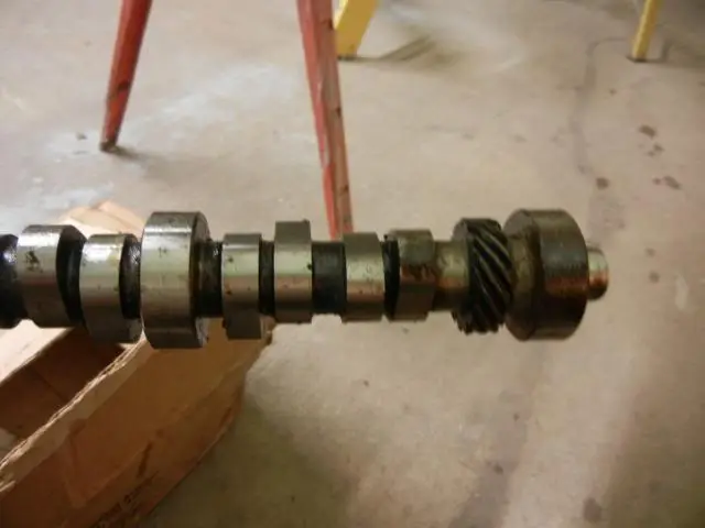

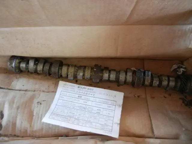

Also, my dad came across this today:

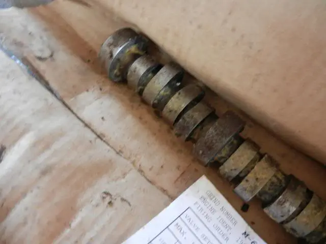

An E-cam i bought several years ago brand new. I wasn't aware i still had it, i sold some of my fox parts a few years back and the E-cam was supposed to be one of them. Anyhow, its been out in the weather, and it has rust on it. Is there anyway it can be cleaned to be useable? my dad said it could be cleaned but it could damage the cam bearings. I mean, id hate to throw it away, since that thing was almost 200 bucks.. Any ideas would be appreciated!
Thanks!
damn those look pretty bad. Take some WD40 and a scotch brite pad or 00 steel wool and see if that cleans it up. Don't get crazy on it.

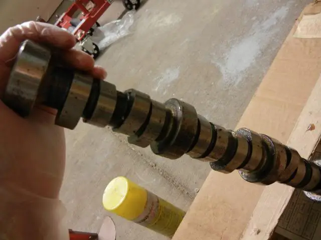

I cleaned it up a bit. used some brake cleaner and steel wool. most of it was the rust preventive gunk and dirt. There is some slightly deep rust on one end of the cam but some of the lobes are surface rust. after i cleaned it its not as bad as it looks, but that one end though..

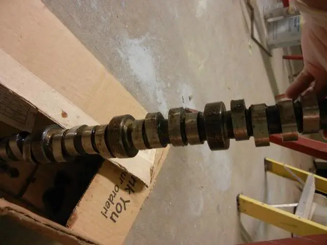

pics after cleaning with penetrating oil and steel wool:
Since i got rid of the old rust preventive gunk, i took some 5w30 royal purple oil i had lying around, and put a nice coating on it, then wrapped it in newspaper and stored it in my storeroom out of the elements. i really hope it can be saved, i have part 1 to an HCI swap!
You're not going to like what I am going to say. I wouldn't use that in my car. Those lobes look wasted.
