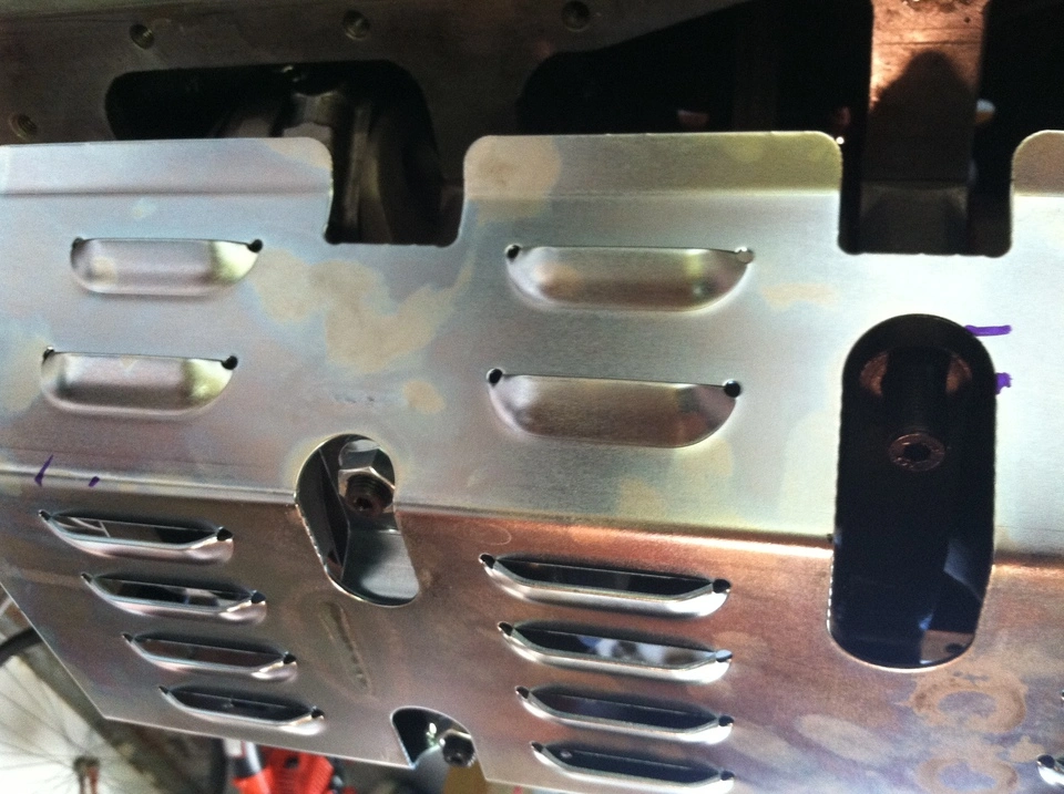

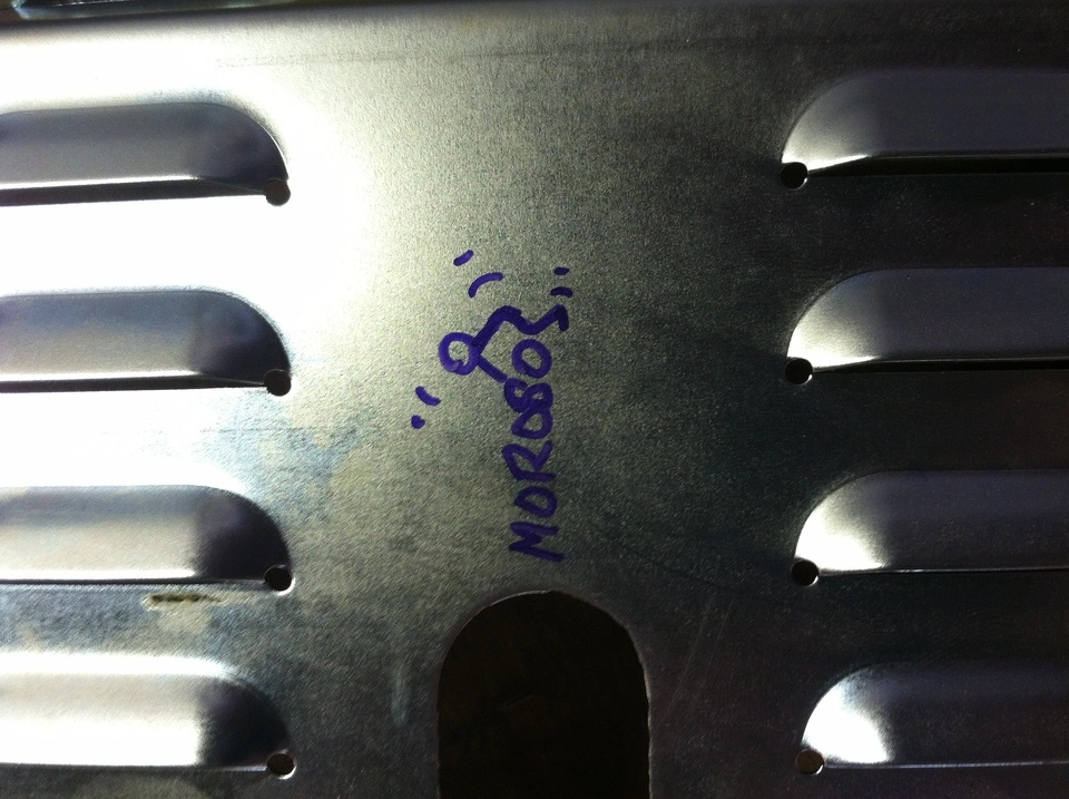

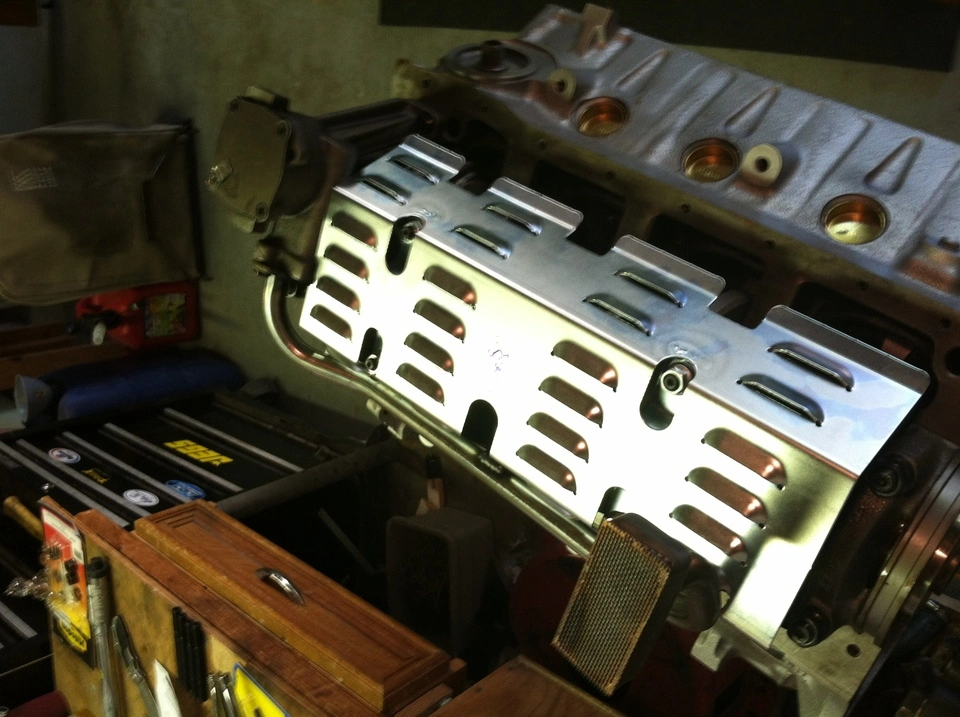

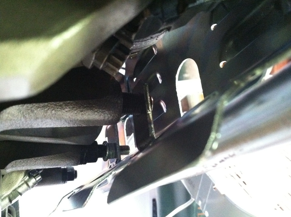

Yesterday, I decided to install the windage tray on the 408. WHAT A LOAD OF CRAP. After failing to realize you MUST buy the stud kit (+$44), that was ordered last week and got it yesterday. Studs are in fine. Windage tray goes on fine. Oil pump pickup? Not a popsicle's chance in hell this thing is going to fit. So I call Jegs.
Operator:"Oh, well on the instructions there you'll see that you need to order the PN 23894791823649782 MOROSO oil pump pickup."
Me: "Oh, well how much is that?"
Op: "$67"
Me: "HAHAHAH no thanks, I've got a grinder."
So grind I did.
Made some marks to show where I need to clear the oil pump, mount for the tube, AND the 90* elbow where it goes down to the sump.
By hoopty50 at 2012-04-24
This is how far down it needs to move:
I was angry. This made me feel better. And a message to whoever buys my engine.
I'll spare the ugliness I made with my trusty DeWalt grinder. Here's how I left it, completed.

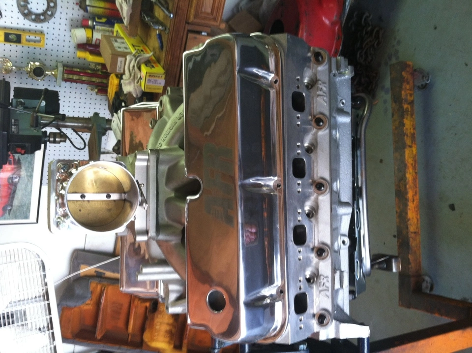

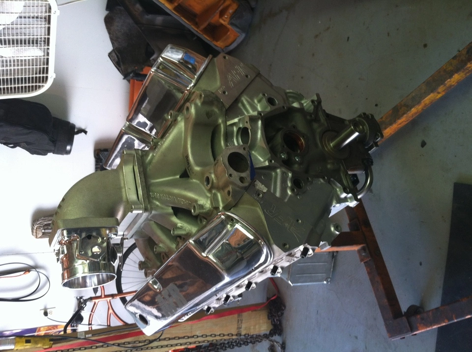

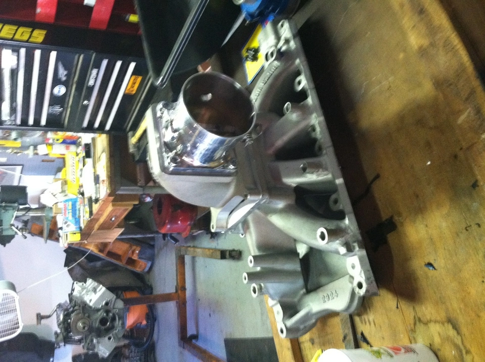

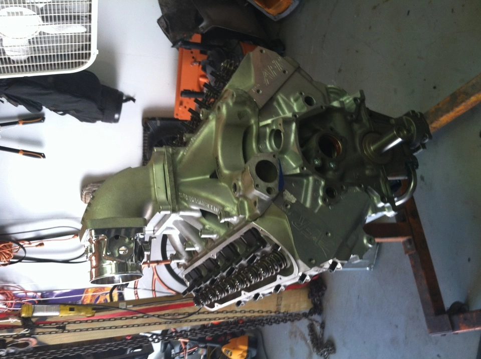

let there be EFI!!
By hoopty50 at 2012-04-25
Oh wait, it doesn't fit.
crap.

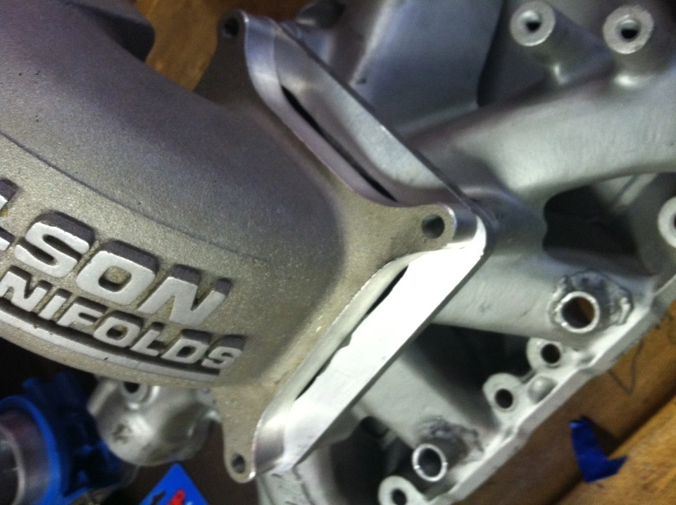

After a little research, I realized I have a 4150 flange intake and the elbow definitely isnt that. So, I guess I'll be selling it to buy the correct one.

Or, look in Summit and buy a squarebore to dominator adapter.
unless hood clearance is an issue..
http://www.summitracing.com/parts/EDL-8716/
hoopty5.0
mechanicus terribilis
Dec 14, 2010
7,815
6,970
214
SW Houston
Apr 25, 2012
#193
  • Apr 25, 2012
  • #193
Naww mayne. I needs an excuse to run a 10" cowl hood anywayz .
But seriously, would that work? Hood clearance is probably going to be an issue anyway
Boosted92LX
Dec 19, 2010
5,721
4,244
224
Apr 25, 2012
#194
  • Apr 25, 2012
  • #194
Sure it'll work. All it is is an adapter plate to run a double pumper carb on a dominator 4150 flanged intake or vice versa if you flip it over. Your elbow is the smaller double pumper style "square bore" carb flange and the intake is dominator. Nuttin to it.
it will make it 2 inches taller, though.
Boosted92LX
Dec 19, 2010
5,721
4,244
224
Apr 25, 2012
#195
  • Apr 25, 2012
  • #195
Here's one that's a little shorter.
http://www.summitracing.com/parts/PFS-20100/
Look around and see what else is out there, seems like I've seen one that was one inch thick some years back, if it's still made. But, keep in mind the thicker it is, the better the transition will be turbulence-wise.
I think Im going to look for something like that. Seems to be the best way to go.

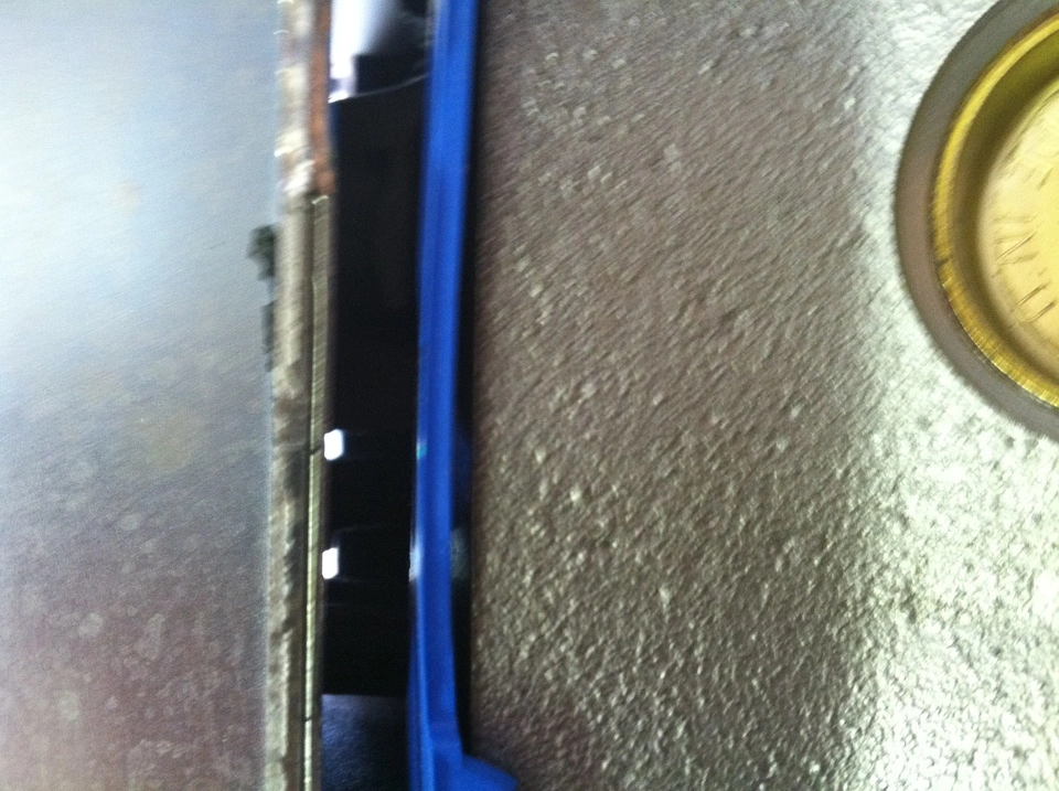

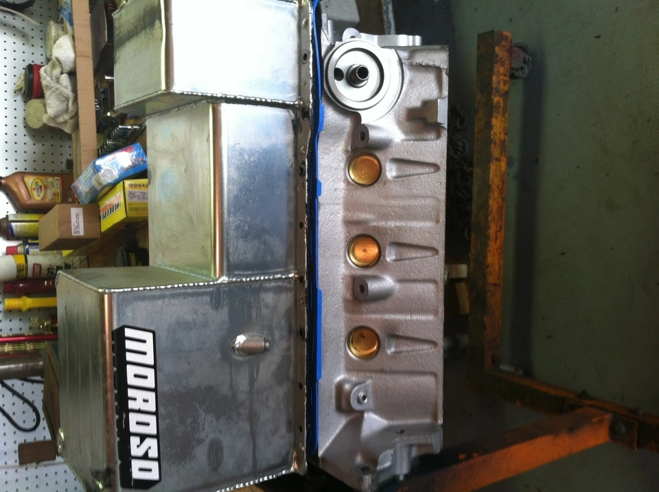

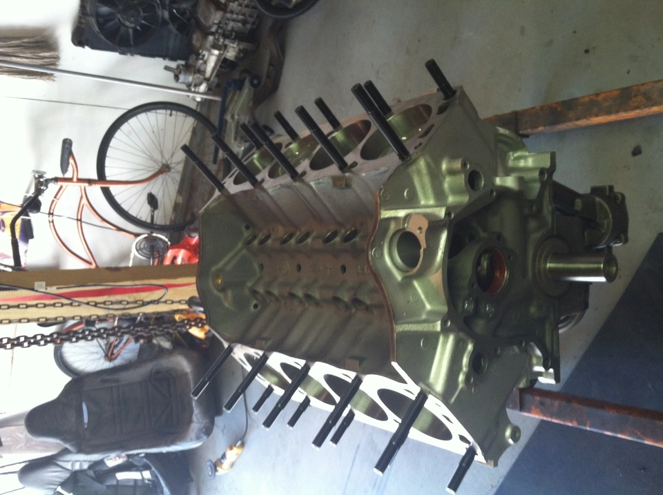

Well, I had more fun with moroso products. Here is the gap between the block and the pan. The pump and pick up are too tall for the pan.
So, instead of losing my patience, I just flipped the biotch over and kept going.

Looks great. Too bad I'll never hear it run after a year of building it. Ah well. Going to get the new one tonight @ 8. Pics soon after.

Oh, and the rear most bolt holes for the Mororororoso pan are INSIDE the pan. HOW do you work around that?

Wow that's tall. Maybe a spacer/adapter isn't the best choice..Lol..

  • #199
You have to have the wrong pan then?

More than likely. I got it off Corral. I believe I will be sending the guy an email containing the letters W, T, and F.
