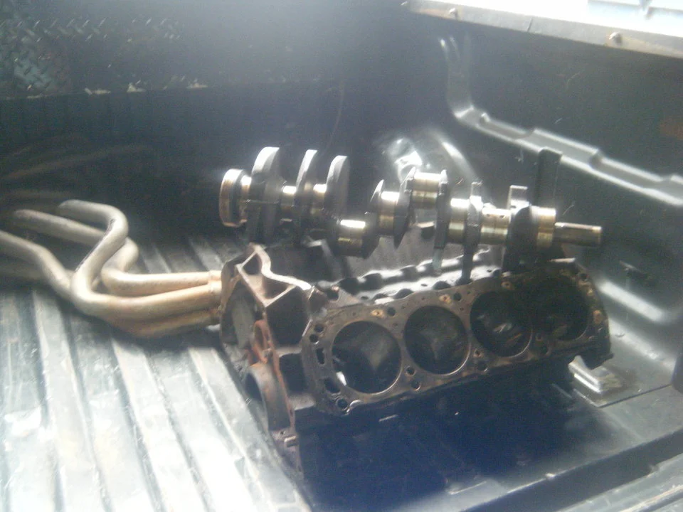

Next, I took apart my 351 block to take to the machine shop. This will be a 408 short block soon.

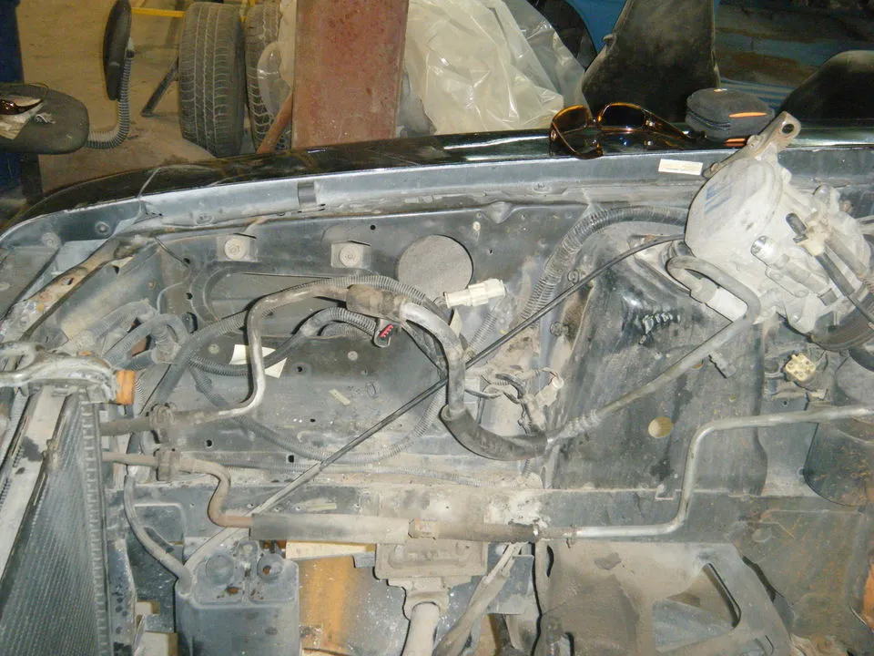

Pulled the stock engine and trans out. Blown head gasket and probably a freeze plug??? dont know yet. But I am going to fix it and put it back in until I can complete the 408 to keep it driving.
Going to clean up the engine bay. I want to weld all the holes, but I understand its a pain. But looks sooo good when done. Will start it tomorrow I guess. Here are the inner fenders, needs a serious clean up first.
By hoopty50 at 2011-03-27

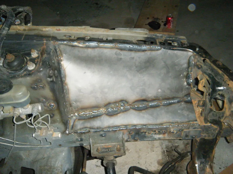

look like your off to a good start and the saleen's look good on the black car. i helped my buddy weld the holes in the engine bay and learned to make shure you have like .23 or .25 mig wire because some holes are small and can melt easy with heavy wire like .30+. best of luck and hope to see some more pics.

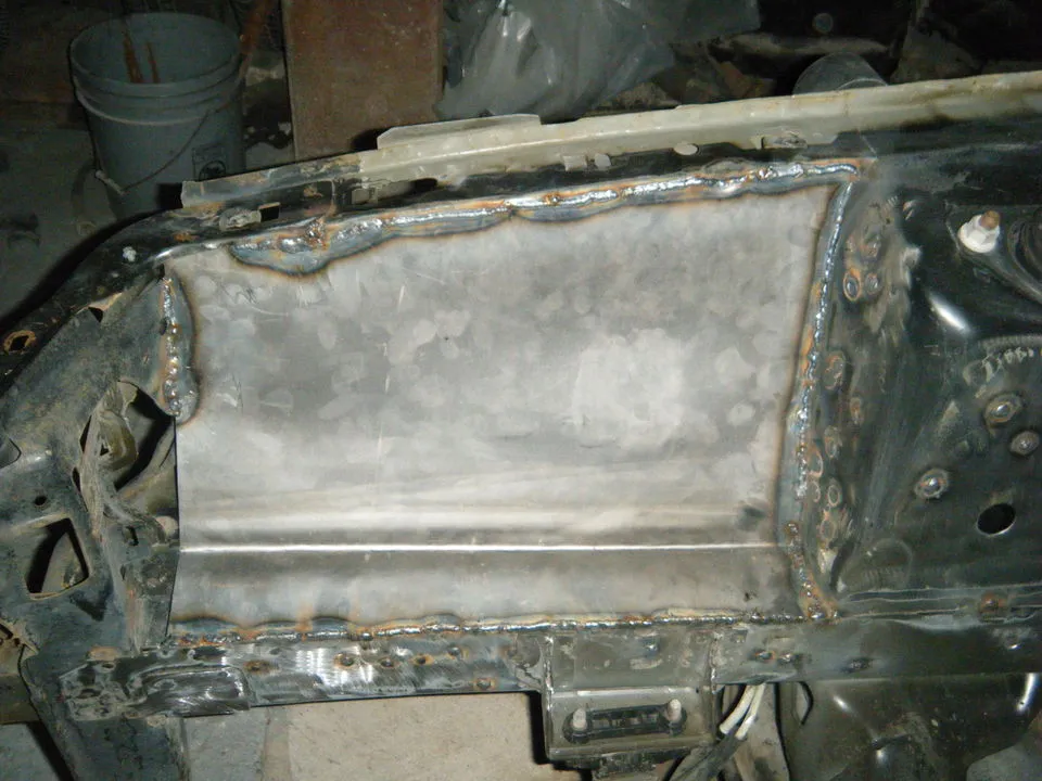

Tanner: I went to Loew's today and bought some 22 gauge sheet metal. I made some panels and when ground down and painted tomorrow, I think they'll look just as good.
I'll have some pictures up from today's work in a few minutes.

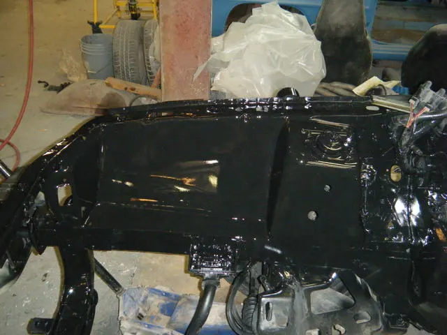

I got to the shop late today. Allergies are the biggest thorn in my ass. Anyway, I got the car outside and cleaned the engine bay:
Then back into the shop to make panels to cover all the ugliness that lives under the hood of foxes:
Tomorrow, Im going to knock down the welds and get started with the body filler. Going to keep the engine bay black, but will put a layer of clear coat over everything to make it look nice. Luckily, I have the use of a paint booth and all the expensive guns you could ever want. Should come out nice...

Didn't get much done yesterday. ended up grinding through some welds on accident. Gotta go back and reweld some stuff. Hopfully be in the paint booth this week.

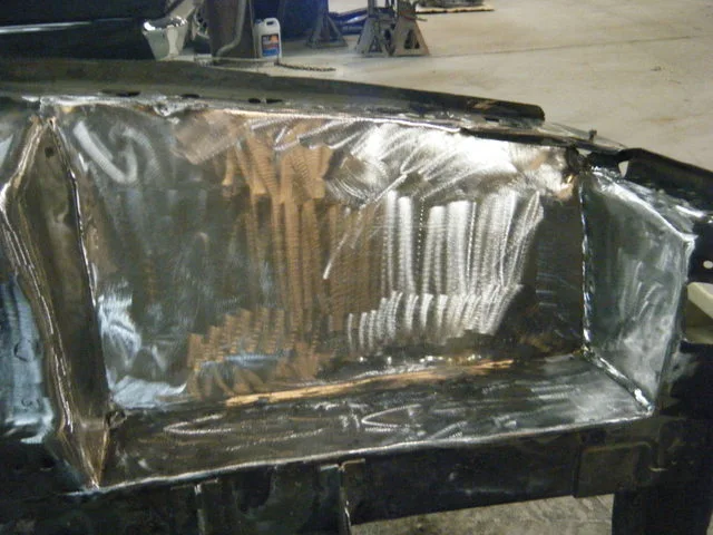

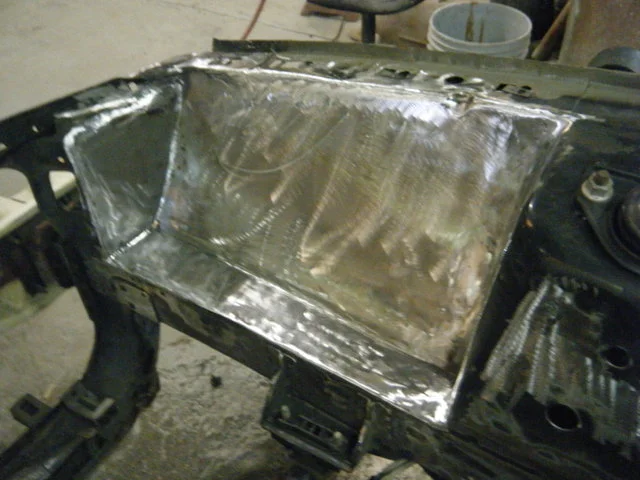

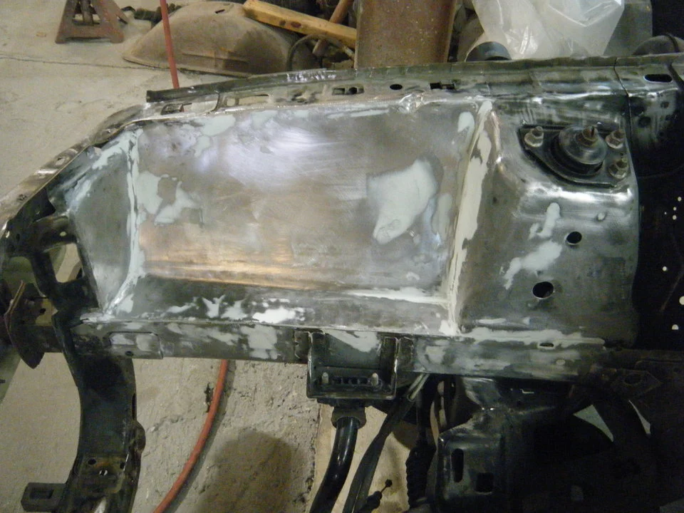

Well, I completely understand what the people who have smoothed the engine bay before are saying when they said "never again". Truly a PITA. Anyway, here are some more of the photos I took as I went.
Welds Ground down:
After the metal glaze was applied and sanded:
First coat of Epoxy:
So that was up to this morning. I am really unhappy with a couple of places on the passenger side fender. Black isnt really a color to hide imperfections as some of you know. So I'll be pulling the glaze back out to clean up a couple more spots and then shooting another coat of epoxy and then going over it in clear.

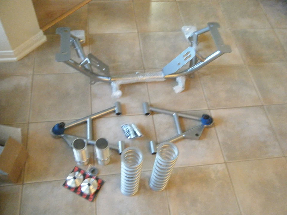

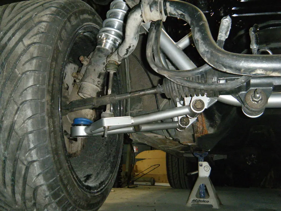

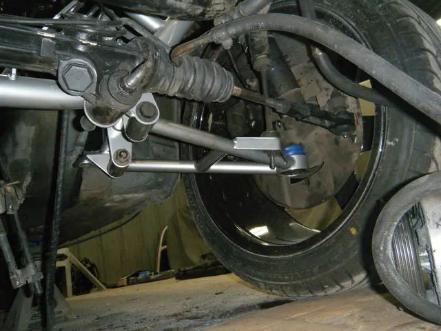

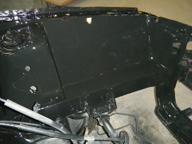

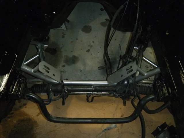

Anyway, I got the engine bay painted and cleared and my tubular front suspension installed. Will get the pics up as soon as they have uploaded.
Collin
Ok, here is what I have of the completed engine bay and front suspension. Please excuse the dirty parts under the car. I was working under a time crunch and had to get it rolling again.
