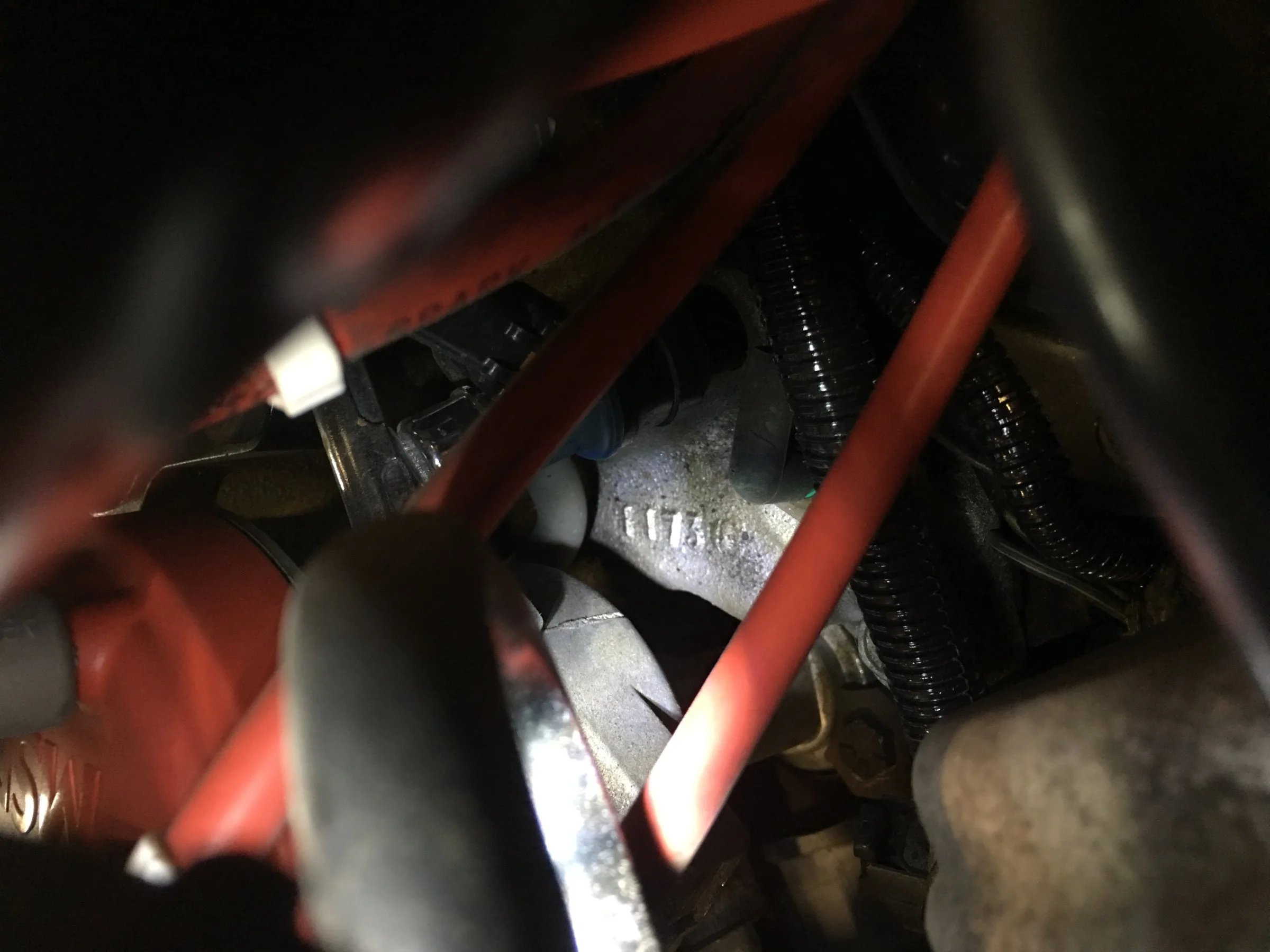

I see the firing order near the distributor and then this cast into the other side of the intake. I assume it’s a casting date.
