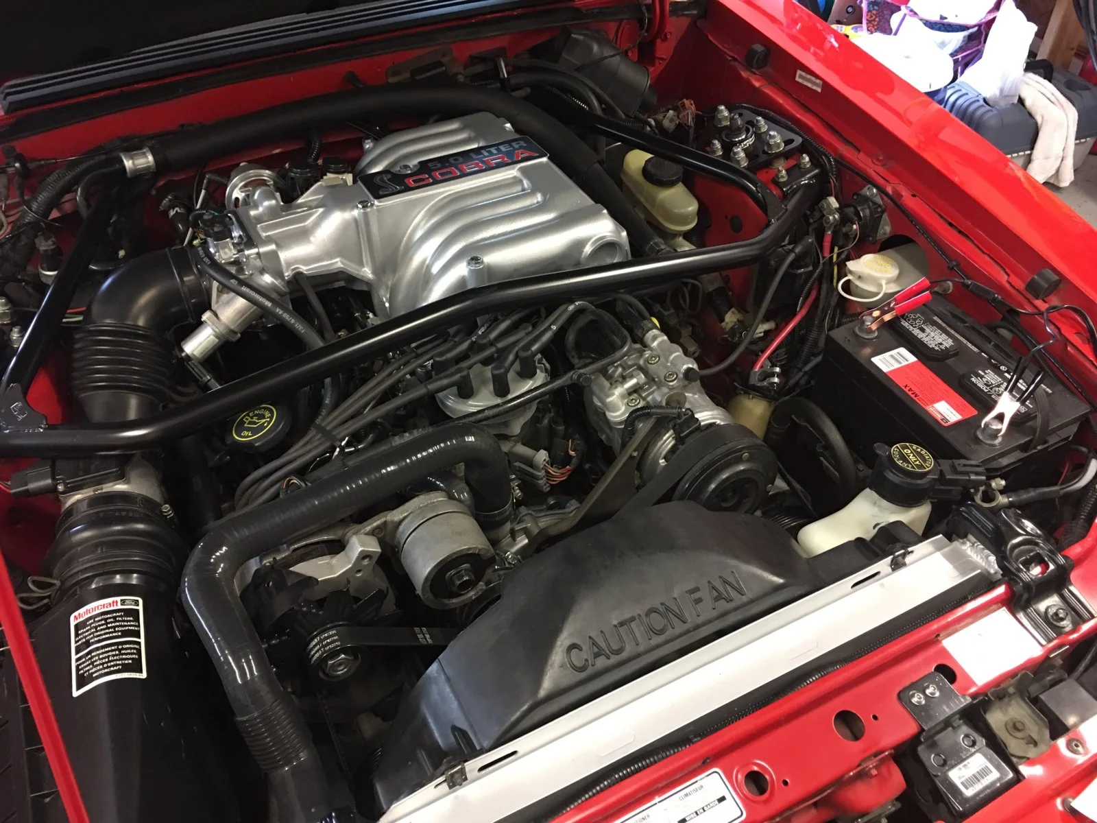

Motorcraft battery looks more at home in here. So long green top interstate. Hadn’t started it since October, battery was very dead. Had 4 Volts when tested. Damn ford alarm.

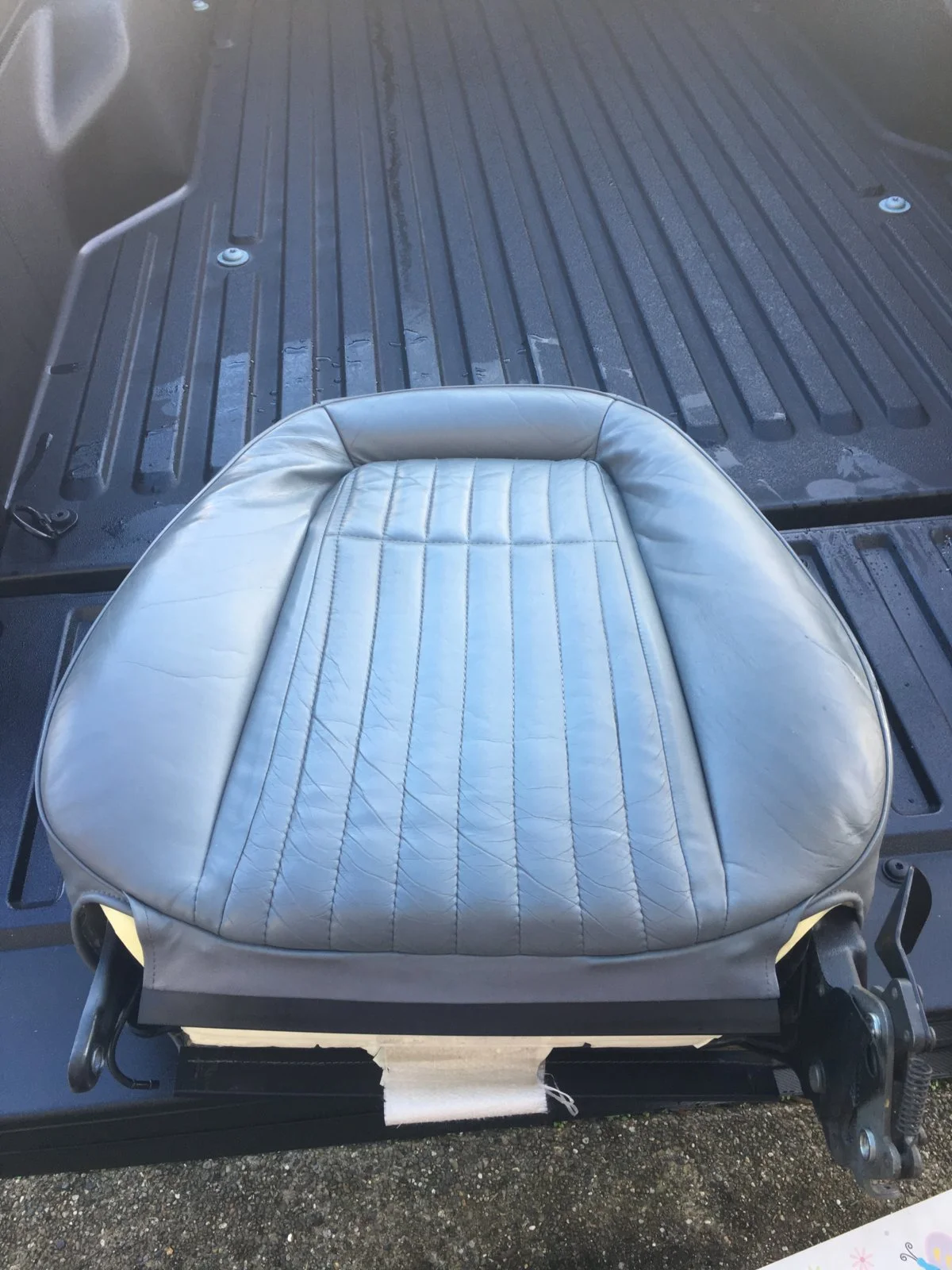

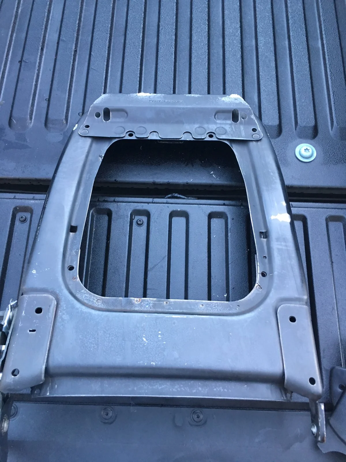

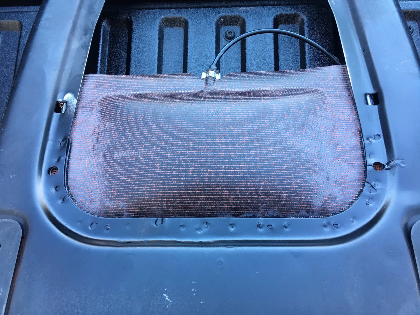

Any trick to getting the upholstery off the seat back? Gonna fix the gangster lean
Unclip the bottom. On the front there is usually Velcro up the verticals sides of the center insert and possibly hog rings up at the top.
Basically put the top Down on the ground and peel the cover down slowly. Nothing secures the back side but try not to rip the Velcro out of the foam
Reactions: Tubbster66
Well I figured it out. Just peeled it. I brought the seat back inside for a couple hours to warm up which helped a lot. I’m recovering from pneumonia and a sinus infection and am not full strength but can’t sit around for too long.
Pretty much did all that before I read your reply. I didn’t see any Velcro. It has new foam so maybe that’s the difference?
I welded up the old seat backs that were in my car. Made a huge difference. Would be nice if someone made reinforcement plates for fox seat backs. If you lean back too hard they will crack and get that gangsta look.
