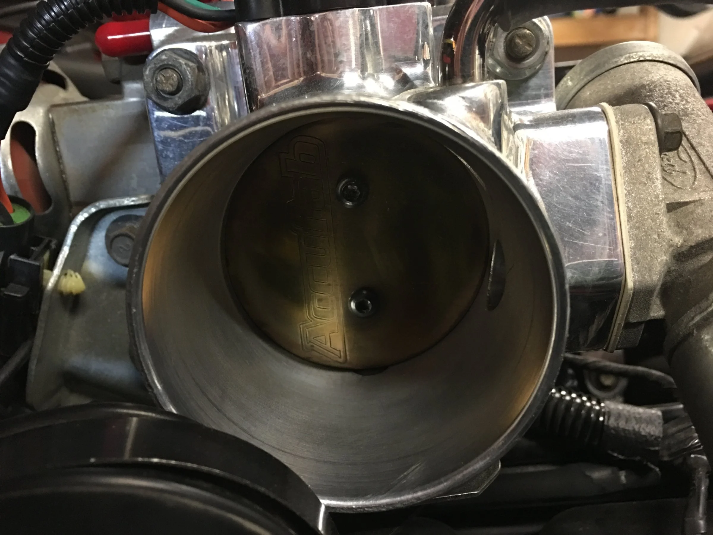

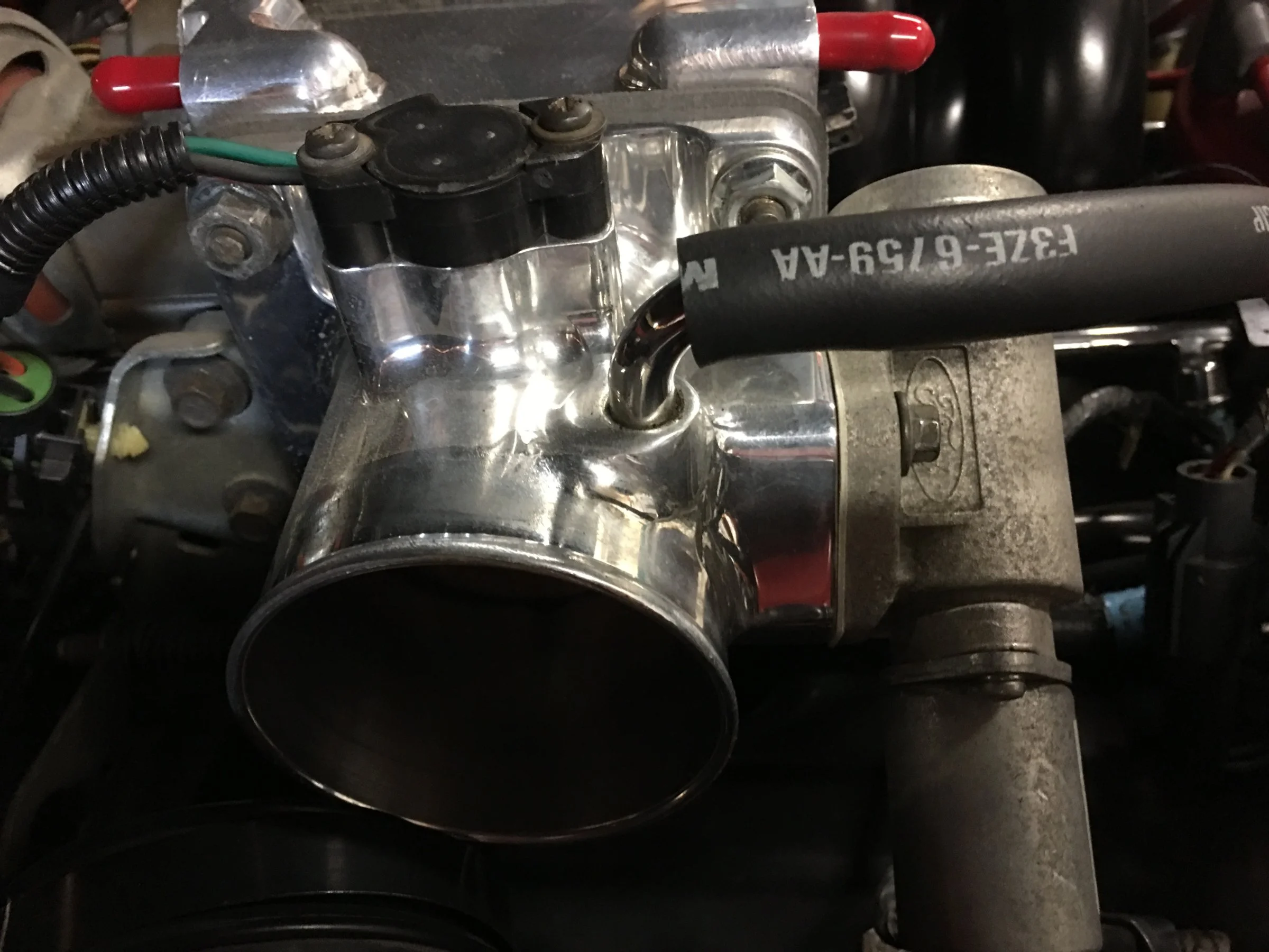

Found this on eBay
https://www.ebay.com/i/282851062144
I don’t have another throttle body to swap throttle shafts and these are already done. Look good or no?

Weld looks a little sloppy, but not exactly a great pic. Should get the job done though

Yeah I’ll ask the seller for some more photos if possible. Will just need a throttle body that looks decent enough until I can find the real thing. Were these just cast aluminum, no paint?

Sounds good. I gotta figure out what size this TB is, I see no markings of any kind on it to tell me what size. Gonna have to borrow some dial calipers to find out.

No go on the intake studs. The GT-40 tubular uses an separate EGR spacer that is integrated into the cobra upper. So bolt lengths are different.
Gasket can be reused provided you are able to remove it intact. They usually stick and tear. Felpro 61082 will work with the 65mm TB.
