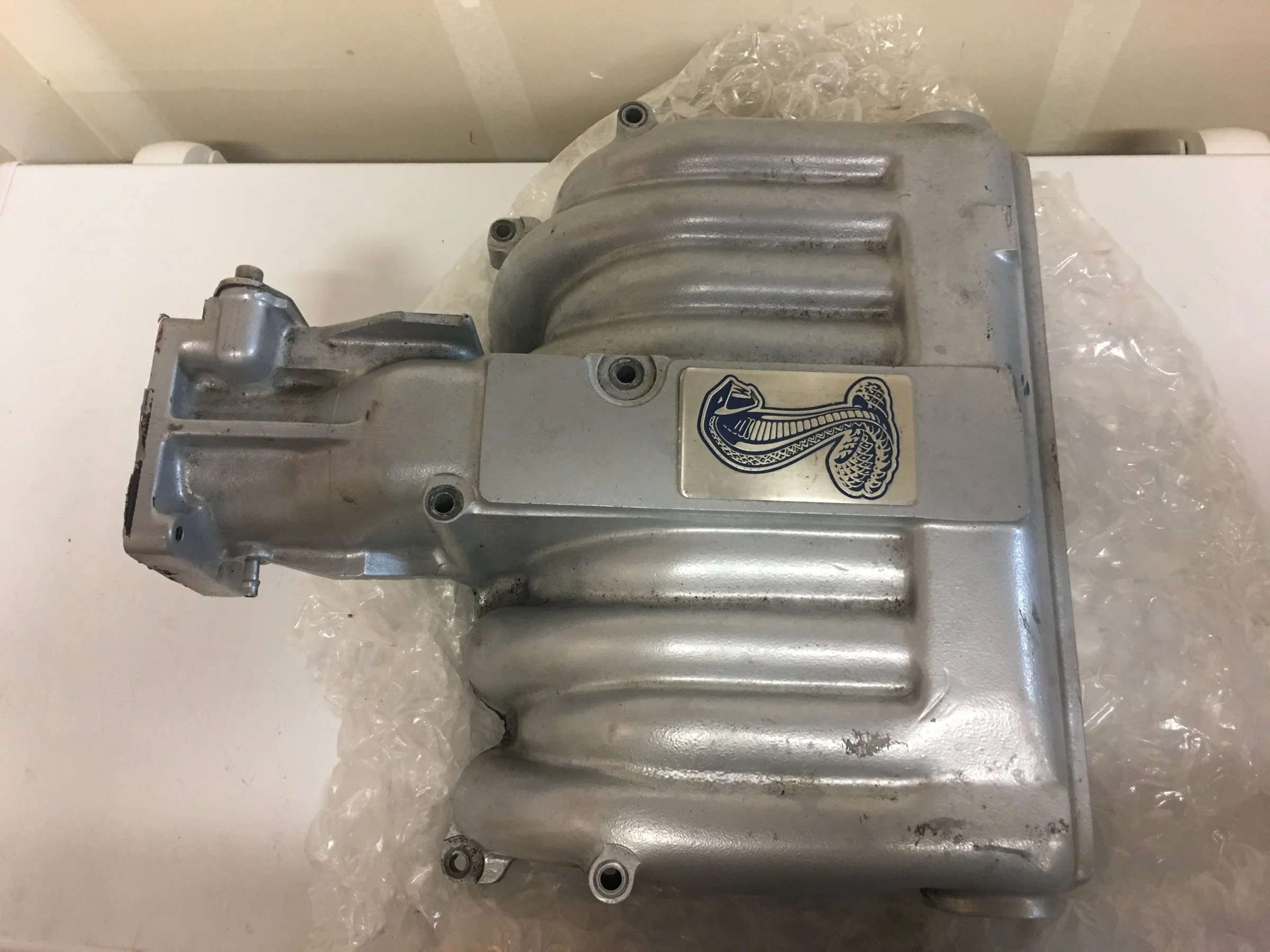

Gotta give it up for @karthief for his tape skills. I think the tape job may have survived a nuclear blast.
I hope I can get that Cobra plaque off ok, would make for cool wall or toolbox art!

That a 96-98 cobra plaque?

I think so.

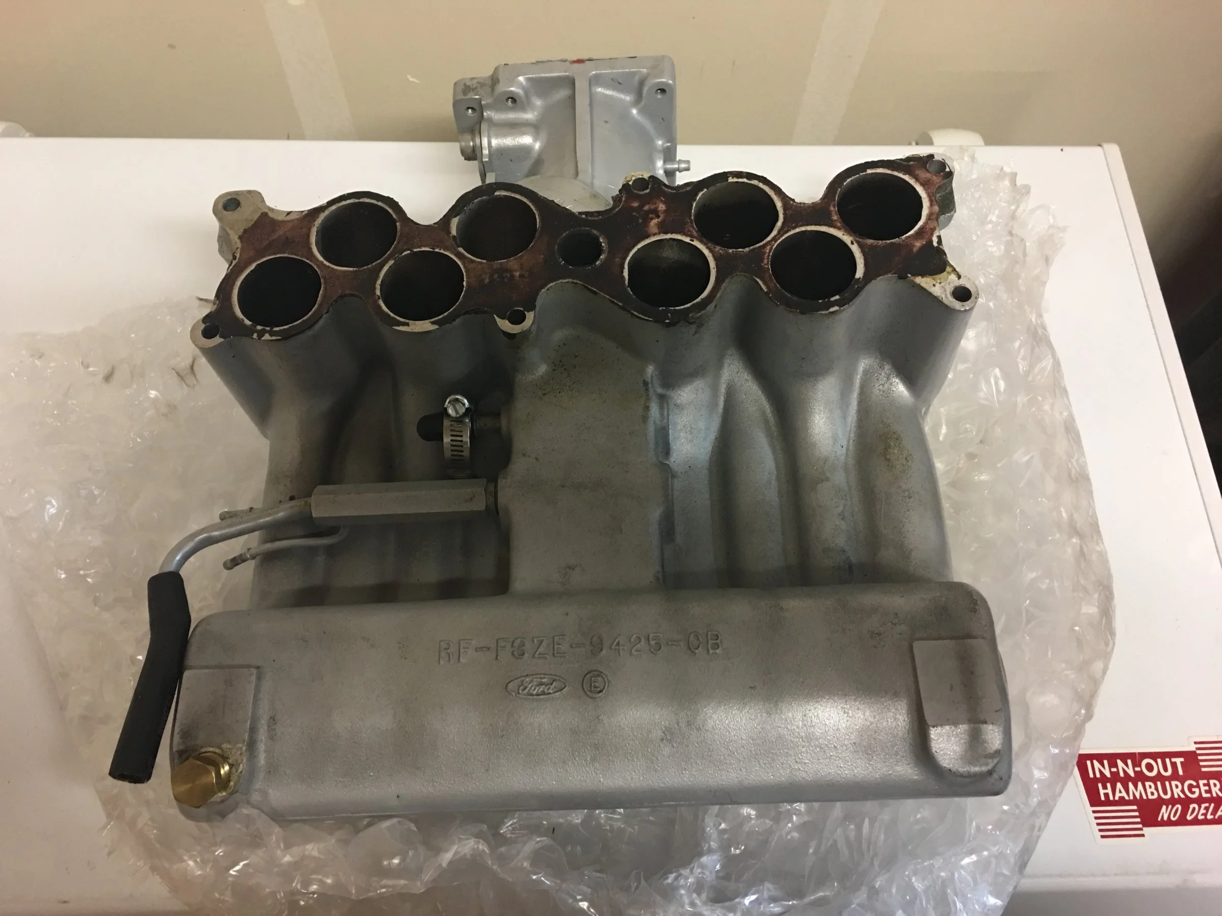

Seeing the intake in person makes the routing easier for me to understand. I’m more of a hands on person really.
When I get this blasted and coated, should I take all the fittings off or should they be colored the same?

I'd take them off and install after.
Be careful about getting blasting media inside the intake had a friend lose a new motor that way

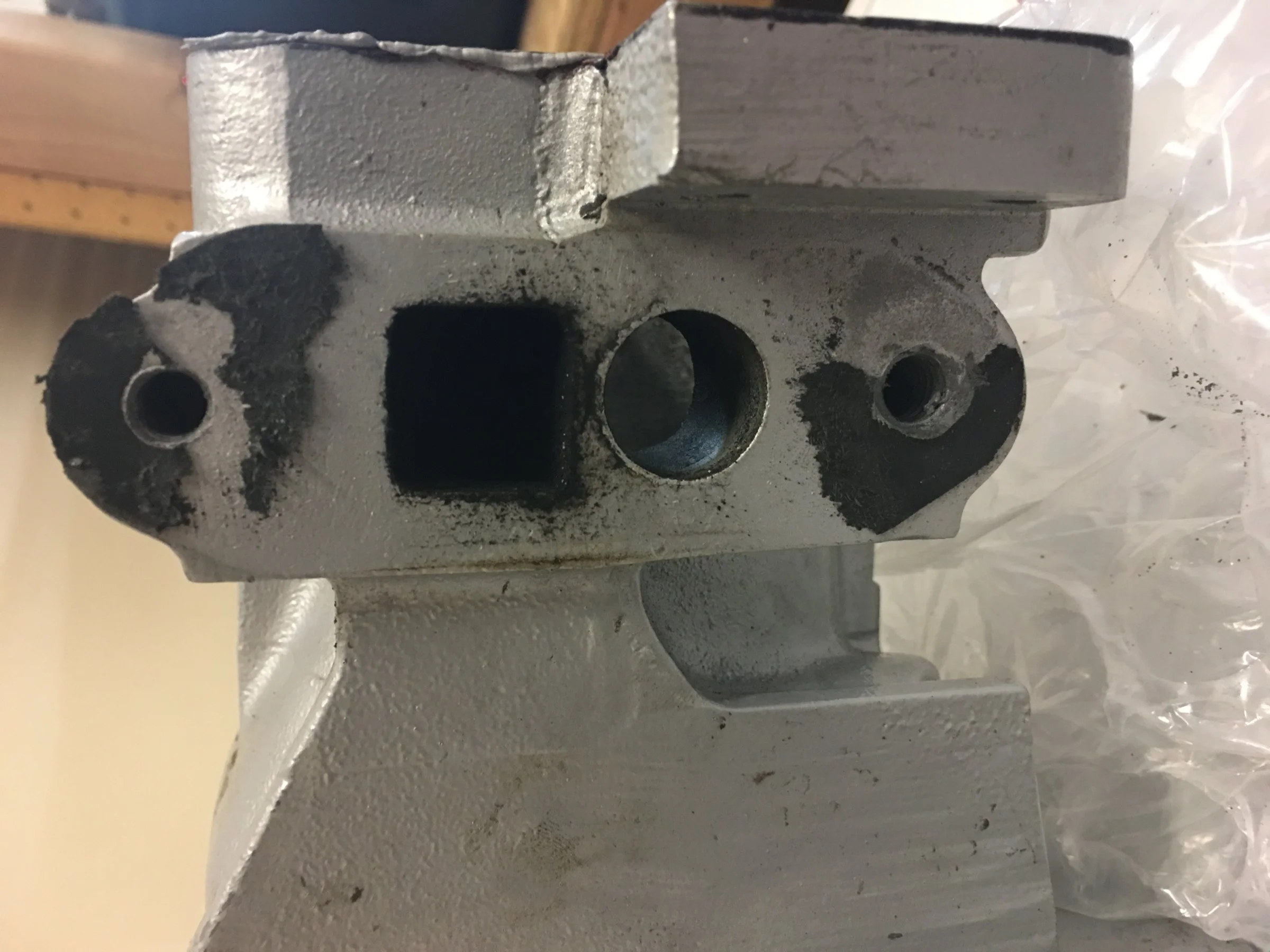

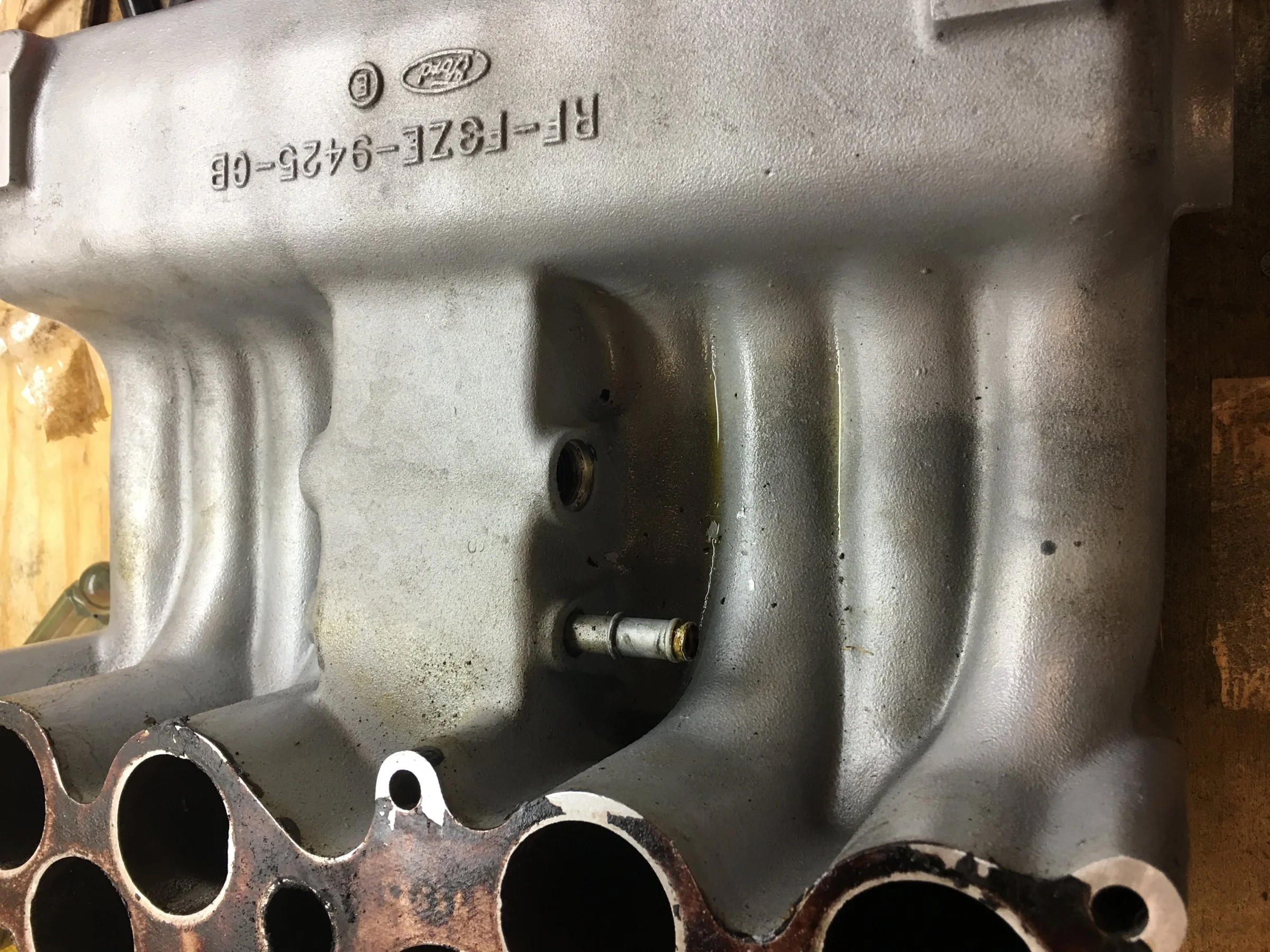

Are the two holes for mounting the EGR valve supposed to be different sizes? Bottom one is bigger.
The vacuum fitting on the bottom doesn’t want to come off, I’m sure it’s never been off. Any reason not to put heat to it or is it a no no with all that oil in there?

Yes, they are two different sizes.
I'd hit with some penetrating fluid and head to bed and deal with it tomorrow.
If you do try heat...do it outdoors. I doubt the oil would catch fire thiugh

Got the vacuum fitting off. Some PB Blaster and a big crescent (affectionately known as the all threads at work) it came off.

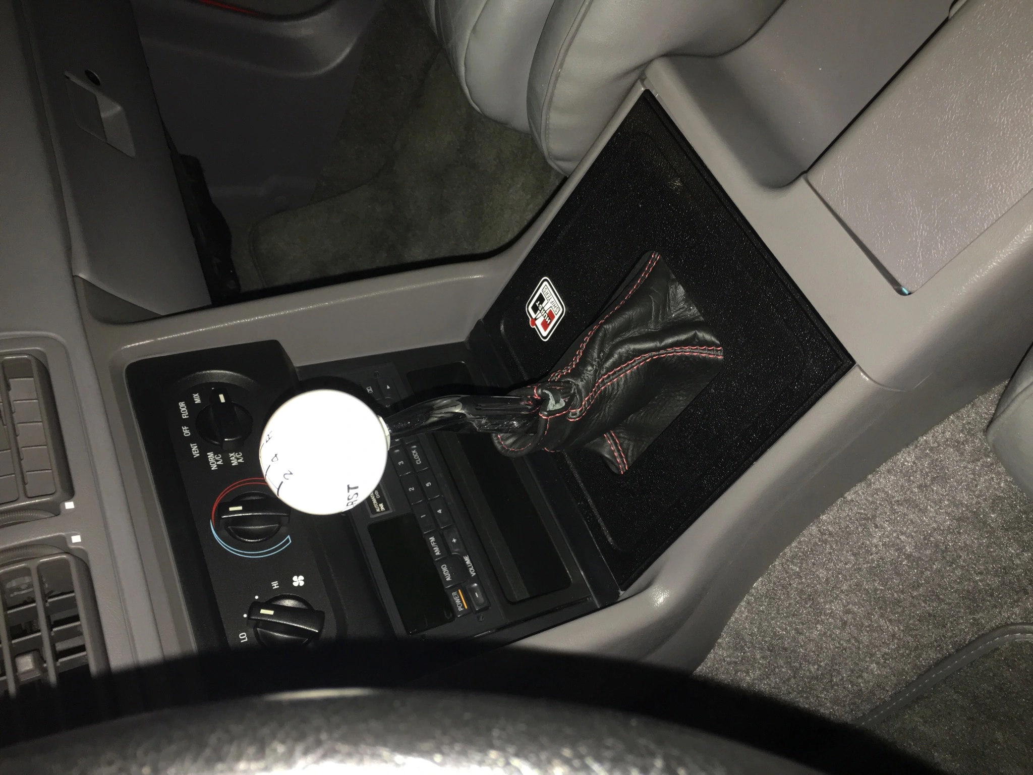

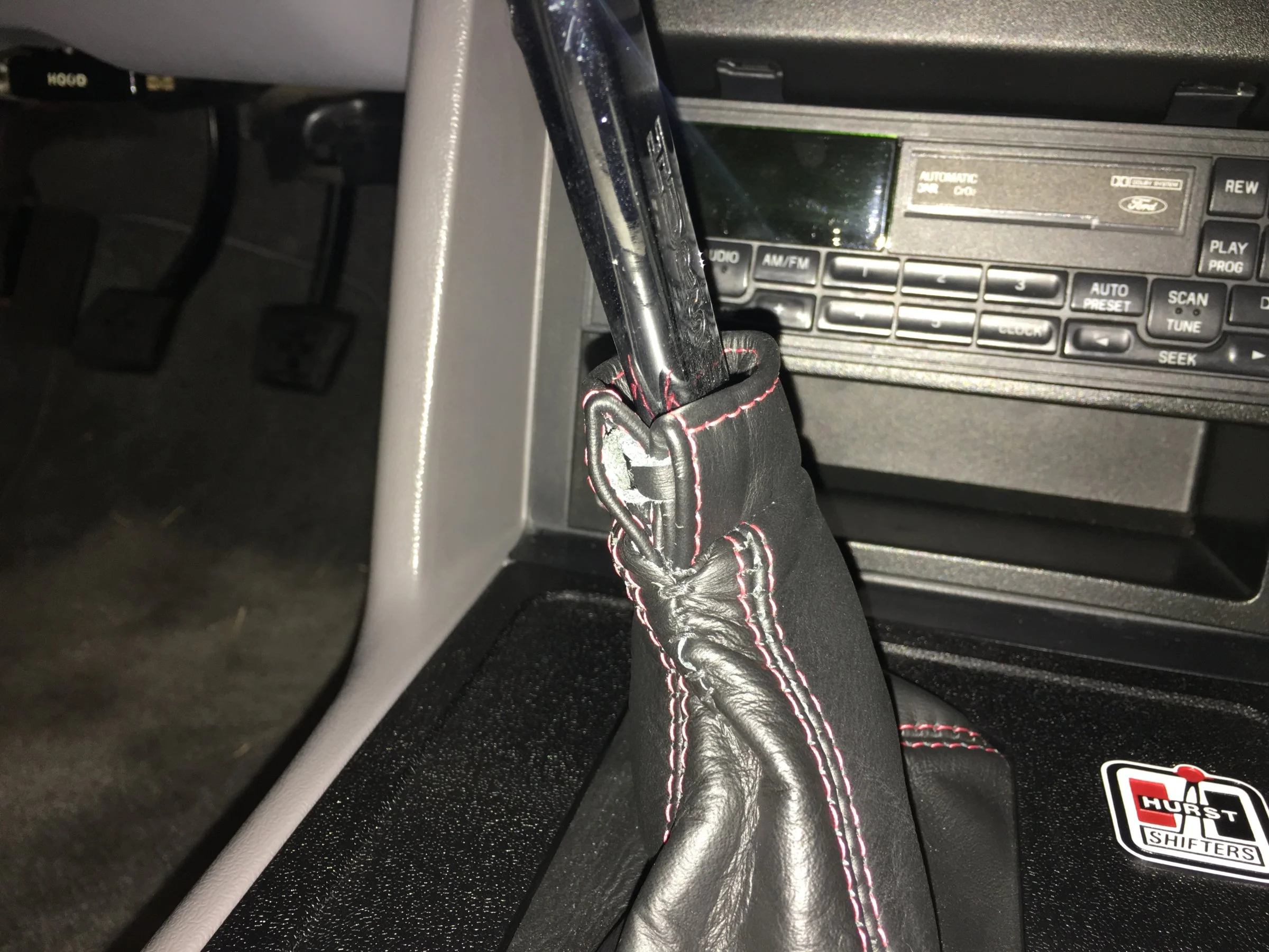

The colors of the boot don’t bug me, it’s the fitment and finish in the top. Although I’d rather have it look like Mustang5L5 shift boot, nice and deep black.
I’m assuming a stock shift bezel would still work with the hurst shifter?
