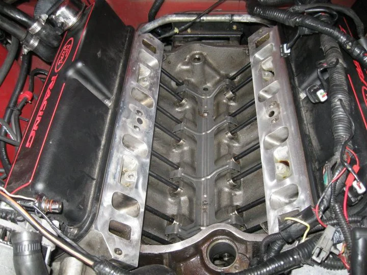

My TFSR intake was leaking ever since It was put on the car. I finally got fed up with it and replaced it with a Victor 5.8. The car has not been driven much with this new intake on until tues when I got it back from having the clutch installed. Since tuesday Ive put 335 miles on it breaking in the clutch and today I smelled what I thought was burning oil. When I got home I stuck it in the garage and after about 30 mins there was two oil spots on the floor. One was about the size of a half dollar and the other the size of a quarter.
The leak is not as bad as it was before but its the fact that its still leaking and its coming from the exact same spot as when the TFSR was on it. The TFSR was redone 4 times and leaked after everytime and now the Victor is leaking although not nearly as much. What can be causing this issue? Its obviously not the intake its self. Its leaking on the very back corner of the passenger side.
It never leaked w/ the Cobra intake that came on the car when I bought it. Ever since then Ive had lower intake leaking issues. The surface of the heads were spotless when the lower was installed again. Scraped them clean with a razor blade and went over it numerous times with Acetone

using a big black bead of RVT. I dont think its the Valve covers bc I can reach back where the RVT is on the back of the intake and feel oil there. Unless its moving over from the valve cover to the corner of the intake
I checked the valve covers on both sides, both had loose bolts and I tightned them up but I dont really think its coming from there. Under the bead of RVT you can see and feel oil on the block.
Do you think it should be redone w/ a gasket and RVT?
