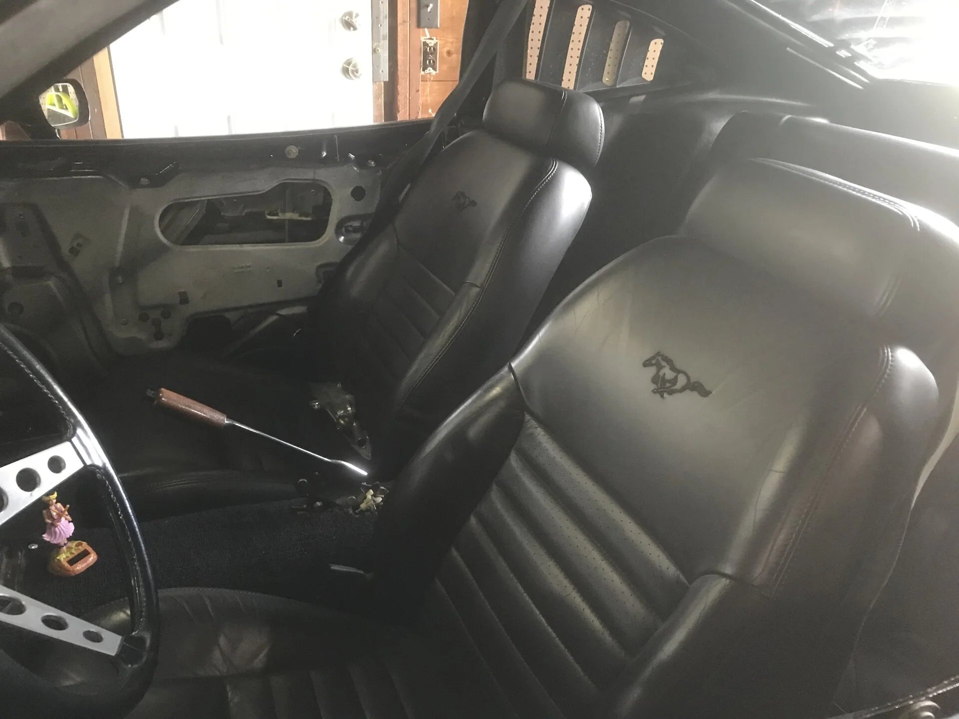

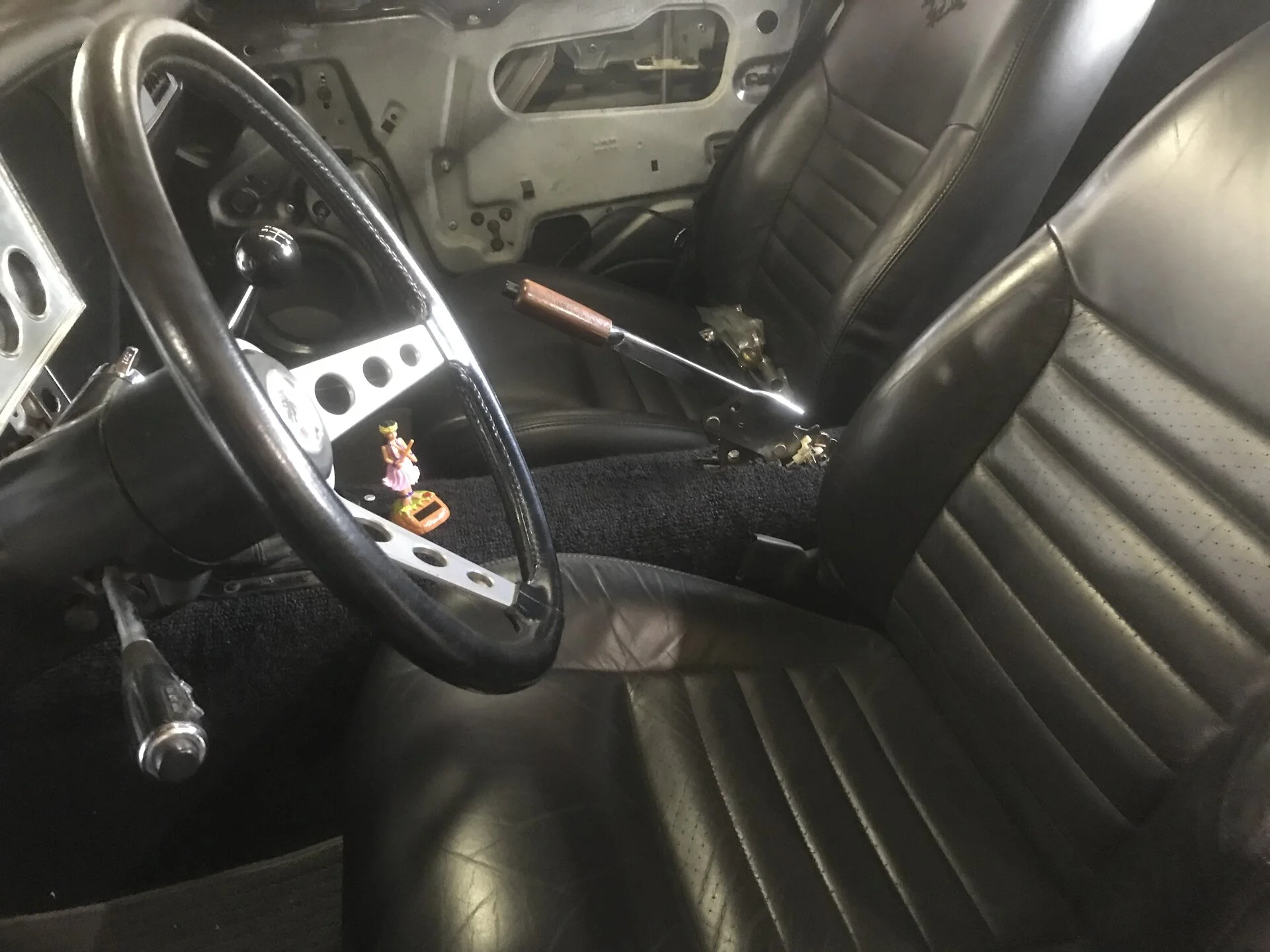

So I went to the local Pull-A-Part over the weekend looking for some parts for my girlfriend's Sequoia and picked up some 03 convertible seats for my Cobra. I'm copying @Enzio :D
I bought the seats on fleabay a long time ago. But they were out of a 03 mustang.

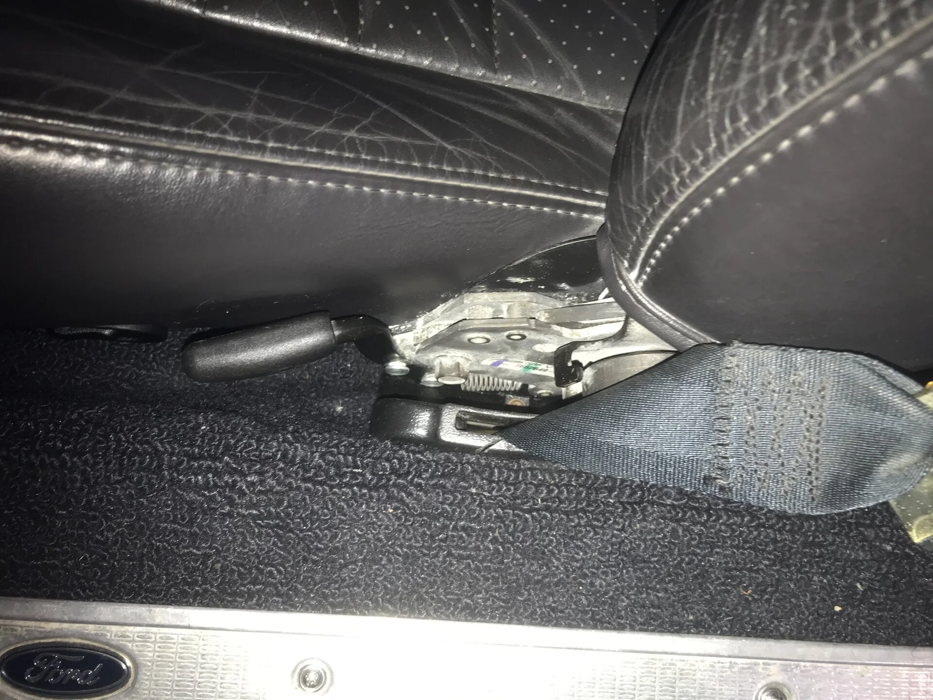

I just took the stock rails off the new seats and put my rails from the cobra on them. It's a tight fit but they work. I also had to remove the cover on the seat coil spring (helps assist the tilt of the seat back) to get them to fit. They're a little wider than the stock seats.
@extra_stout. Here's some pictures of the seats. The cover on the spring had to come off as there was not enough room with the lower seat belt retractor. IMG_3309.JPG IMG_3310.JPG IMG_3311.JPG IMG_3312.JPG
I don't have any pics of them. They're not in the best shape or anything, but the foam looked to be intact. The leather (or vinyl...? :shrug: ) is separating at the seams in a couple places and one of them has a hole that was punched through from some other junk laying on the floor, so they'll need recovered - which is fine. They're grey and my interior is black. I looked on LMR's site last night, couldn't believe the price for just the fronts! I paid less than that for the complete upholstery kit for my seats a few years ago! But as I think Enzio said, they're more supportive, so they're gonna be an upgrade. :nice:
It's been awhile since I did the up-grade but if I remember right; the drivers side foot well is slightly wider than the passenger side. (Motor is off center so I guess the rest of the chassis is also.) Thus, the passenger side will not slide forward or back due to the stupid seat belt double piece of crap retractors hitting the seat mechanism. I just put the passenger seat as far back as possible on the rails and bolted them down. Nobody has complained or even tried to adjust it yet. I tried to replace them with a single retractor last summer but couldn't get them to fit in the hole by the wing window. You'd then be able to adjust the passenger side I'm sure. I think I'll look at different vehicles next summer to see if I can get something to fit. Maybe a pick-up truck may have something that will work. Then fab up a good solid bracket for the hole in the quarter panel. Then replace the carpet...That turned into a big job! Never-mind. I'll just enjoy my ride.
