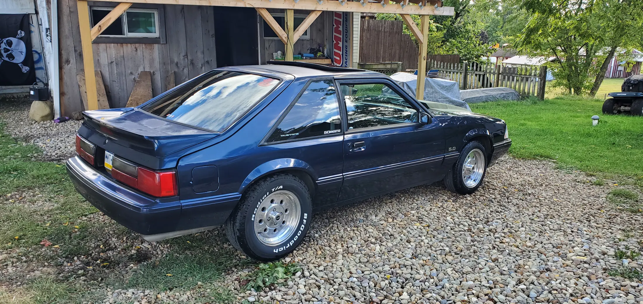

Thanks man. That's actually the side of my garage. Used to be a horse stable from late 1800s. Someone tore down the stable and used the wood to make a 2 car garage in 50s I believe. It's coming down next year for a pole building. Saving all of the wood though. Will incorporate it into my new building.

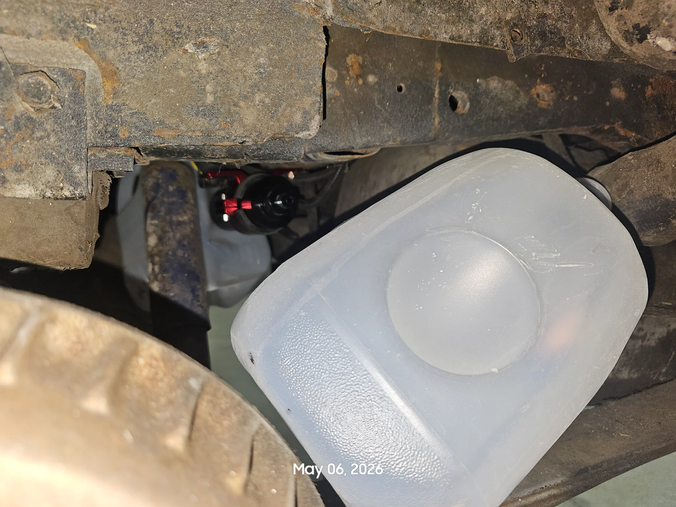

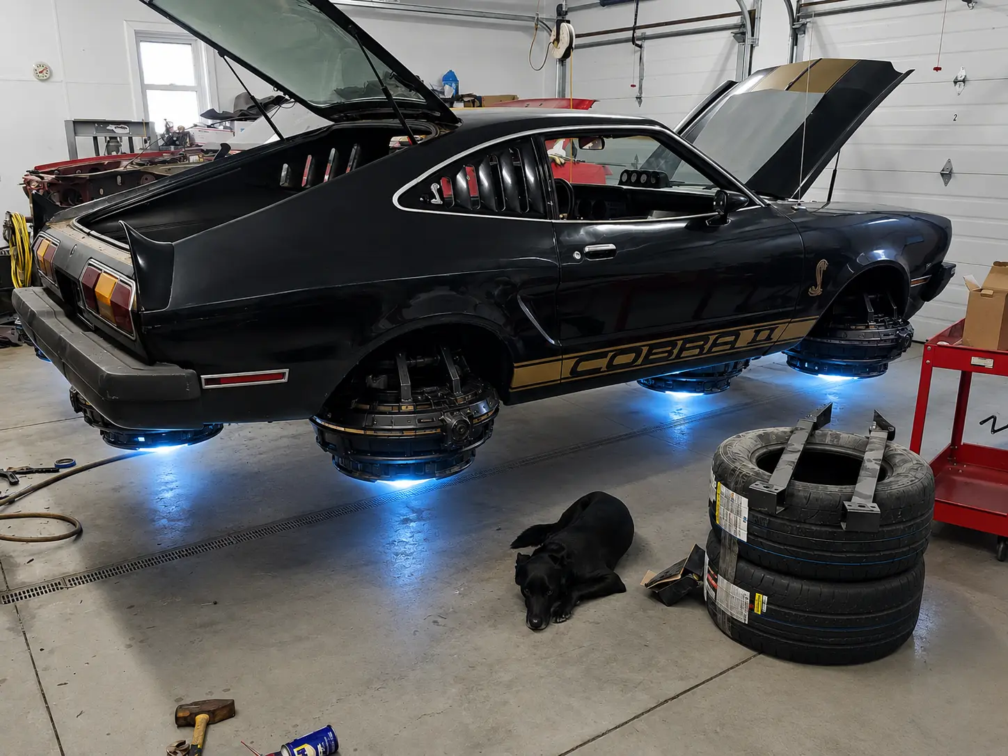

So.... I installed a new fuel filter tonight. Went to check for leaks and found that the pump's not priming. Checked my connections and didn't find anything weird, swapped the relay with another new one "just in case" and checked voltages. My battery is a tad low at 11.8 volts per the handheld and my gauge when checking connections. The pump is getting power when it should (I mean it should be, it ran yesterday!). I believe I have a junk pump on my hands now.... I'm running an Aeromotive Stealth 340, read a bunch of posts here and there of people running into the same issue. If it's not one thing it's another....
But on a positive note, the wheels came off easily with the new socket. Probably because I soaked them with WD40 while I waited. They took almost no effort, especially compared to the other day.

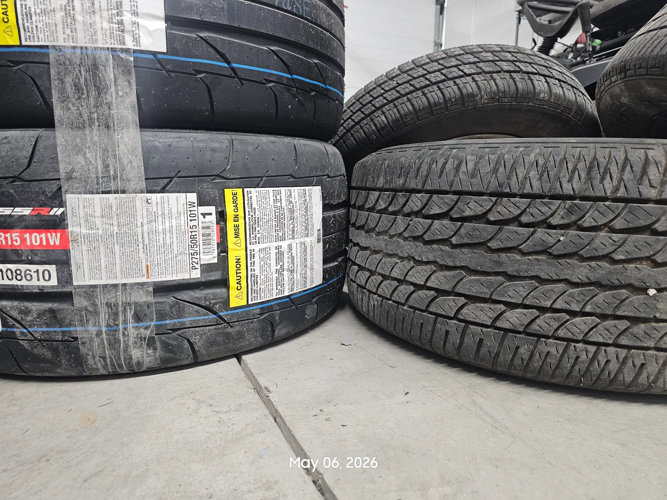

And a comparison between my old tires and the Nittos.

The Nittos look like they are going to hook. Nice looking shop foreman.
He's kinda sore atm. He got into it with another dog last week and broke his lower left canine tooth, so the vet extracted it Monday morning. So he's been laying down on the job quite a bit lately.

What size front wheel and tire are you running?
165/80-15 front, was 265/50-15 in the rear. Front is staying the same, going to 275/50-15 for the rear now.
Wheels are Summit branded knockoffs, 15×4 on the front, 15x8 with 4-1/2 backspacing for the rear.

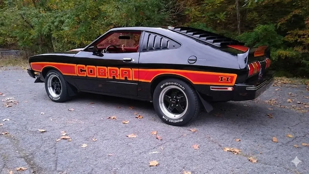

Here's when I put them all on. They're about 16 years old now. Definitely time to replace them!
Thanks. I have 155/80-15 on 4" on front and wouldn't mind getting a little wider tire on it. Per Grok, yours should be 0.39 inches wider than mine and 0.63 inches taller. As a do over I wouldn't have went with the 4" front but they no longer make my wheel in 5.5 or 6" I'd prefer. Wheels cost $$$ these days so I guess what I have is good enough.

Your car is more or less stock height in front, right? Mine is low, I cut about a coil and a quarter to a coil and a half from the springs. Sitting as low as it does required me to eliminate the fender liners and bend the spot welded seam at the firewall otherwise my tires would rub. The fender lip was fine, so I lucked out there. You may be fine if you're sitting about stock height, but if it's lowered you'll definitely want to check clearances.

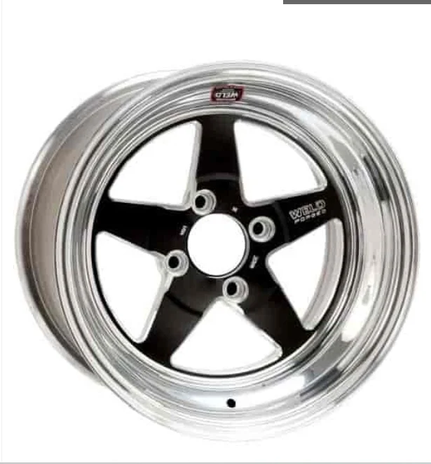

When the Weld RT-S Series S71 first came out, they were really reasonably priced, looked great and they could be had in 4 lug but I just couldn't get pass the weirdness of four lugs on a five star wheel and changing over to five lug would add more money. The Centerlines are the third set of wheels so I will live with them. I still have the 13" slots that I actually liked the looks if they were 15".
BTW- the Welds were under $200 (IIRC) when they came out and the 15 x 4" is now $765!!!
https://www.jegs.com/i/Weld-Racing/927/71LB-504P25C/10002/-1

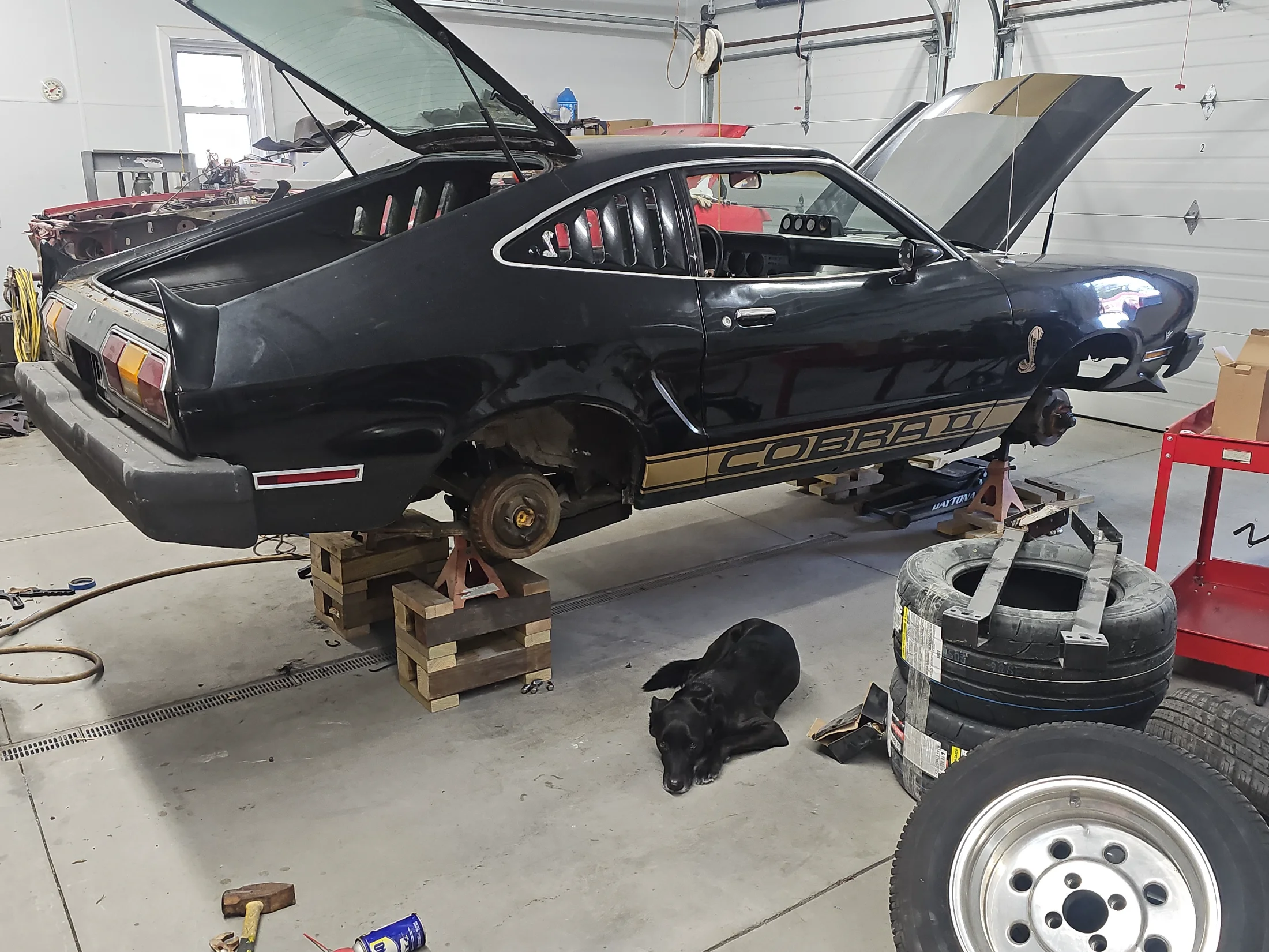

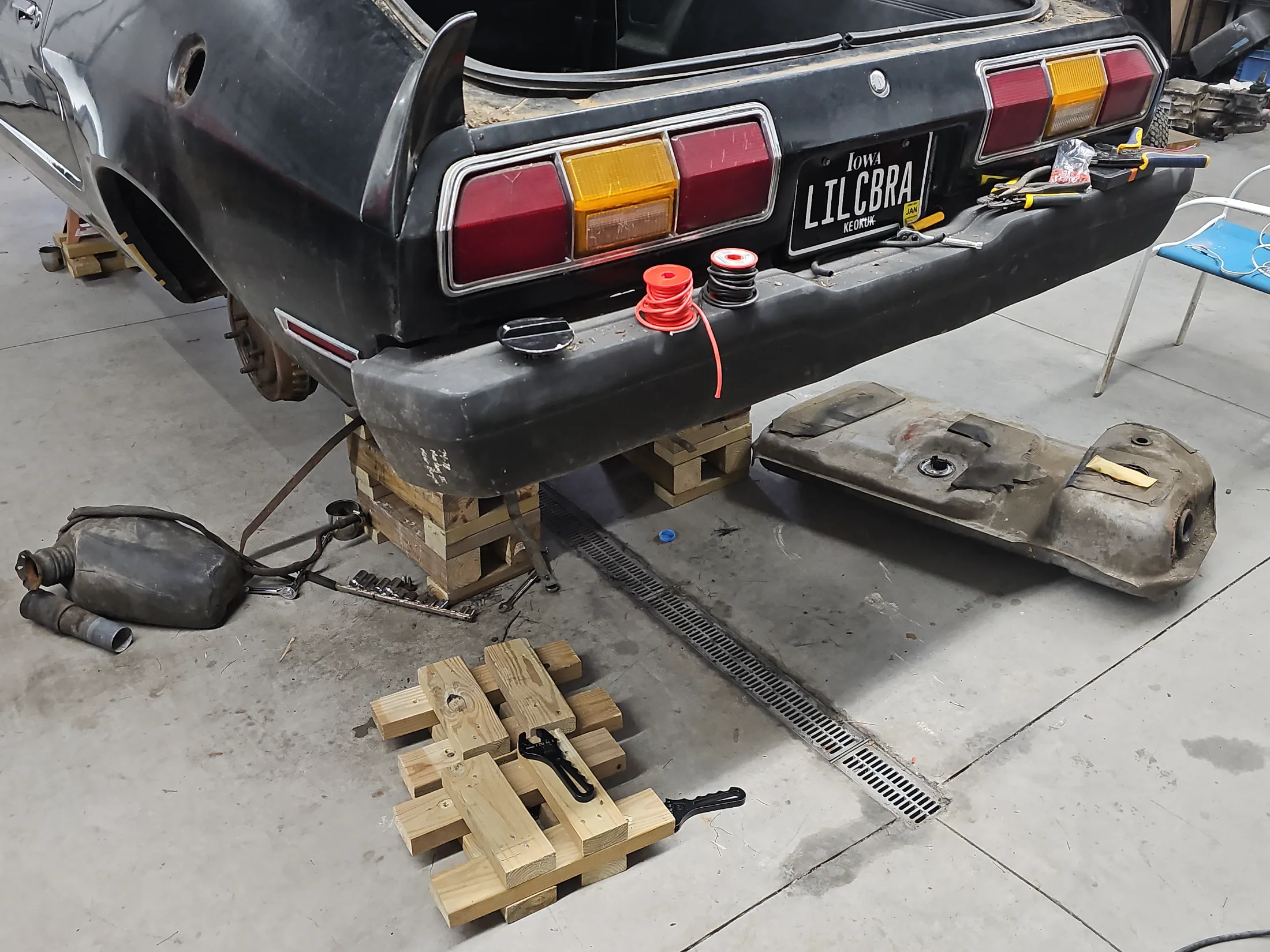

I started the night off bleeding the master cylinder, so that's now ready to install. Then it was back to the fuel system. The good news: it runs again! But - I pulled the tank and fuel pump and in the process found that a wire came out of a connector as I went to pull it apart.
That led me to bench test the pump, it's still good. So back in it went with an improved connector. The connector I'm referring to was an automotive weather tight connector that I assembled when I did the swap. The thought was to make dropping the tank easier - I could disconnect the electrical at that connector and all I'd really need to worry about disconnecting was the return line. The wire broke at the terminal and the insulation looked burnt, so I replaced both wires with 10 gauge and reinstalled it all again.
Next up was the passenger side wheel cylinder. That's now been replaced, but not without a fight from the springs....
