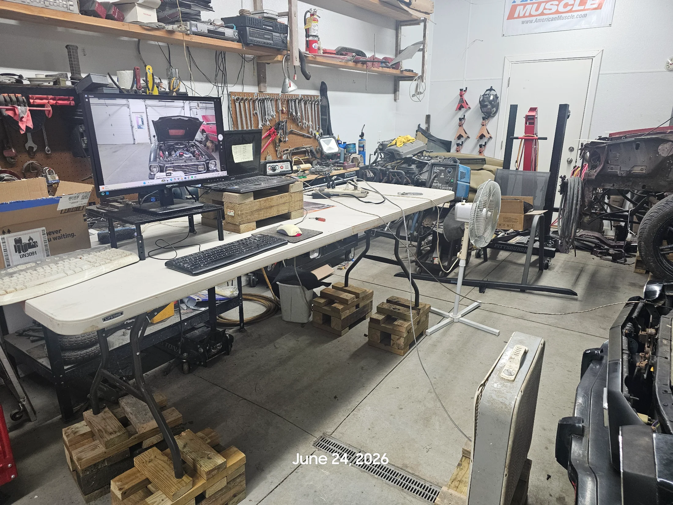

Tomorrow's the day! Doublechecked my fuel pressure and confirmed and reset my IAC and TPS to make sure that that's been taken care of before I'm online with him. Then I moved my laptop out to the garage and got it set up. I'm sure I'll need something more, but at least that stuff is done and out of the way.

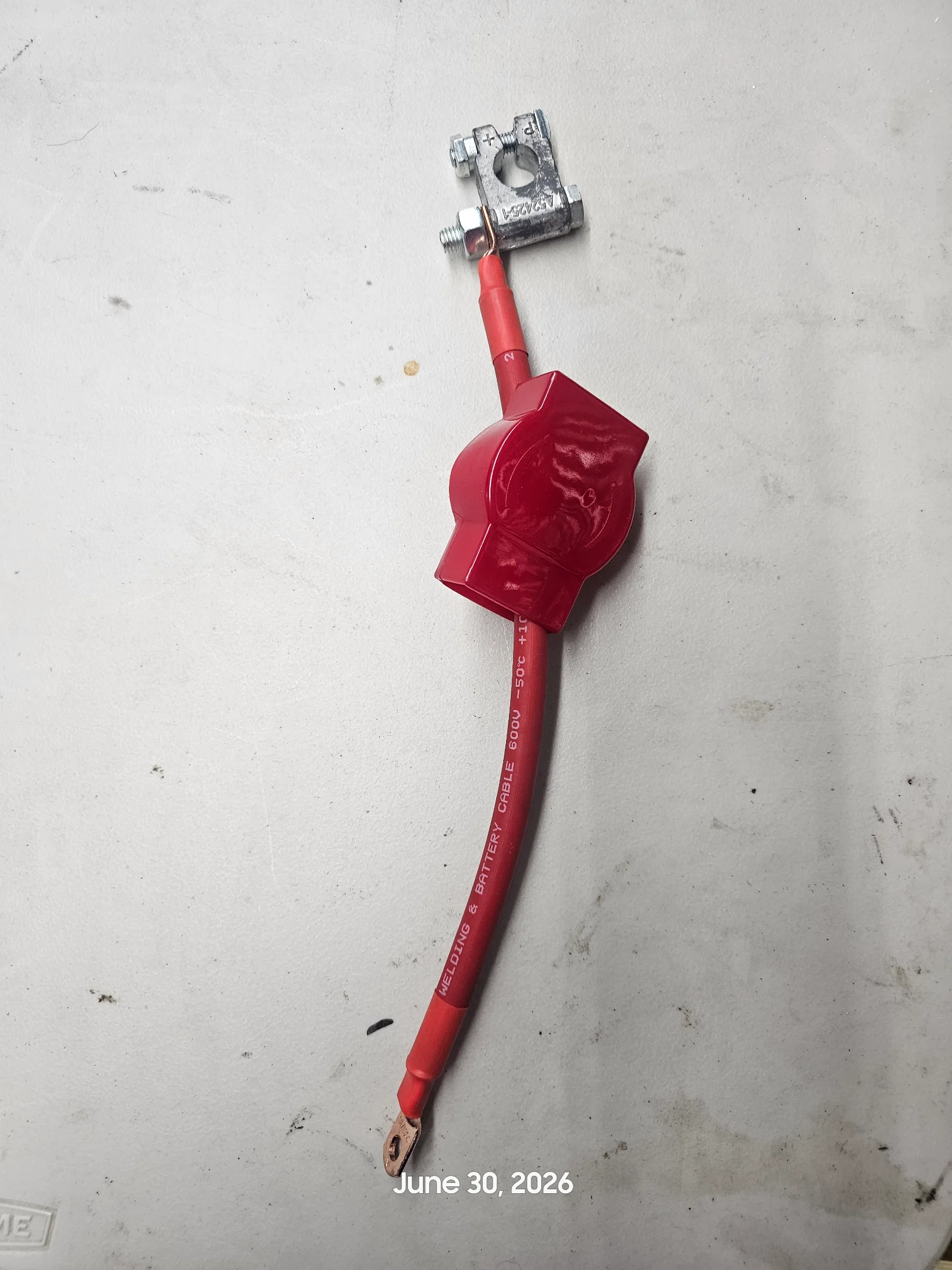

I'm still waiting on the new Megafuses I ordered, but everything else arrived today. I installed rivnuts in place of the self tapping screws for the starter solenoid and made new 2 gauge battery cables. The ground side is installed and the alternator side is hooked up, otherwise everything else is mocked in place until the fuses arrive. I would like to think that this would eliminate any voltage problems I may have....

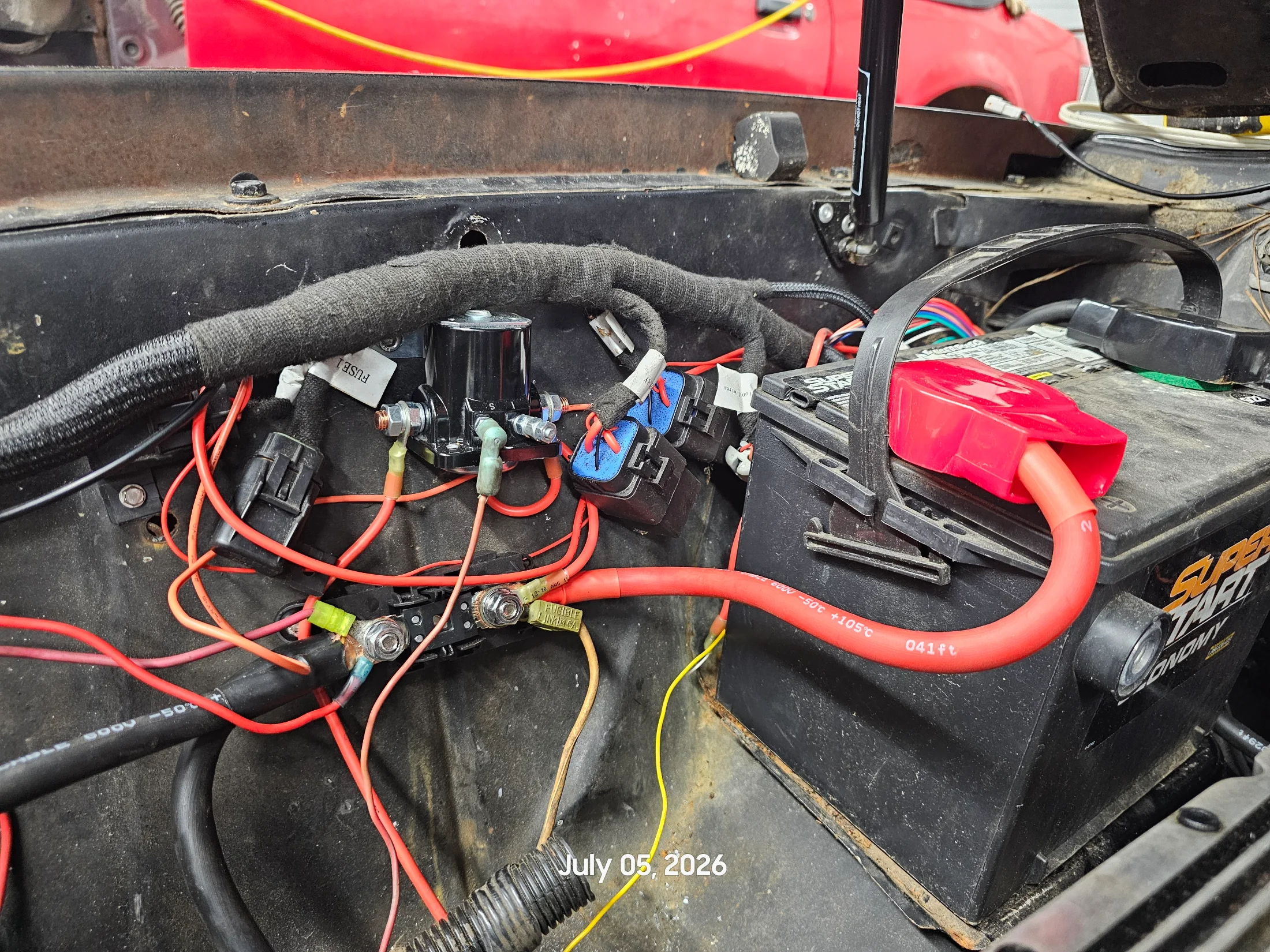

I got home earlier this evening, took a nap for a few hours, then out to the garage to get the wiring buttoned up. The starter is still just hooked up without being bolted in. But once I finished connecting everything back up the starter engaged like it's supposed to. So, later today, I'll reinstall the starter, bolt the rack and pinion back up and give it a whirl. It had better start this time! I'm sure it will - after that I'll be sending an email off to Bryant at Nomadic Dyno to get that remote tune taken care of.
My wiring isn't the prettiest - I don't think it ever was - but I'm thinking that I'll be doing something with that over the winter, as well as a few other things. I'm probably being overly optimistic about what I'll get done as the list just seems to keep growing.
