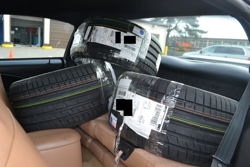

Well, I finally got rid of the noise. What was causing it?
MY TIRES. o_O
The front ones to be exact. Way back when I bought my wheels, I had no idea that they had a larger center bore than the factory wheels and needed to be run with hub-centric rings to balance correctly. I didn't figure this out for a while. I evidently drove on them long enough to cup the front tires pretty badly (You could see the abnormal wear very easily). I bought a new set of tires (that only took a week to arrive) that were installed today. The noise is gone. I feel relieved and stupid at the same time.
A backseat (and trunk) full of tires.
They're Continental Extreme Contact DW. Car and Driver reported that they're one of the most predictable and best handling tires in the wet, which is why I went with them. It rains a lot over here, so the top priority was a tire that wouldn't put me into a ditch when it's misting out.
