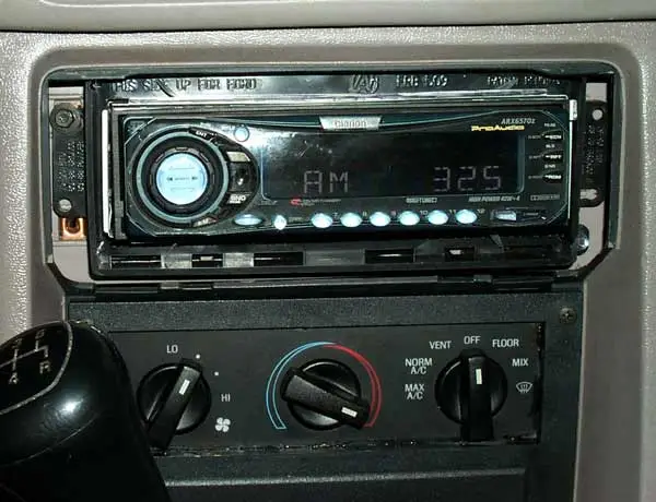

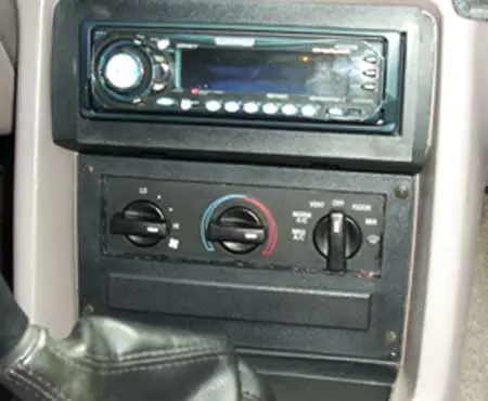

After many questions I have finally managed to get these
posted: :flag:

I cut the climate control cover with a dremel to make it square. Then used a universal stereo install kit for a face plate to cover up the round edges that still showed.
As for cleaning up...those picts are a year old taken after finishing it...I have since cleaned it up. Takes about 2 hours and a dremel. You need to cut the mounting bracket from the Climate panel and then glue it to the original radio bezel. The major PITA is connecting the vac lines since they do not stretch very much. Small hands come in hany...drag the wife/girlfriend/hot neighbor out to help with that part :)
not to bad dude, i did have the idea of adding the indash flip out DVD unit. and yeah now that i took notice the dan thing would hit the shifter. bah looks liek i may be tryen that sometime next year as well dude. very nice
