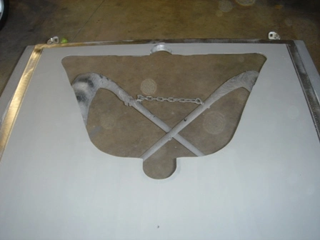

While the car is off at the alum fabricator, Wayne has been working on the hood “bulge”.
Here we have photos of the stock hood with the cutout for engine clearance....

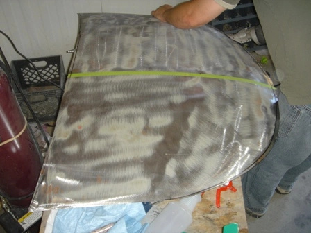

Wayne creating the “bulge” by trimming the 03 Cobra roof to the desired shape....
