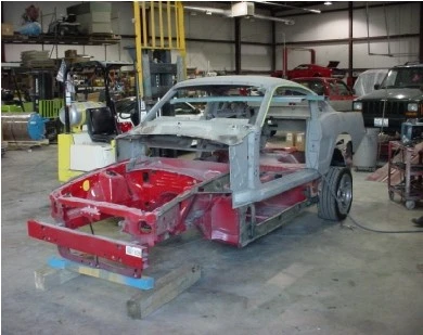

Hi All,
7-25 update part one…
A lot has transpired since our last real update.
Wayne has been meticulously plodding through all the remaining bodywork. He has spent what seams like endless hours working and reworking everything from the cowl to the rear bumper. He constantly has to point out the reasons to me. A little wave here, a little ripple there, this doesn’t line up quite right, changes to the door effect the contour of the quarter, the body lines that run along the edge of the roof to the trunk are not quite symmetrical, and on and on.
attachment.php
Wayne had to get the doors finished and installed in order to send the car out to the aluminum fabricator. Originally, we were going to have him come to our shop, but he convinced us that he needed the car at his facility to do the job right. The job is to fab up the trim panels that will seal off the top and sides of the dashboard.
I, on the other hand, have been working on mechanical details. The hood latch is almost complete. I am going to remove all the extra material at the back of the bracket after I fit up the front end, grill, hood, etc… I also have located the shock tower brace. I will be able to complete the fabrication of that item after I install the ductwork for the air inlet. I have the welding of the ductwork complete. We just have to have the parts painted to match the blower. We felt that if the paint matches the rest of the engine intake system, it would look like it was supplied by the factory. (see image #2)
attachment.php
I also replaced the lower control arms with the shorter FOX items. You can see the difference in length in the photo below. This solved all the problems with the front wheel / flare clearance issues. We did have to flip flop the caster plates in order to get the correct front end geometry, but other than that, everything went quite well.
attachment.php
While the car is out of our shop, Wayne will be working on the hood. Here is the prelim layout for the bulge.
attachment.php
Here you can see the relief’s we had to cut for under hood clearance.
attachment.php
Continued in part two....
