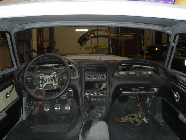

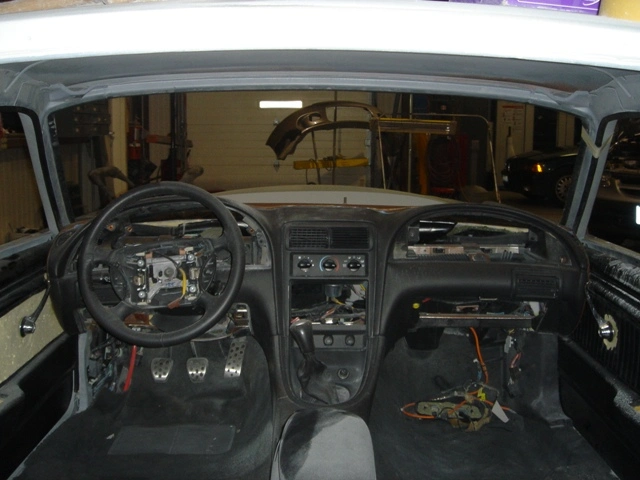

The dash panel looks really good, but while I was looking at the pictures, something hit me. Are you going to be able to use the heater defrost with that panel installed? It looks like it wll cover up the vent locations. Are you going to cut holes in the panel for these? Just wondering. It is lookng good!
Hi 65,
Yes weare going to open up the dash panel for the defroster vents. The ductwork already comes within about 1/2" of the panel. We just have to locate the holes and add a gasket.

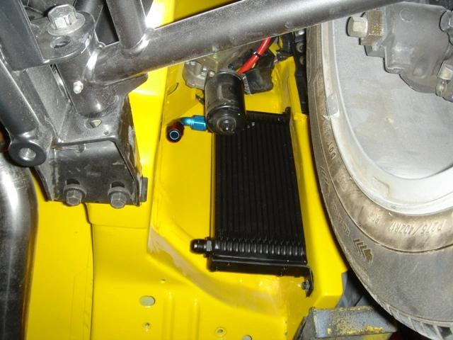

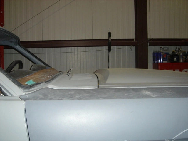

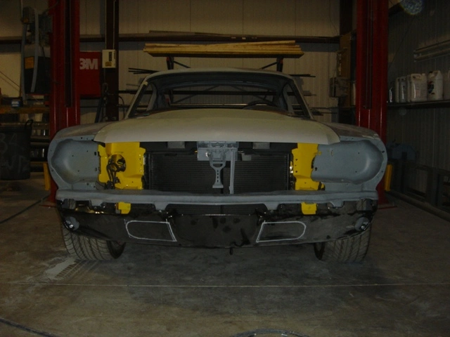

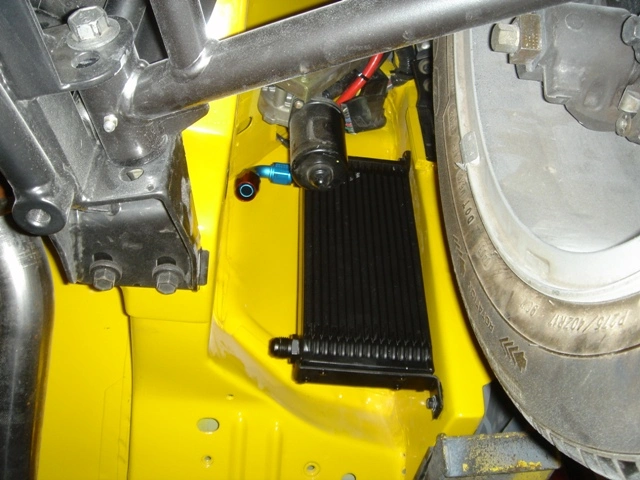

Hi All,

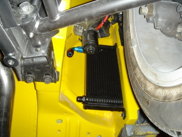

Yesterday things went pretty slow. We didn't receive the fittings for the oil cooler / filter relocation kit until the afternoon. That only gave me enough time to mount the oil cooler. I now have to mount the filter relocation housing. I can easily mount the housing, but running the lines is going to be a bit problematic in that the fittings I have to use take up quite a bit of real-estate. I think I have things figured out, but I thought I would review the installation with Wayne and the guys in the shop before I drilled the mounting holes.
Here is a photo of the installed cooler. We were trying to decide if we need a shield to protect it from rocks thrown off the front wheel. We are going to debate this one a bit before we

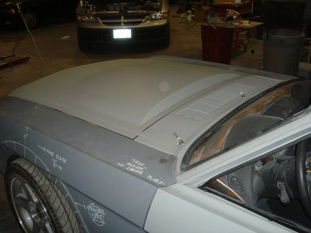

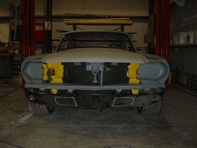

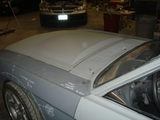

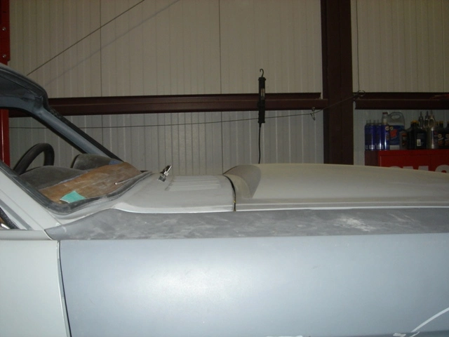

Wayne got the fenders and hood mounted. And, as with everything else, he had to do some fine tuning for fit and clearance. The passenger side fender will need some modification to achieve the proper gap at the hood. We also had to modify the caster camber plate setup to gain a little bit more clearance between the strut shaft and hood. Here are some photos of the hood from a couple different angles

I kinda like how the front air ducts mimic the shape of the '03 Cobra fog lights. You might look at some more pics and tweak that some more as well.
I like the hood, but my personal preference would still have been to put the '03 Cobra hood fake "cheesegrater" air extractor in the center of it.
Are the windshield wipers going to stick waaayyyy out off the cowl?
IMO, it's not a good idea to mount the oil cooler there. Besides the road debris damage issue, it won't get much airflow through it. You want that puppy where it can get plenty of cool airflow so it can do its job. One piece of gravel thrown up from the tire and you could very easily puncture a tube, and then you're taking a tow truck home. Adding a shield would restrict the airflow even more.
debris shield as scoop?
I can't tell if that is on top of the wheel, but it looks forward or back of the wheel. If it is forward or on top, you *might* be able to make a piece of aluminum or other material work as a duct to catch air and direct it to flow over the oil cooler. If it's behind the wheel I don't know how you'd do that without also catching debris and sending it shooting up and around your wheelwell like some crazy pinball machine . . .
Hi Reen,
We struggled long and hard over this one. After some conversations with "cooling specialists" we decided not to locate the oil cooler in front of the radiator as you would normally expect. A number of factors impacted our decision, but they all added up to one issue. We did not want to put any additional strain on the cooling system.
The "specialists" said that it would even be better to locate this cooler horizontally under the car than to locate it in front of the radiator. They said that the typical in front of the radiator installation would be adequate if we kept the drive-train "stock" 03 Cobra, but if we are looking at upping the HP, we should find an alternate location.
We are thinking of adding a heavy mesh screen (spaced at about 1/2") to keep debris away from the cooler without restricting air flow to much. If (after initial testing) we feel we are not getting enough air flow, we can always add a small fan.
We can test our theory with two temp sensors (one before the cooler and one after). We can measure the temp drop across the cooler in a number of different driving situations. If we are not getting good results, we can then add a fan.
This all kind of makes sense to me, but then again, I may be missing something. Do you think our plan valid???
I know you weren't asking me, but that's never stopped me before...LOL.
I think that the cooler WILL cool no matter where you put it, even if there is almost no airflow. They can act as a simple heat-sink in dead air.
I think your plan for the screen should prevent normal road debris from puncturing it. It is not like they are safe out in front of or under a car either ya know :D
I think the fan may help, but adding a little spacer (say one inch or so) to get it away from the sheet metal would help a great deal too.
Keep up the good work and of course the updates :flag:
SN65 said:
Hi Reen,
Bob-
I certainly understand trying to fit 10 lb. of "stuff" into a 5 lb. bag and the packaging challenges this brings. I tend to be conservative about reliability issues, and something inside me just wouldn't put the oil cooler inside the "pinball machine" like that. Even if it doesn't get damaged, it's not going to get good flow.
I'd sooner put it in front of the radiator and condenser and if there's a problem get one of the many upgraded radiators out there.
1/2" - 3/4" airspace between it and the rad should be sufficient to minimize heat exchanging from one to the next, if that is your concern. Besides, if you believe the 1/3 quart of oil in the cooler will overheat the rad then just think what the other 5 or 6 quarts are doing to the motor!
On the other hand, how well do you think the car will stop from 60 MPH with oil soaked tires on one side of the car after a lug nut picked up off the road goes sailing through the cooler?
Didn´t you mount that cooler in the area where you had thought about putting the extractor vents on the fender? I´m with Edbert and Reen, how much of a strain can that oil cooler put on the cooling system? Are you using the stock radiator?
I'm not a mechanical engineer. But I do know a little bit about heat and from what I know, I can't see placing that behind or infront of the radiator as losing efficiency of cooling as much as the lack of airflow in the location you selected will lose cooling efficiency. Remember, air is striking the radiator very quickly, the length of time which air is contacting the fins is fleeting. It shouldn't hurt it to much, especially with electric fans.
Even if the efficiency did go down the toilet (it won't), it would still be better than the high risk of a good rock strike taking out that oil cooler. And to give you an idea, of what I'm talking about, the oil coolers on a Cobra (the helicopter, not the car) are protected by a farely sturdy wire mesh which is perpendicular to the plane of the oil cooler and a fair distance away, because if a rock or anything hits that mesh at a speed high enough to damage the cooler it'll probably poke a hole in that wire mesh too. So that's a small criticism of your wiremesh plan.
SN65 said:
Hi Reen,
reenmachine said:
Bob-
I think you've made very, very good judgment calls up until now regarding this project, but can you really argue with the points being made in the last few posts? I thought the same thing as Reen when I initially saw where you intended to place the oil cooler, but I said nothing in deference to you and your team, who are obviously more skilled than I. That being said, I have now seen a pretty solid consensus of knowledgable people give good arguments as to why you should steer you away from where you want to mount the oil-cooler. I know you want to be done with this car in a bad way, and I can understand that. Please, though, keep an open mind and an open ear to suggestions like this. As pointed out already, this could be a very detrimental mistake. :notnice:
With all that's gone into this ride, I'm sure you can upgrade the radiator. :nice:
