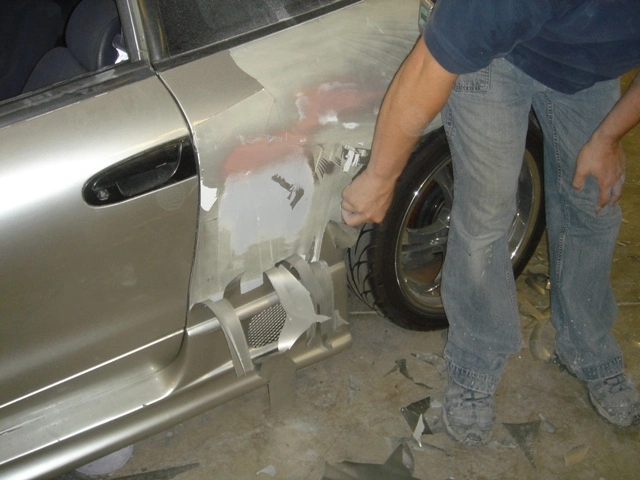

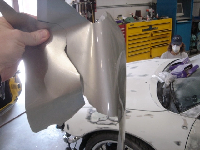

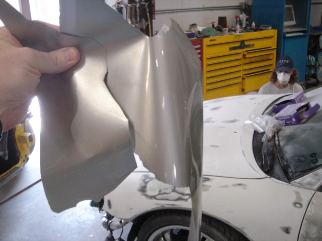

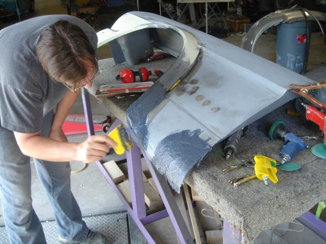

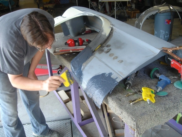

On a positive note, the body shop did get two projects from people who have been following the build on the internet. One is a 67 Mustang convertible and the other is a Honda rice rocket. The 67 vert needs to be restored after a "small" electrical fire (drivers side engine bay). The "rocket" was in a slight fender bender, but needs a total paint job (Another body shop butchered what was supposed to be a high end "custom" paint job. Here is a photo of Wayne scraping the finish off with a razor blade.

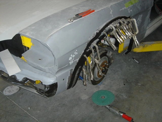

As far as the car goes, we have been busy little beavers, with Wayne performing a lions share of the work. I have been working on the oil cooler installation, the intercooler mounting, the prop rod installation, etc... Wayne has been working on the drivers side fender and the front grill / valance installation. Following are some photos showing the progress of the past few days. If these aren't enough to keep you satisfied, we have downloaded many more photos at our site.

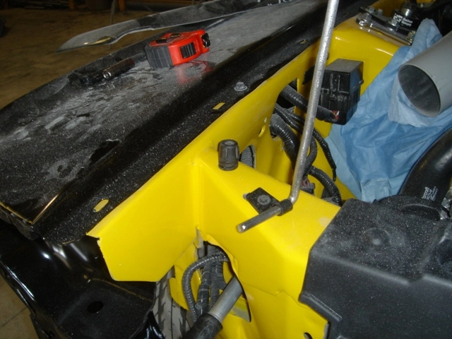

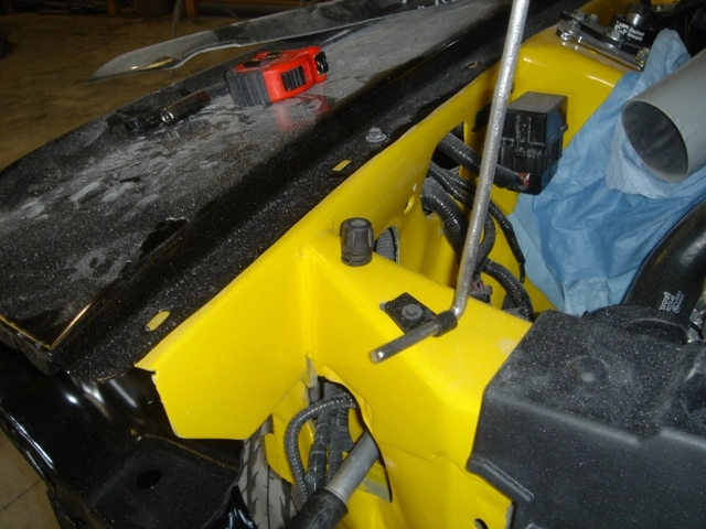

Prop rod details (Note the installation of the hood bumpers)

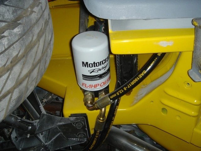

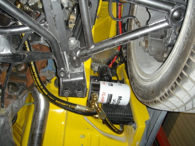

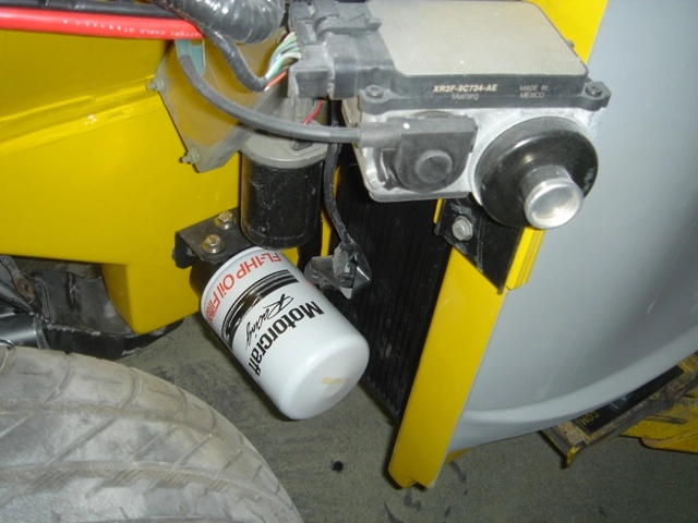

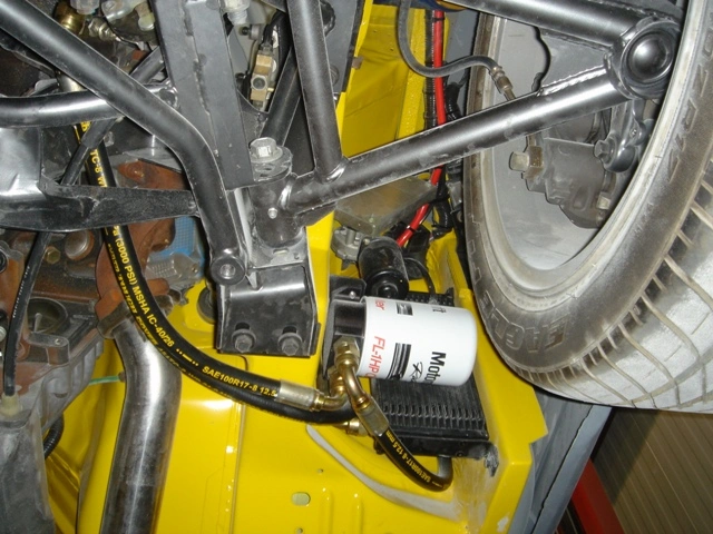

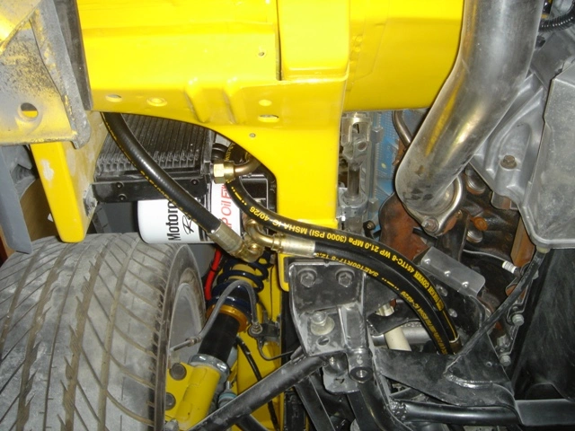

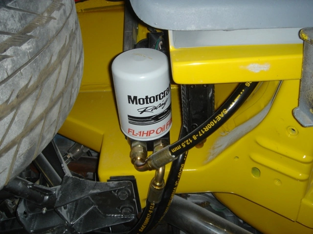

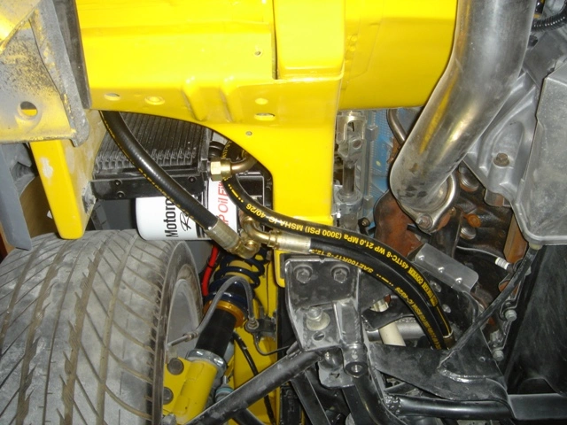

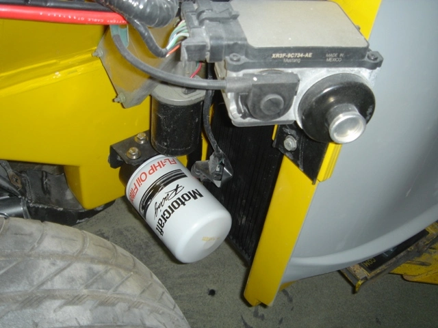

Oil filter / cooler details (I still have to install the debris shield). Pay special attention to the lines and fittings used. The lines look like your standard automotive hose, but they are a little bit more industrial than that. These armored hydraulic lines have a burst pressure of 9,000 psi. Also, the internal shielding makes these lines virtually impact resistant.

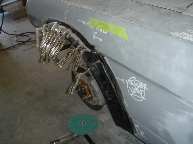

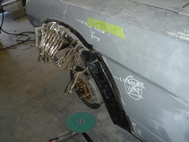

Flare details (Note the extractor vent)

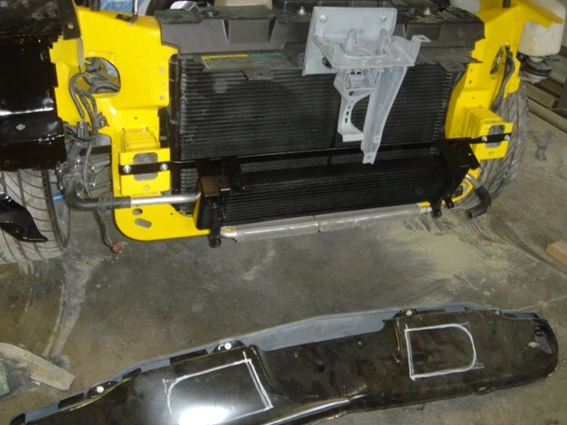

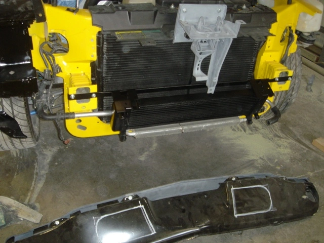

Intercooler heat exchanger details

dennis112 said:
Would there be room to mount the oil cooler inside the lower valance? It would be protected there and would also receive decent air flow.
Hi D,
We thought of this a while back, and while a great idea, we just don't have enough room. After installing the heat exchanger, there is just enough room left for the installation of the bumper brackets.
Okay, I'm not worried about the oil cooler anymore, whatever debris picked up off the road hitting/putting hole in/knocking off the oil filter will easily take care of that.
:jaw: :jaw: :jaw: :jaw: :jaw: :jaw:

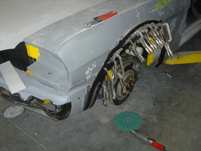

I see your going with the extractor idea at the flare, even though I saw it crossed out. Are you going to beef up the flare at this point? I'm not sure how thick the fiberglass on those flares, but I'd be a bit worried about it twisting back and forth in a high speed vibration during "spirited" driving. I'd likely cut a strip of sheetmetal and bond it to the back of it overlaping the ends of the gap, that would stifen it up enough to survive a car door as well I'd think.
Hey, I've been to car shows where idiots that buy cars instead of build them have done worse, backing into other cars, bending a bumper back trying to squeeze out of a spot without a spotter.
How about this senerio, Joe Blow leans over the fender to gander down into the engine bay and knee's it in standing back up?

I think there will be rooster tails of oily road grime on the fenders behind those extractors if a rain shower happens upon you.
Hi KK,
Never really gave that thought much consideration. We will have screens to catch any debris. I guess we can baffle the inside to block the direct line of fire from the tire.
Thanks for the heads up.
BullittFB said:
That prop looks like a disservice for a car like yours, why don't you try some lifts instead?
http://www.redlinetuning.com/QL-FORD-MUS-9904.html
Hi B,
Right now, we are going to stick with the prop rod. I kind of like prop rods. I removed the springs from my 65 daily driver and installed a prop rod. Maybe it is some kind of weird childhood flashback or something.
Also, there is not enough clarance between the hood and the fender. We would have to install them in a place that would make tham look like an afterthought.
