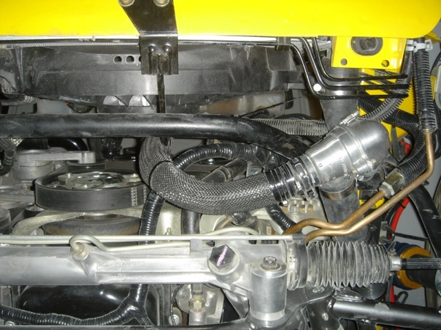

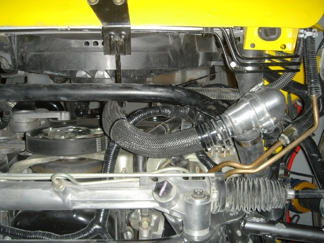

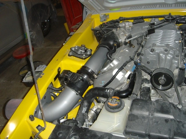

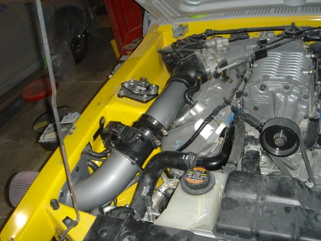

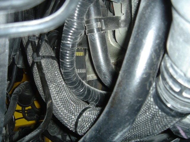

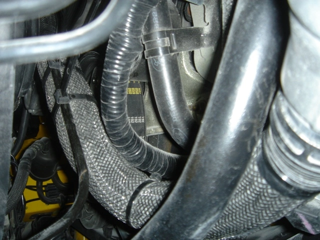

Hi All,
Yesterday, I worked on the final engine plumbing details. Radiator and air intake. Everything went pretty well. Not perfect, just pretty well. :-)
To complete the air intake I need to locate one sensor and plumb up one vacuum line.
My biggest problem is the lower radiator lines. I have posted some photos (more available at the website) showing the incredibly tight spaghetti bowl of lines and hoses in this area. Everything is pretty good, but I only have about 1/8" clearance between the sway bar and the hose / thermostat housing. There is plenty of flex in the plumbing (if the sway bar pushed on the hose, there is about 1 1/2" of movement). My problem is that there is nothing to tie the hose / housing to save the power steering rack and doing this is a bit problematic. I am thinking that I can make a bracket that ties the bolt of the housing to the rack, but there is nowhere on the rack to bolt to. I am going to have to kick this around for a while until something comes to mind. In the mean time, I am going to place a rubber "shield" around the sway bar to keep it from chaffing the radiator hose.
Any recommendations would be appreciated.

Bob, can you make a bracket to attach to the two holes on the yellow bracket in the middle picture? It'd have to clear the three vacuum lines, but maybe you could get one of those plastic clips that the snap into and mount it to that bracket as well. Paint the bracket semigloss black like the bracket to the left of it in that picture that's under the shroud and use CAD plated fasteners and I think it might look factory.
