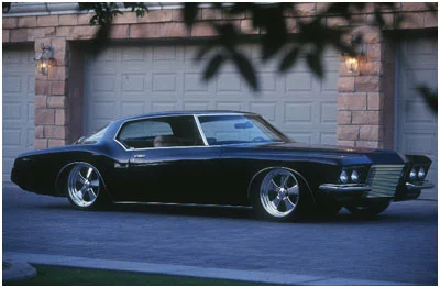

Big rims should only be put on hot rods, finned cars or cars like this one:
