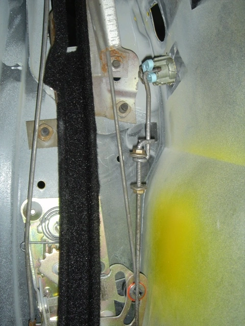

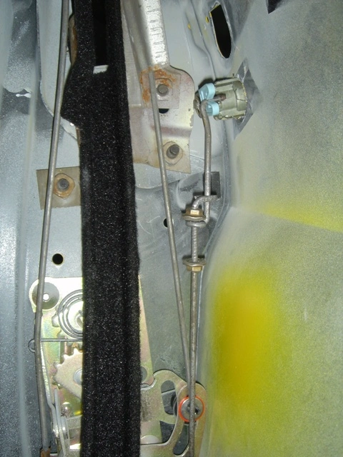

Anyway... We have been making steady progress on SN65. Right now it is the doors that are consuming all our time. As I have stated before, it's the little things that bring me the greatest satisfaction. For example....
We wanted to use the door cylinder from the 03 Cobra. We wanted all the locks to function with the ignition key. Wayne went and modified the door to accept the 03 cylinder and I went about installing all the internal mechanisms. All was going well until we ran into a little snag. Unfortunately for us, the 03 cylinder does not function the same way as the 65. The 65 lock has only two positions. All the way down for lock and all the way up for unlock. The 03 lock has three positions. All the way down for lock and all the way up for unlock, but the lock always comes to rest in the center. The 03 cylinder is designed to function with a electrical relay while the 65 is designed to work mechanically. We stood around and scratched our heads for a while. We went home and slept on it. We came in and gave it some more thought, when we finally hit on a workable solution. Here is a photo of the installed linkage.
What we did was linked together two rods that would slide over each other until they hit a stop. This allows the 03 cylinder to function mechanically. What happens is you turn the key to lock the door and it pushes the lower stop down to lock the door. When you rotate the lock back to the center position to remove the key, the rods slide over each other leaving the door locked. When you rotate the key to unlock the door, it lifts the upper stop up to unlock the door and then the rods slide over each other leaving the door unlocked.
It is a rather simple mechanism, but I have to say that I am thrilled at the way it functions. Yes the guy's in the shop make fun of me. It is nothing that anyone will see or even notice for that matter. But every time that I use the key (which will be rarely if ever, seeing as the car has a remote lock and unlock function) it will bring a smile to my face.

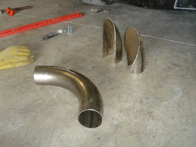

Front Valance Question
Hi Bob,
First off… Incredible car! No other words.
Second, I apologize if you covered this previously and I missed it in the 29 previous pages of this post but I have some questions on your modifications to the front valance.
Mainly I am curious what you used for the new base material on the two new air inlets. Did you hand form them from sheet metal? It almost looks like you used a piece of pipe that was mandrel bent and then cut on a bias to fit the openings. If you could describe the process you used for the new material I would appreciate it.

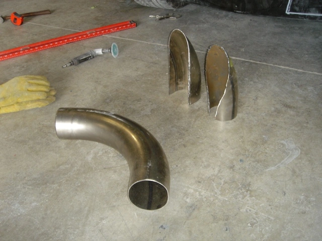

rufusbooth said:
Hi Bob,
Thanks for your time!
Cheers,
Rufus
Hi Rufus,
You nailed it on the head.
We used a 4" dia thin wall short radius tube from McMaster Carr. We cut the tube into two 45 degree sections. We then trimmed off excess material from the outside edge of one opening to the inside edge of the other (see photo below), leaving a teardrop shaped opening. We then opened up and flattened the edges of the tube leaving us with a shape reminisent of the Sidney opera house. The pieces were then trimmed to mate up to the front valance and welded in place. The back side was trimmed to clear the heat exchanger.
This photo (as well as a few others) are from the 9-19-05 update on our website.
I hope this helps.
