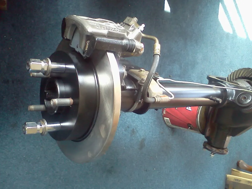

It's not that bad. Worst part about the booster is under your dash trying to snake the nuts back on the studs with universals and extensions flopping around.
Even the rear disks are no big deal. Honestly, the SN95 disk conversion was one of the fun projects on the car...second to my t5 conversion

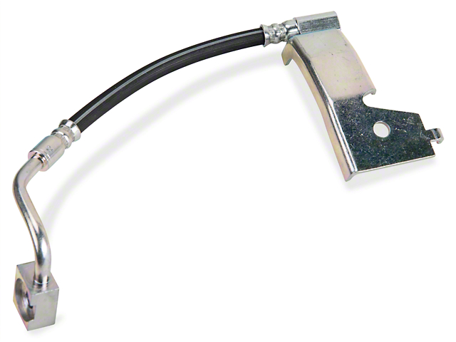

For brake lines, just get some cheap parts store 99-04 front lines, and 94-95 rear lines.
Weatherhead 7818 adapters out back and weatherhead 7828 (or Dorman part # 327828) on pass side front.
There's a Dorman equivalent for rear adapters but can't find it at moment

About the rear lines, will the stock 96 soft lines I have not work?
Thanks for all the help Mike!
I'm sure with a bit of finageling, you can make anything work, but the 96+ lines were body mounted, while the 94-95 lines mounted to the axle in a more Fox-like manner. It's, in my opinion, a cleaner, more secure install.
Just looking on rockauto.com...they have rear lines for under $10 each.
