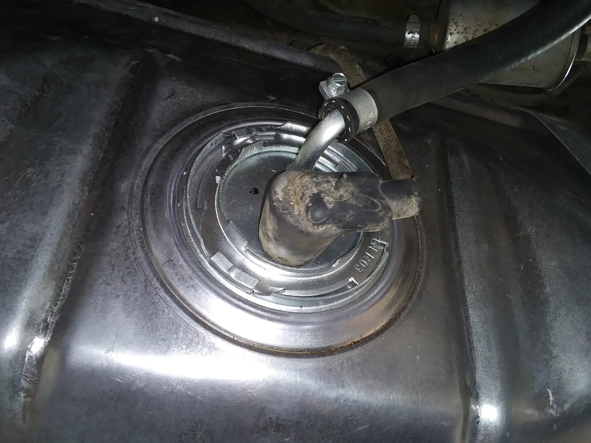

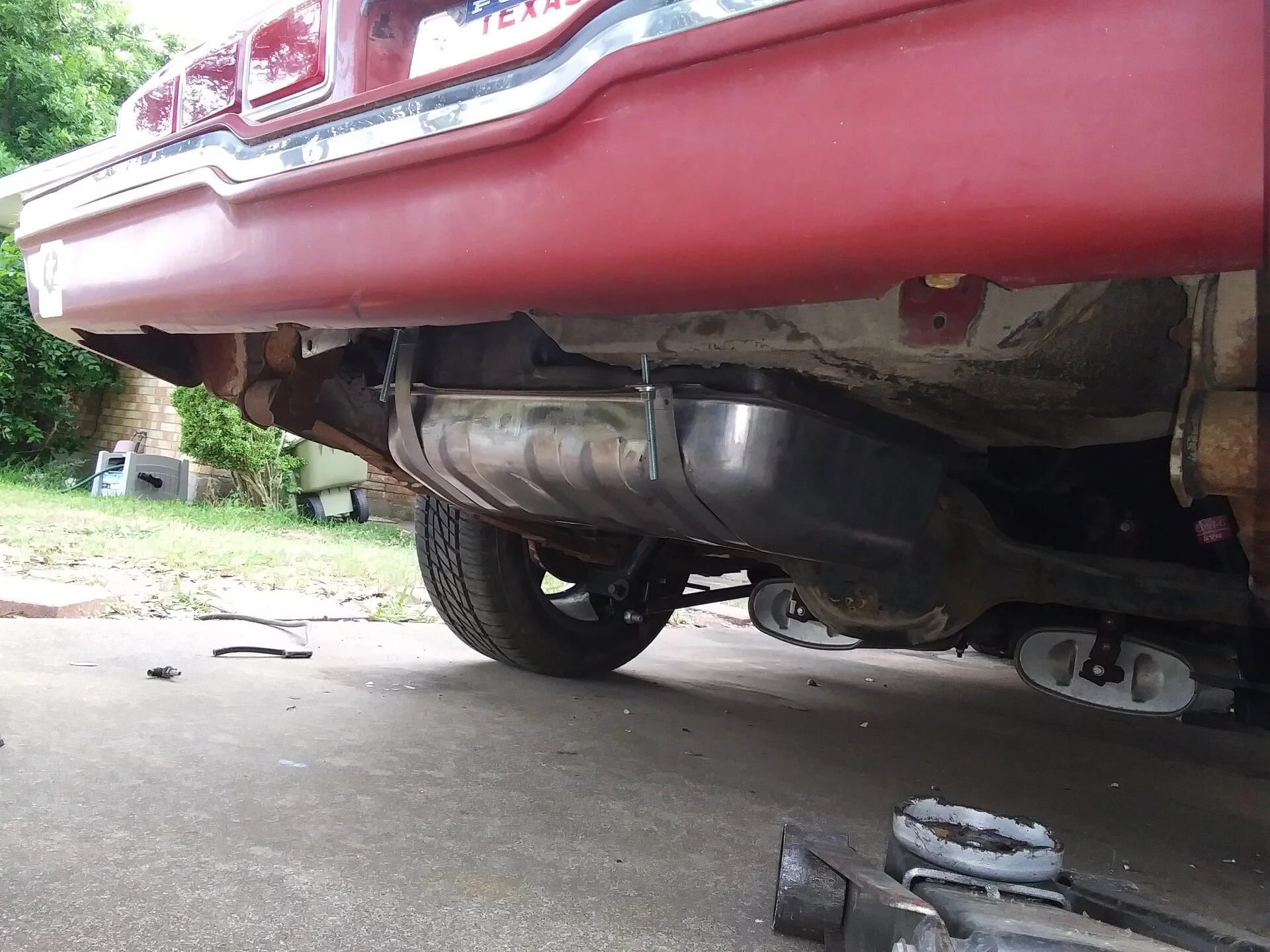

For the record, Spectra's tank, straps, and sending unit fit like a glove, and whoever Classic Auto Reproductions sourced the fuel tank seal from did such a good job molding it for a tight seal that it took extra Vaseline to get the fuel filler neck into the tank.

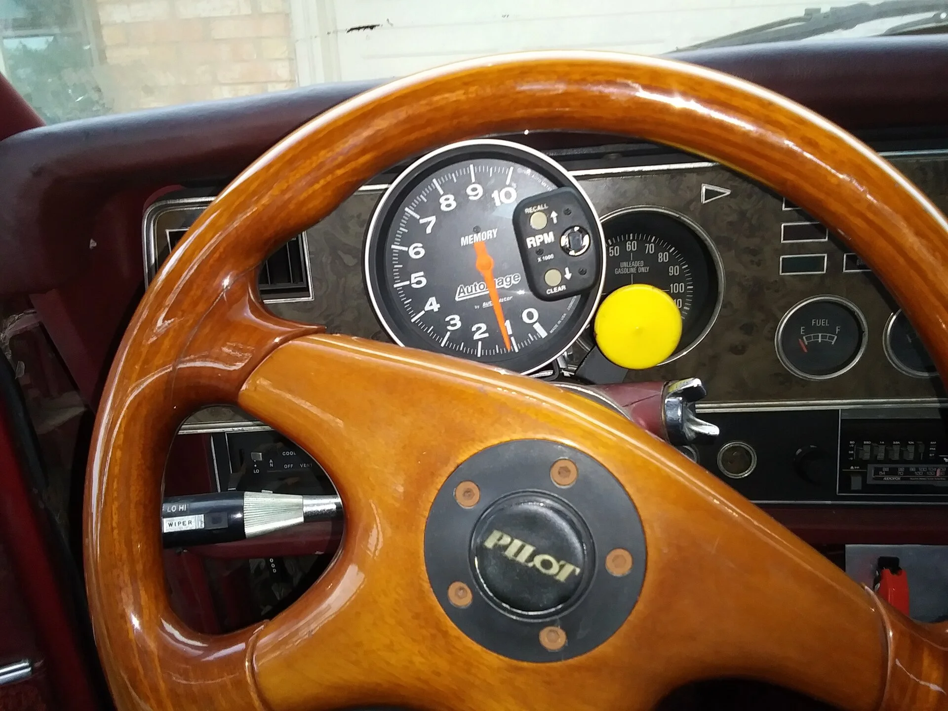

Check out my working fuel gauge!
View: https://youtu.be/q5Ifwj5ZU-0
Just took her for a drive, and gave it the beans...
Something isn't right. She's running short of air or fuel way too early. My suspicion is air, given the new air cleaner, but with one of the fuel filters still needing replacement, and the 5/16" feed into the pump instead of MSD's recommended 3/8, it could be either. We'll see. I'll pick up the other filter I ordered from Napa tomorrow and change that first.
It's fuel. Past 4500rpm it falls flat and pings a bit. Up to that it pulls real nice.
With the air shocks gone, the manual steering, and a fresh alignment, it drives the best it ever has.
