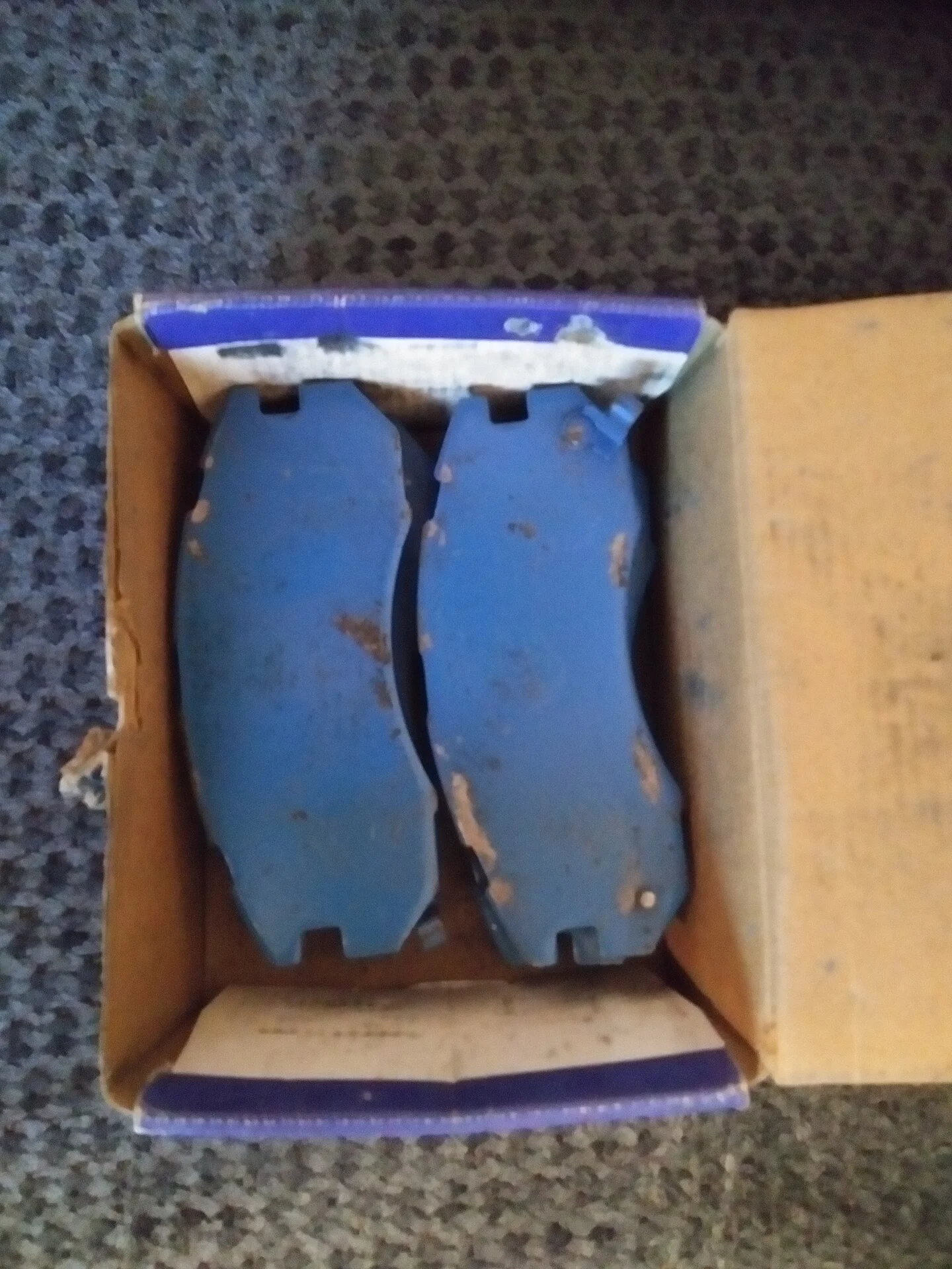

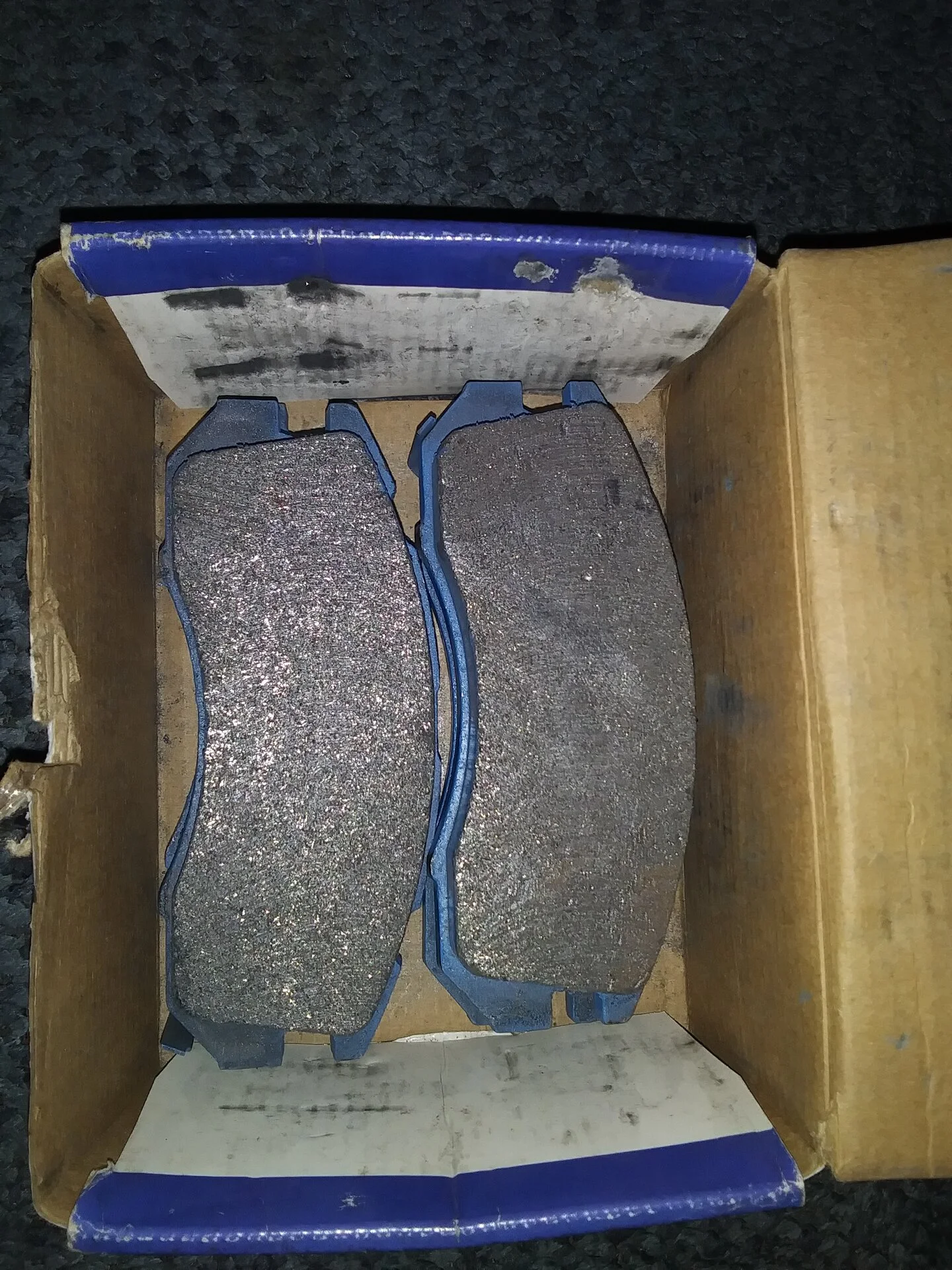

In Capri news... (What? Ya'll thought I'd forget about the other red rustbucket with a 302 in it in my life just because ElSuperPinto is running?) I ordered rear brake shoes and wheel cylinders from RockAuto for it. I was thrilled because, not only did they show to have the rear shoes, they were $2.00!!!
What showed up, isn't even brake shoes, it's brake pads, and worse, someone's previously installed garbage.
Okay, deep breath, I'll just return the .
Turns out that I have to pay the return shipping and then they'll reimburse me $6.20 for that, I'm still out the initial shipping of $7.99. On top of that, their return instructions say you can get a discounted shipping label from the order status page... um... no such thing exists on the page.
I've been happy with @RockAuto up until this point, but this is the last thing I'm ordering from them. This is pure on their part.
Reactions: Potomus Pete, LILCBRA and Olivethefet
...and there is nobody to complain to about it either. No fix, no procedure, no nothing.
Those look like they've been installed at least twice.
Reactions: 2Blue2

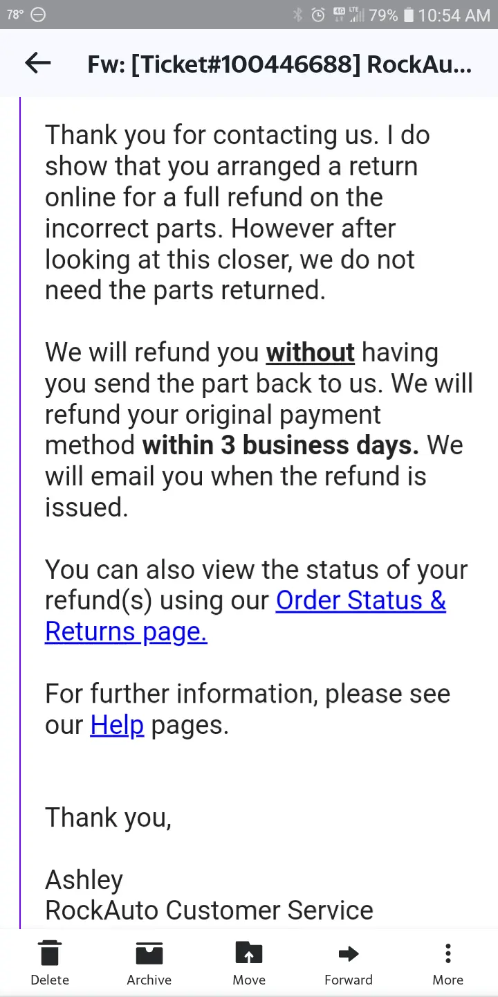

Pretty much. The button to click on for the shipping label they show in their "how-to" on returns isn't there. If you call their phone number, an automated voice tells you they do not offer customer service by telephone. Sent an email, for all the good that's going to do.
Wrong damned part altogether, but I've got to pay to ship it back and hope that the $6.20 they're going to reimburse me is enough?

@RockAuto made it right after emailing.
Great, time to get back to shopping!

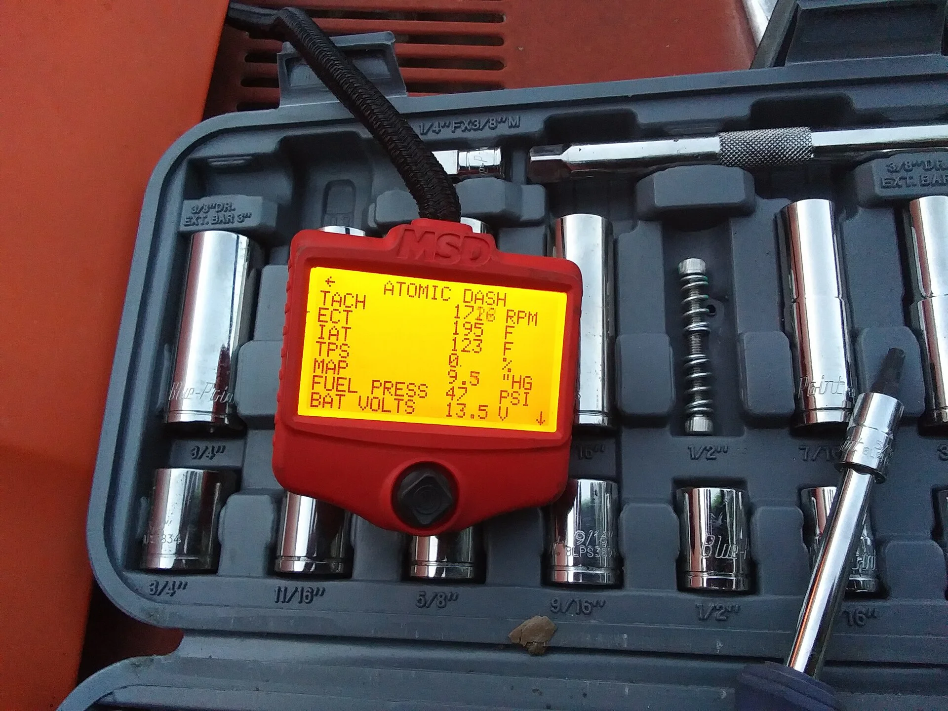

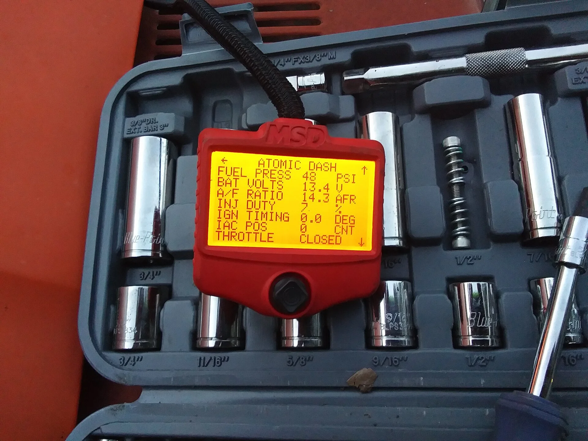

Got the new Chinese IAC that I ordered from RockAuto in.
It no worky either.
That's right, 1700rpm idle, IAC thinks it's fully closed, throttle IS closed, and yes, those ARE the idle speed screws in the 1/2 deep socket's home, I turned them that far out... That's how I got it down to 1700rpm from 2000.
I'm going boneyard hunting for used GM IACs this weekend. That's what fixed it last time, and will hopefully fix it this time so I can chunk the **** on Ebay as a working unit.
Now... Street Demon 625cfm or Edelbrock Thunder AVS2 650cfm? That... Is the question.

Silly question, but you have no vacuum leaks anywhere, right? I mean 2 separate IAC valves and it ran the exact same? Something doesn't add up.
No vacuum leaks.
I've been through this crap with this EFI system before. Apparently it's such a common issue that MSD now has a software update for it (about damned time!).
I even had a new IAC fail immediately after install last time too.
I wish I hadn't lost the other 2 used IACs I pulled off of Buicks at Wrench-a-Part, I wouldn't need another one now!
