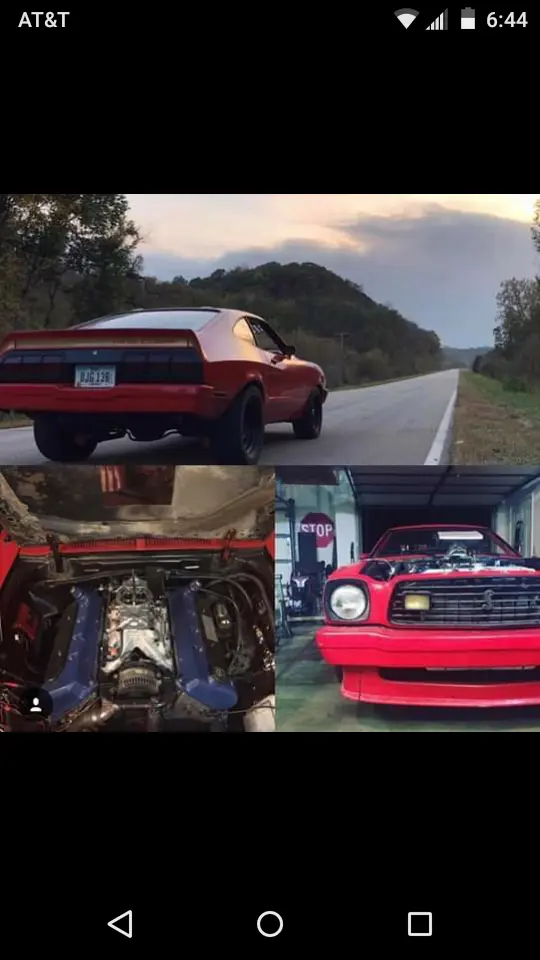

Seems like I've chatted with the owner of that car at some point somewhere. He's from Dubuque and I looked at a red King in Dubuque before I moved here from Iowa. I don't remember where I chatted with him - I think it was probably one of the Facebook groups before I left them.

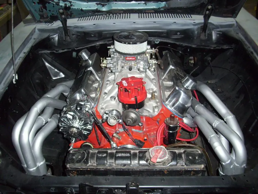

74stang2togo said:
I'm not, on either count.
The MSD Atomic is going on Ebay when the 308 comes out of the car. I see zero point in putting any more time or money into the old pushrod powerplant at this point. I'm going to fiddle with the idle speed screws and unplug the IAC tomorrow and get it running again (assuming my working theory is right) and run it like that the whopping 1-2 times a month I drive the rusty old thing until the 4.6 is ready.
I... may have fibbed here.
You see, I went to all the trouble of finding my old Edelbrock carburetor... and ordered that nice new Carter fuel pump... and have a handful of 12-volt, 30-amp relays laying around, and even though the MSD Atomic is currently working in it's gimped state without an IAC, a failure is why it's in such a state, and there's no telling if it will fail further...
I think I may waste a few hours at the shop either tomorrow or Saturday stripping the EFI system from the car and throwing the carburetor back on. THEN I'll be done with the 308 until it's pulled from the car.
[/QUOTE]
Also... this is the problem with this damned 4.6... It look SO DAMNED GOOD with a carburetor, and SO DAMNED GOOD with the Mark VIII manifold that it makes coming to a permanent decision regarding the induction rather difficult.
(I could also just be losing my mind...)

Noobz347 said:
What is the concern with switching to carb?
For the 308, nothing. It's a bolt-on affair. I've just been reluctant to do it.
For the 4.6... price. The manifold is $700, the adapters to make it fit my "B" heads are $400, and the MSD ignition system to run the thing is $450. For that much money I can go full-blown MS3 instead of my tentative plans to use a Microsquirt and EDIS8. Add the fact that I'm not keen on using anything MSD ever the hell again after their EFI system was such a phenomenal pile of , and you get to the root of my hesitation to go carbureted on the 4.6 4V. Unfortunately MSD makes the only two solutions for firing the ignition system with a carburetor.

The red car had a 2v 4.6 that has a carb on it. I used that goofy assed MSD controller to run the coils. It all worked like it’s sposed to, and was really easy to set up, but you ain’t running no carb no mo. Yesterday, while I was at wits end with Steve, I told him that if it wasn’t for the VVTi, I’d ditch that cam sensor, and the freakin VVT, get an EDIS6, and convert the thing over to batch fired wasted spark, and ditch all of the BS finicky hall/VR sensor sync loss.
life was much simpler then..Now I gotta dwell in ricer hell.

So the injectors are on their way, the parts list is compiled, and all of the cosmetics are figured out.
And nothing else is going to happen for a bit. I started feeling sick late Friday night, and by Saturday morning felt like death would be preferable to breathing. I did an online consult with a doctor who sent me for COVID testing, and I'm awaiting the results. A few hours later, my mother, who had insisted earlier in the week that she just "had allergies" and only went to the doctor because my sister and I both insisted, got the results of her COVID test back, and it's positive. I have zero doubt at this point mine will be as well, so I can't work (nor access my 4.6, which is sitting next to my toolbox at work) for at least the next week or so.
Allright, enough of that depressing .
Here's the list of parts I need to acquire to make the 4.6 run, and hopefully make it fit with relative ease:
Lincoln Continental oil pan and pickup tube
Microsquirt
Ford EDIS-8
1999+ 4v valve covers
1999+ 4v COPs
GM 3-bar MAP sensor
Lincoln Continental forward exhaust manifold
MMR IMRC delete plates
Mark VIII air intake
Flywheel
Clutch set
SFI-approved balancer
TR3650 rebuild kit
Manual master cylinder or power booster delete kit
MMR 96-98 Cobra fuel rails
Airtex E2000 (n/a) or Aeromotive Phantom 340 Stealth (turbo) Fuel pump
I already have the 4.6 4v, the transmission itself, an EGR delete, Hurst shifter, clutch cable, manual pedals from a II, stainless exhaust manifold studs, BMW alternator bolts for the intake manifold, and the factory injection harness to splice to the Microsquirt and EDIS-8 harnesses.
The possibility of going turbo in the future with this thing is very real, as the block can handle essentially infinite power, and the stock crank in these engines has been proven past 600rwhp. The connecting rods are the weak link, and are still good for 500+ RWHP according to the experts.
