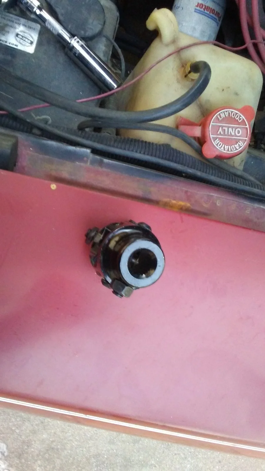

Earlier in the thread, I'd linked this little guy, a flex-joint that adapts from a Mustang II steering shaft for a power steering car to a manual rack. This is pretty much the last we'll see of this little guy today.

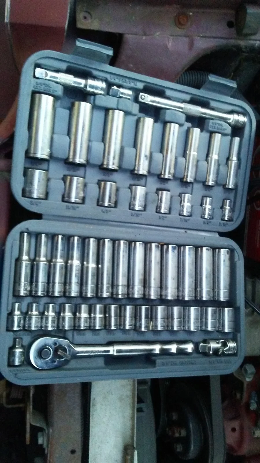

One of the things that bugs me the most about working on stuff at the house is, I frequently miss my "good" tools from work. Well, SnapOn had this Bluepoint General Service set in a BOGO about six months back, and while I had everything in this set for work in as good or better quality, I wanted the other part of the BOGO and thought this would be glorious overkill for the house. I was right. This set is spectacular and has made a big difference over the leftover Chinese crap i usually use at the house. That ratchet is so good that it's twin has been in my work toolbox since 2008.

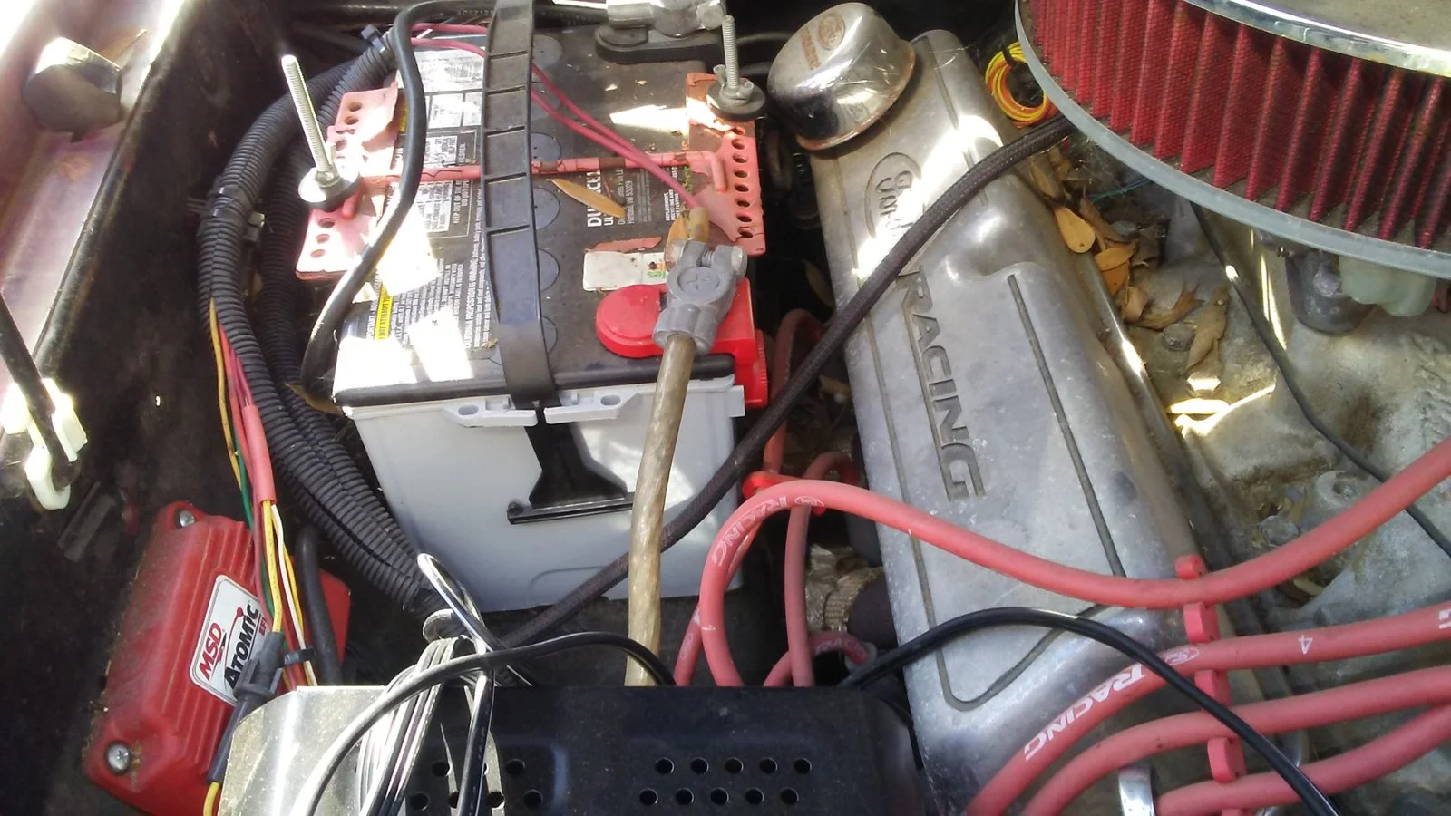

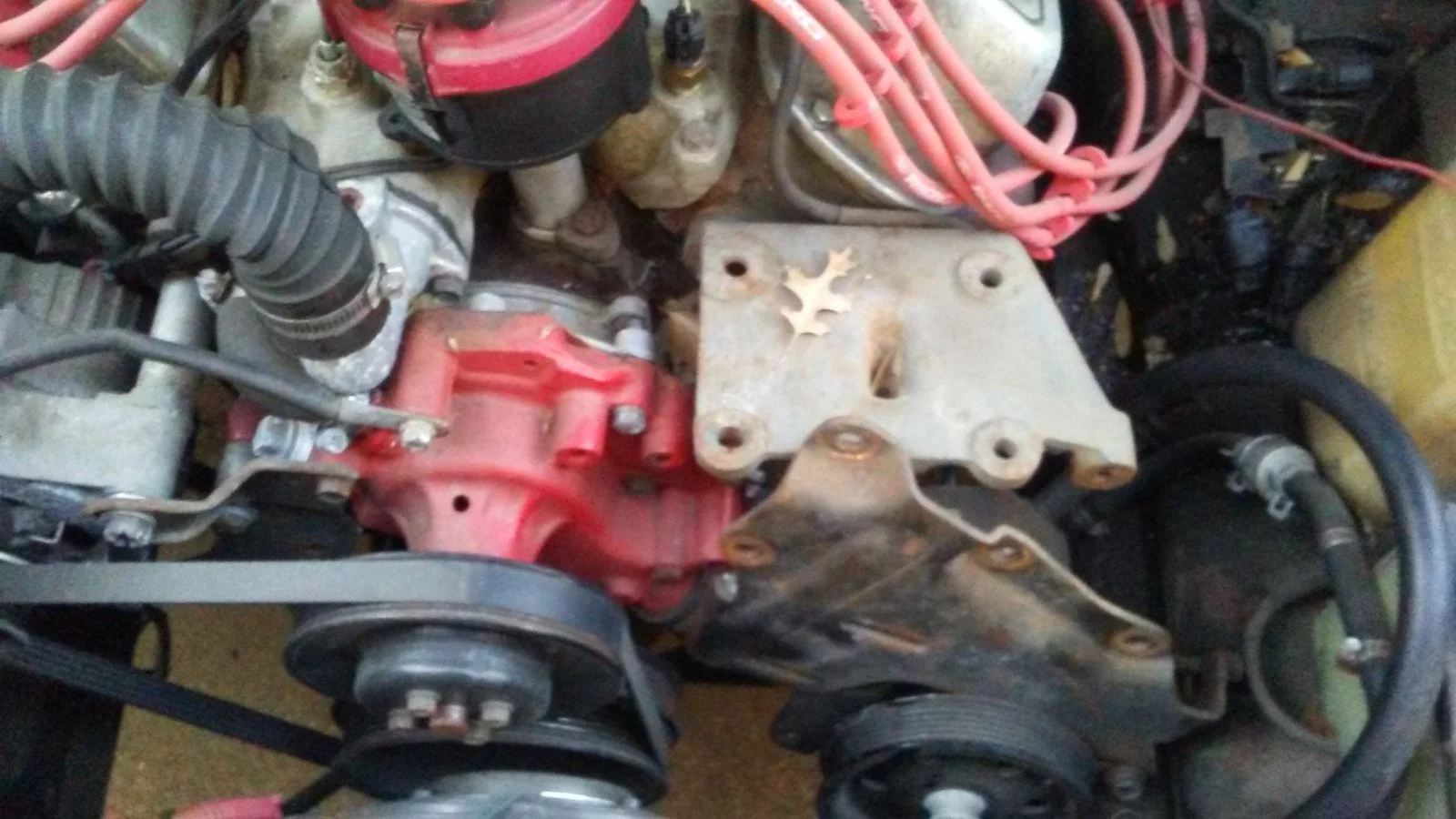

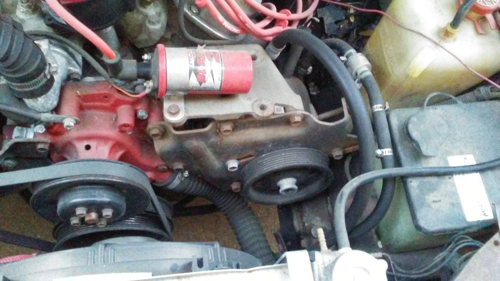

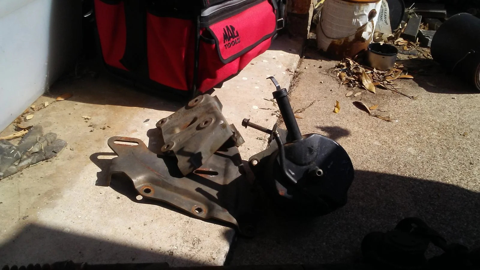

The power steering removal has started.The ignition coil had to get out of the way for the moment. That big cast iron A/C and power steering bracket isn't going back, so I'll be fabricating a bracket like Hadley installed on his Cobra (God I miss being able to reference his thread on MustangII.net, he even had the dimensions for the bracket there!) Even that will be temporary, as I've recently decided to go a different direction with the car overall, and this engine will have a new home in the next year or two.

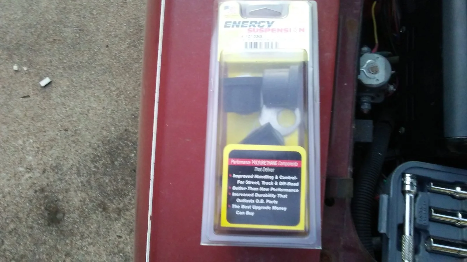

I managed to snag a set of Energy Suspension offset rack bushings in a bundle from a fellow II guy on Ebay. At the time this picture was taken, I didn't know if I'd need them, (didn't when I bought them either, but I needed ALL of the other parts he was selling!), they turned out to not be necessary, so you'll see these on Ebay soon.

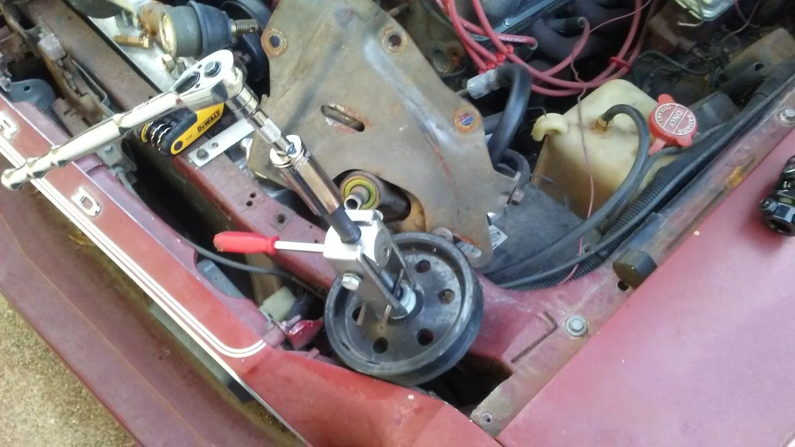

The 4.6 Lincoln Town Car power steering pulley is no longer part of ElSuperPinto.

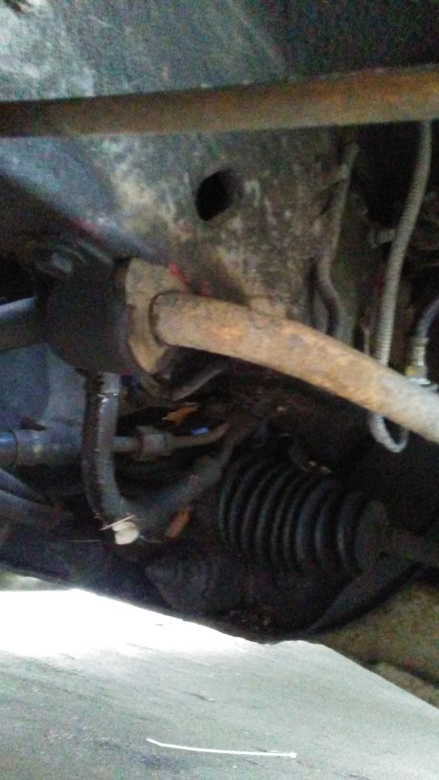

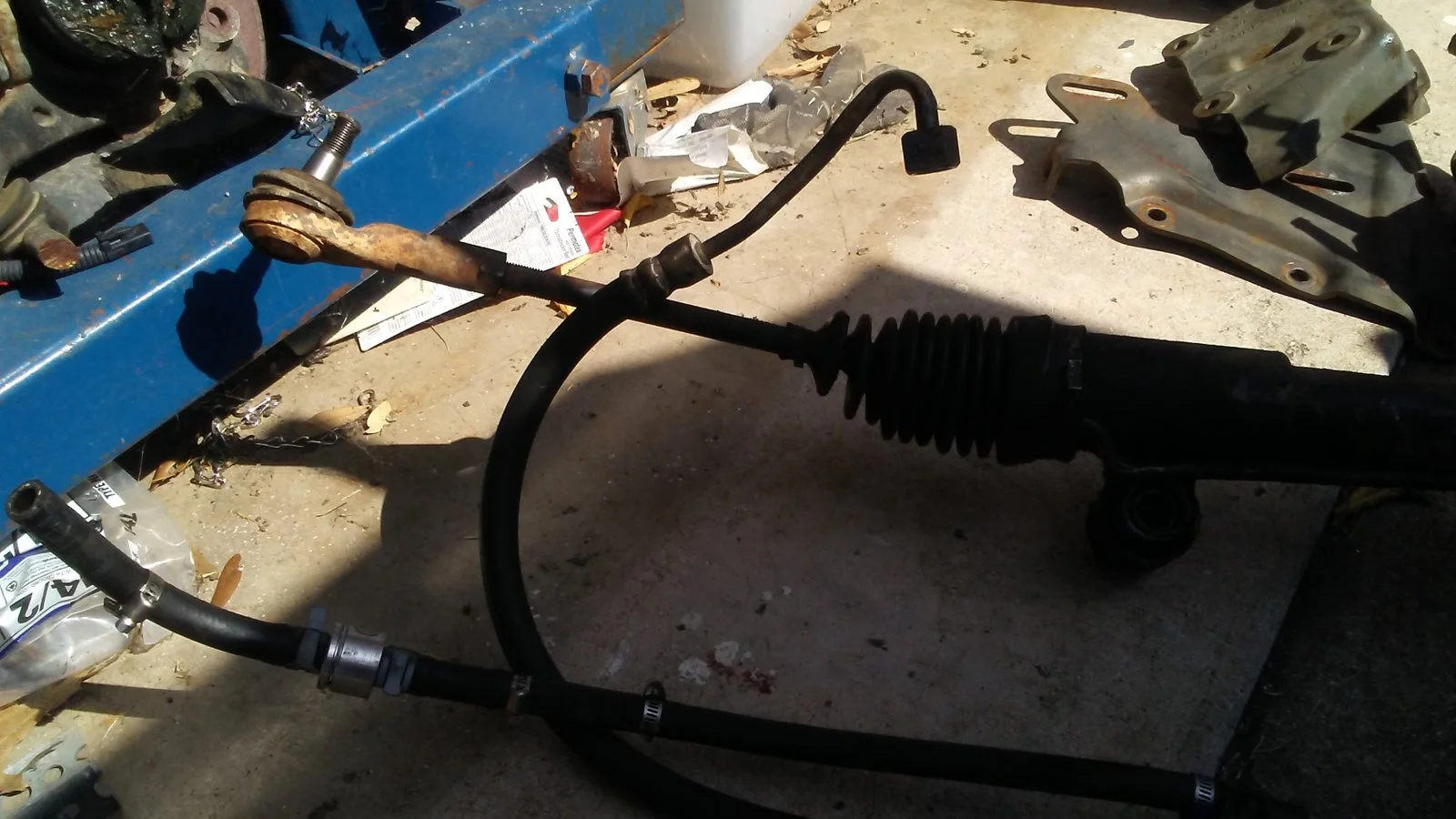

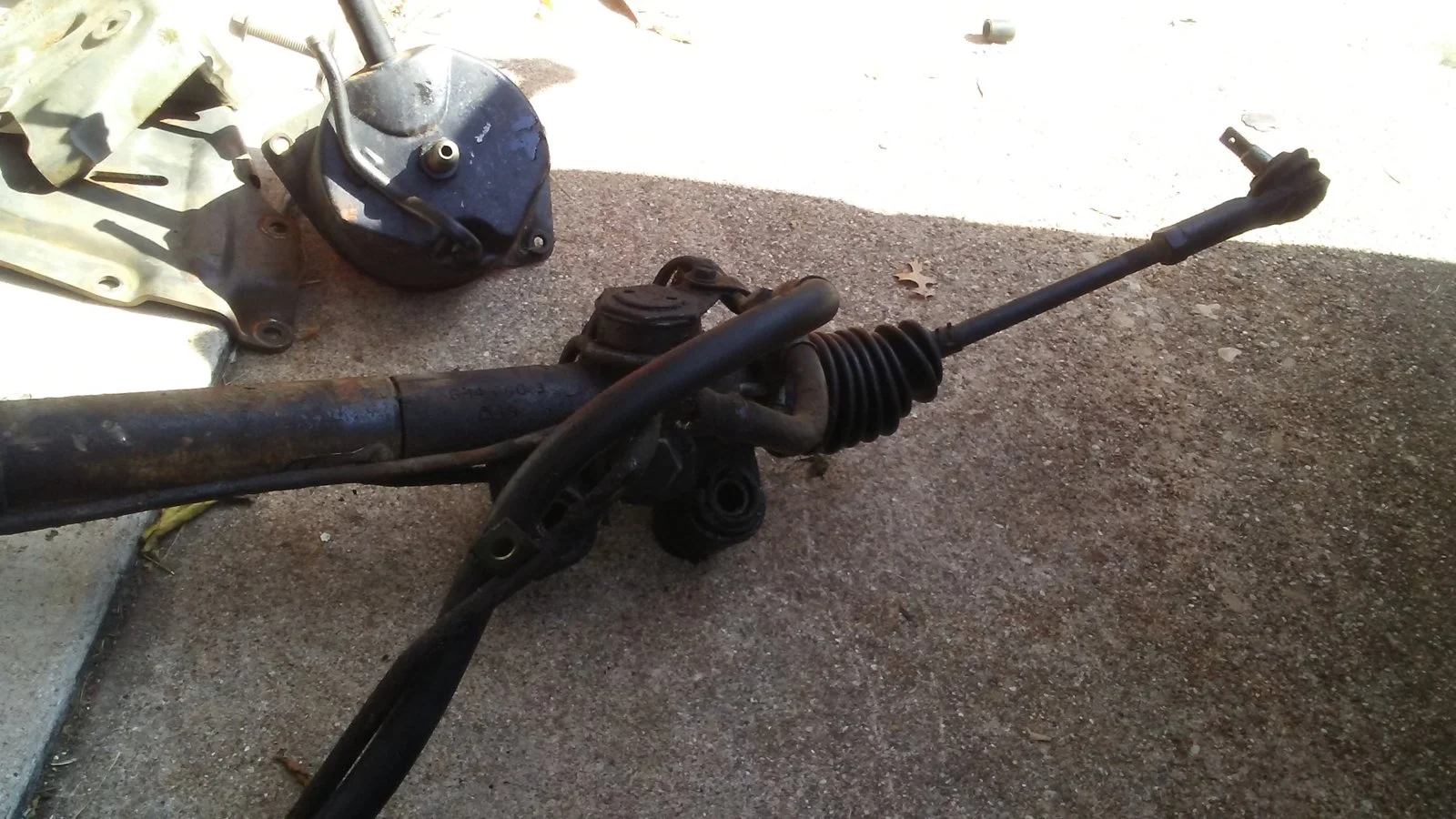

I was trying to illustrate something here... I think how tight and nasty the confines my big hands would be working in, that rack dumped a LOT of fluid, as had the bad pump in the past.

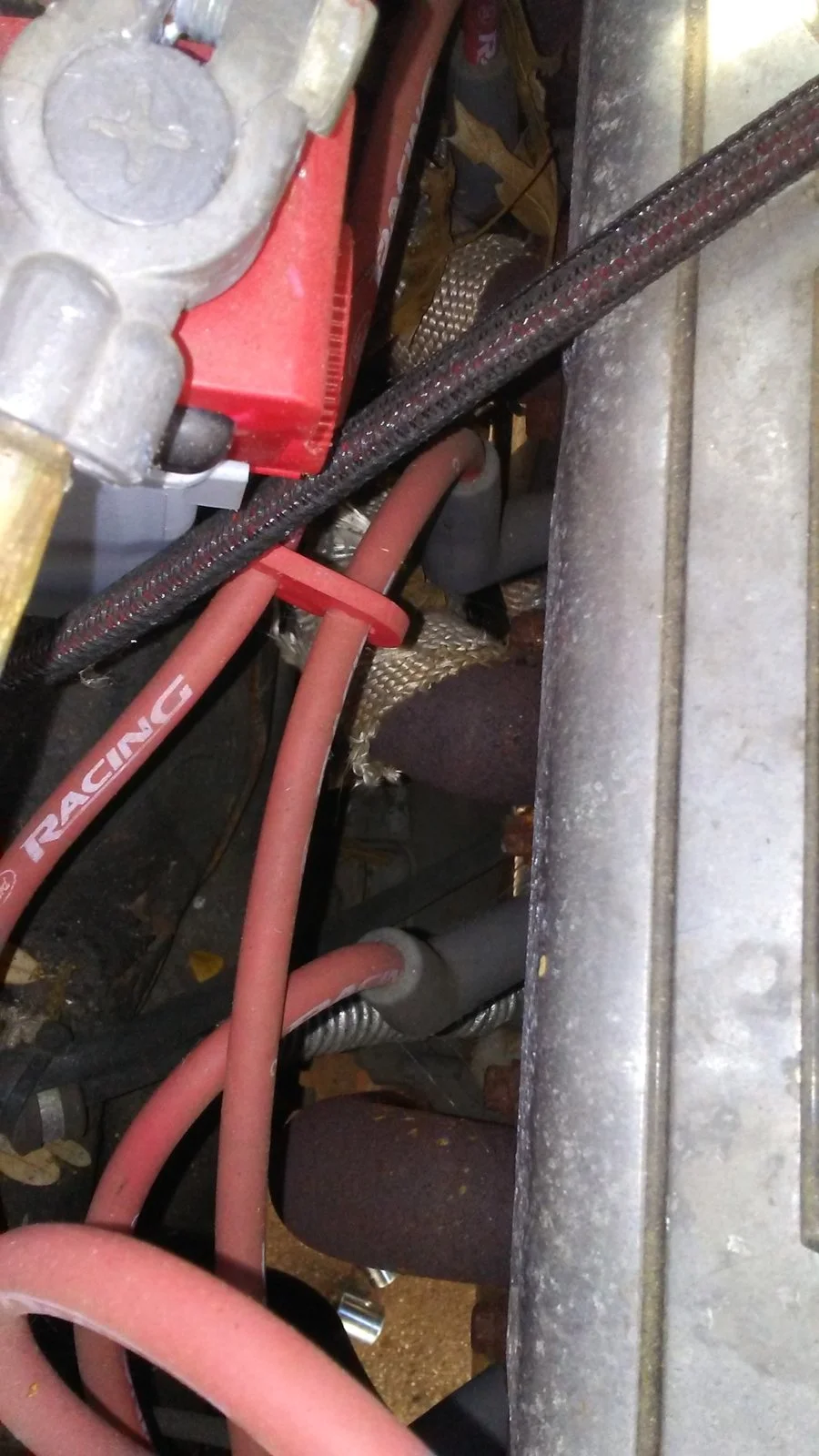

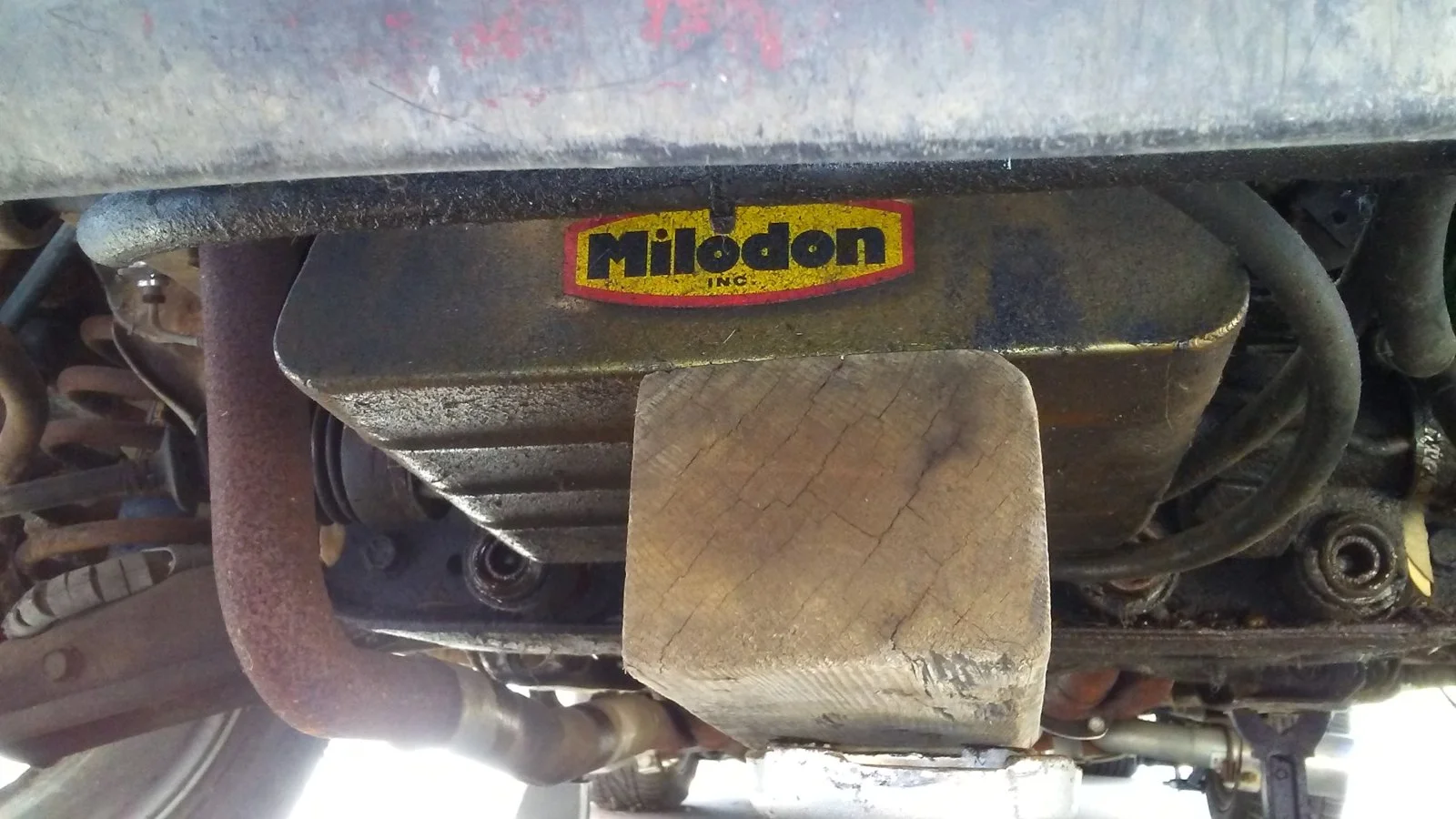

Here, you see the bane of my existence... or at least my ownership of this car. That passenger side header will have to be unbolted from the head to lift the engine enough for the rack to clear the big Milodon pan.

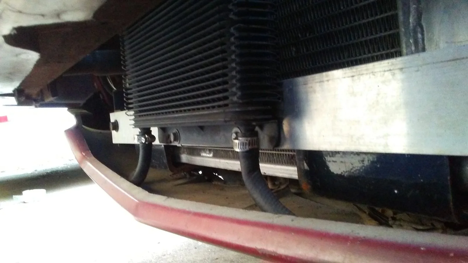

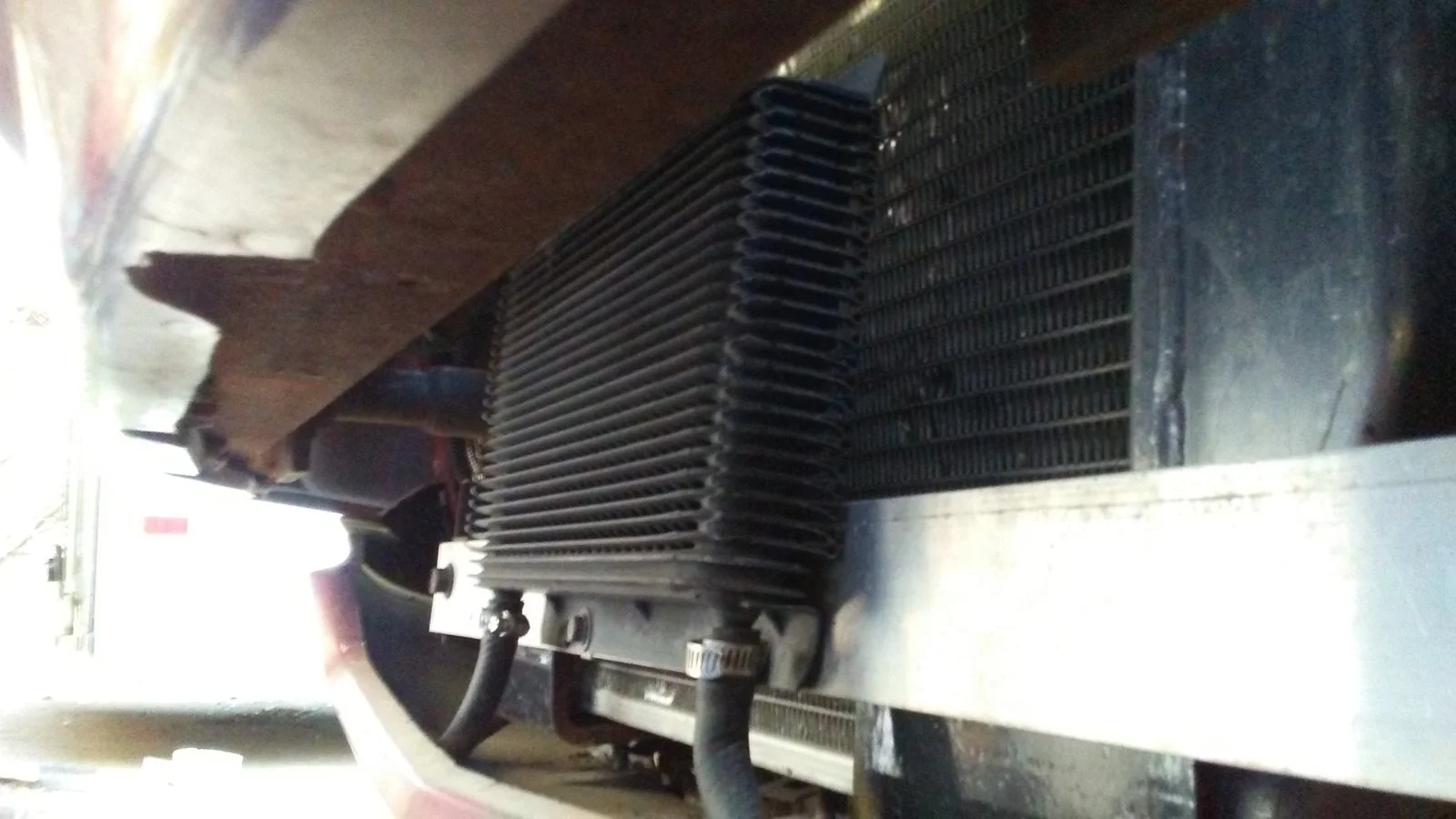

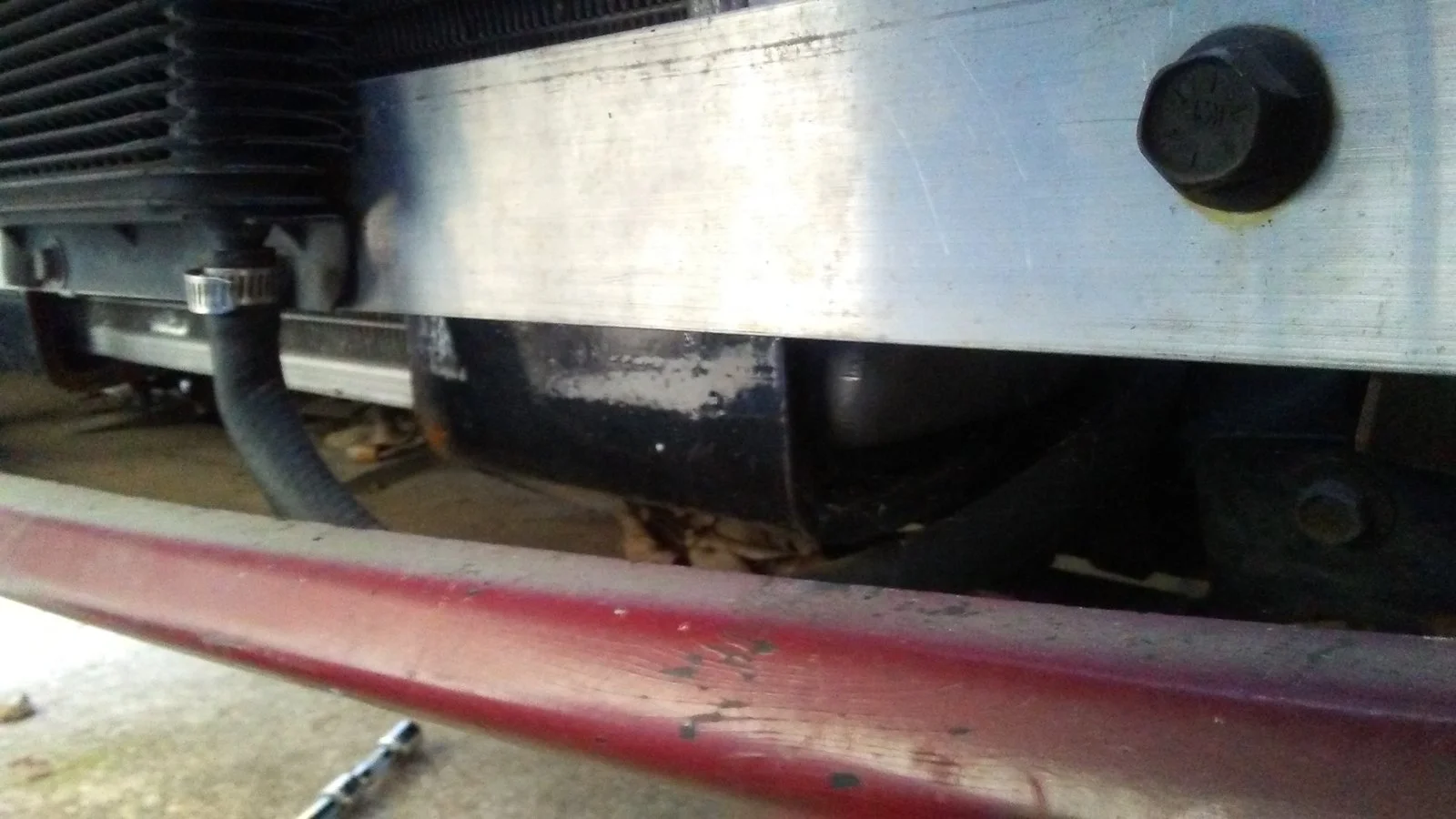

In the "Essential Mustang II Tech" thread about the Summit Racing radiator install, i promised some shots of the lower mounts I'd fabricated. Here's the custom bracket for the stacked-plate trans cooler that I made when I installed the radiator, with one of the two brackets visible.
Here's a better view of the other bracket. They're both made from C-Channel that's had a hole drilled into it so I could bolt them to an existing hole in the II's front core support. I placed thick foam-rubber weatherstripping within to cushion and hold the radiator.
Another pic of that setup... for some reason.

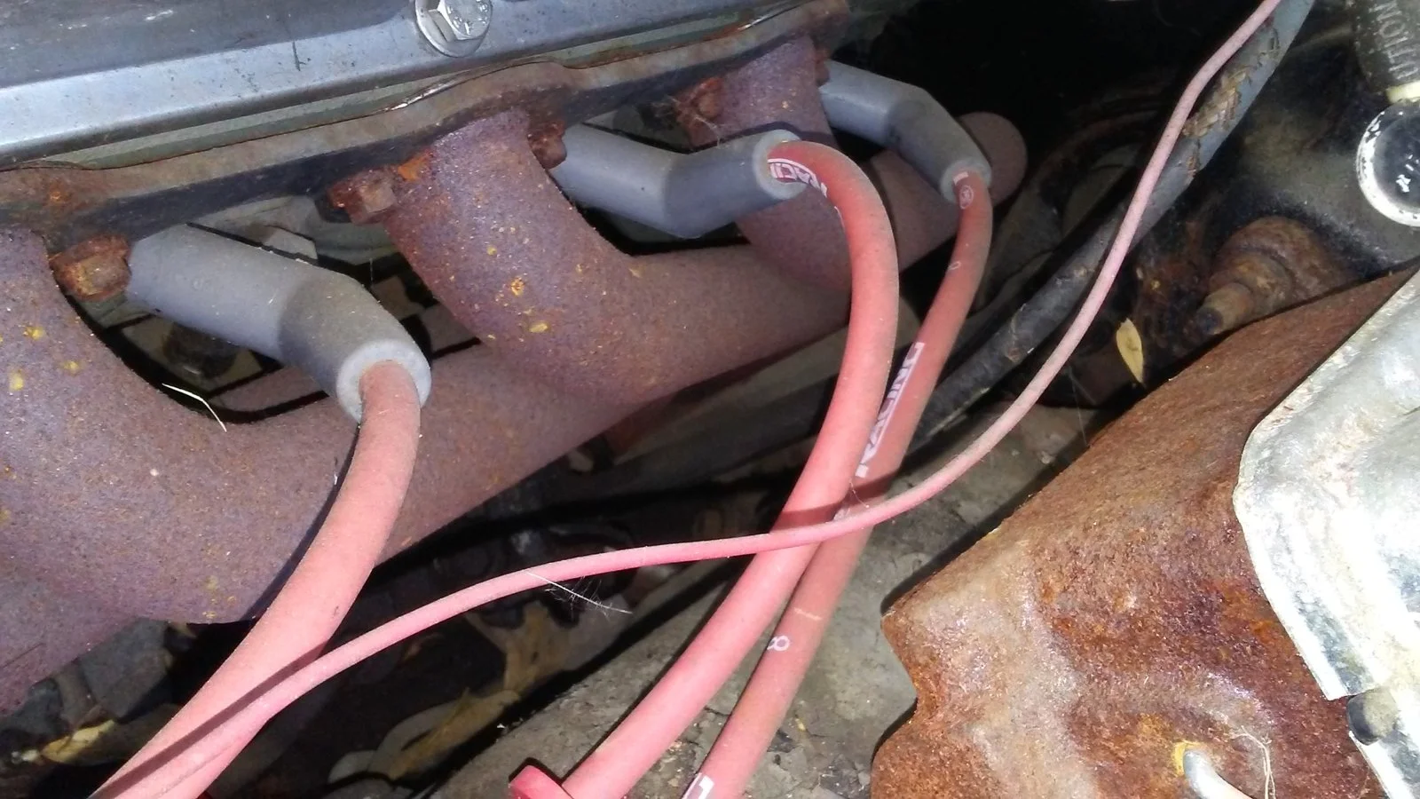

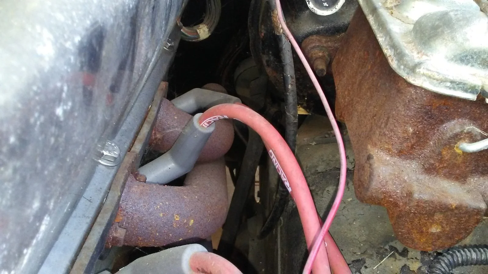

A closeup of that damned header, show how little room there really is. There was once a II owner on a forum that had a signature that said something to the effect that if you've never wanted to hunt down the previous owner of your car and kill them, it wasn't a Mustang II. I don't want to do that to the previous owner of my car, he's a damned good friend of mine, but stuff like this makes me understand the sentiment in that guy's signature.

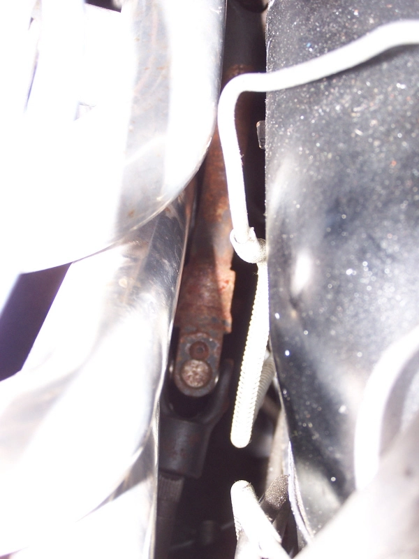

On the driver's side, there's virtually no room to get down to the steering shaft. Luckily I have a 2-foot long extension. The bolt, oddly enough, has a 7/16" 12-point head.

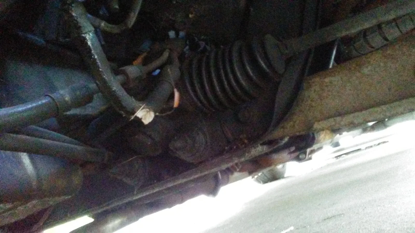

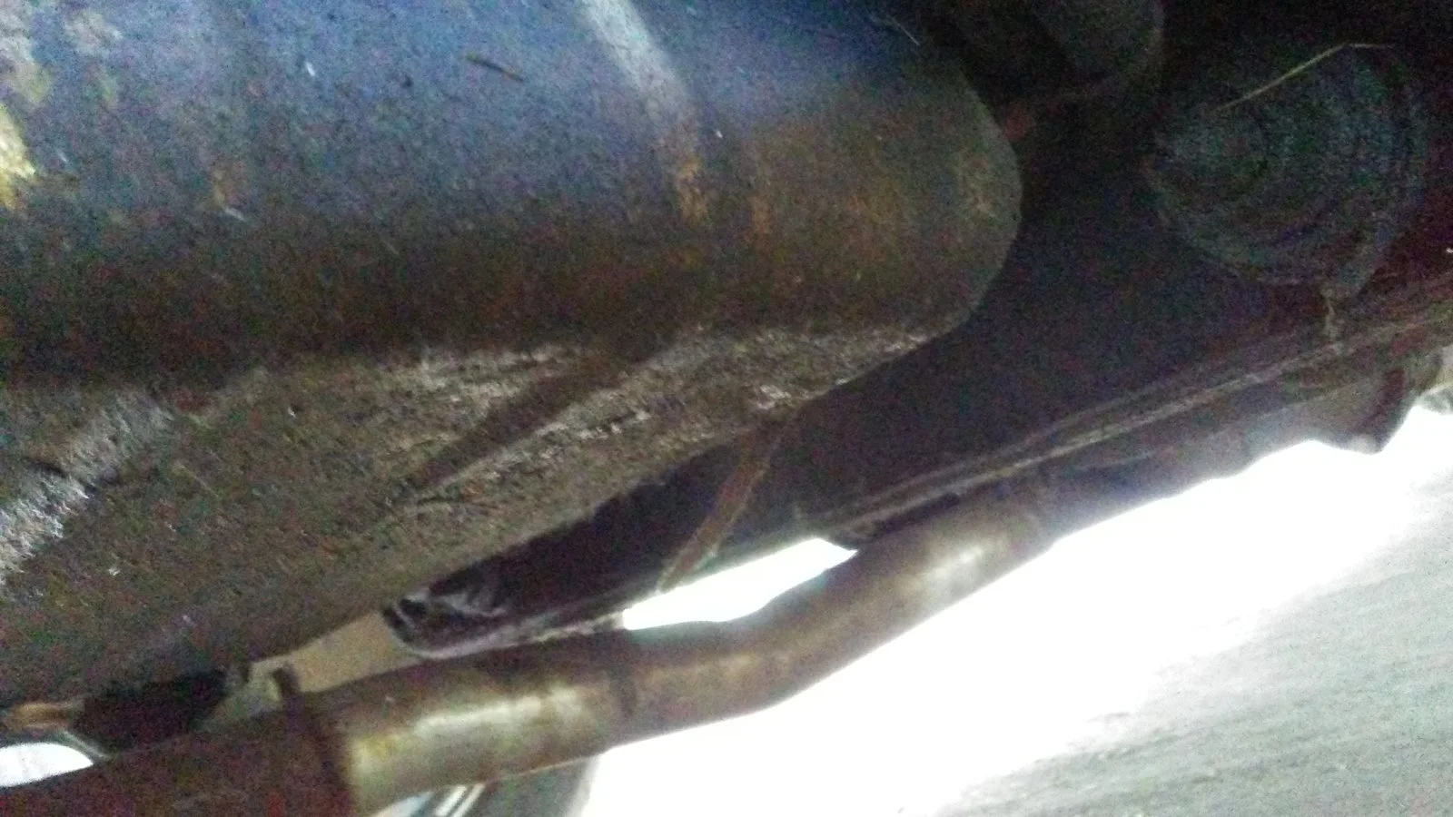

Showing why the header has to come loose again, as well as part of why the engine needs to be lifted. There are three bolts that hold the rack, and the rack isn't going anywhere from just loosening them, the stock oil pan is problematic, this big Milodon is a pain in the ass.

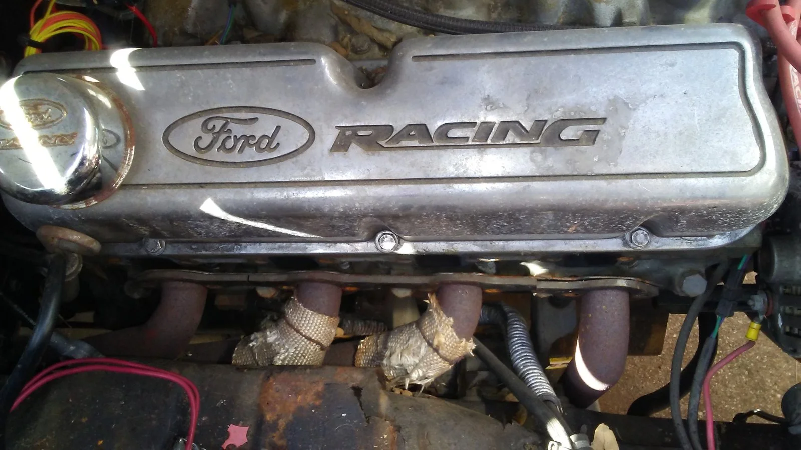

Header is loose, plugs are out, 20 year old fiberglass wrap is shredded... mission accomplished?

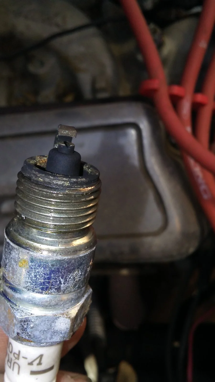

MSD Atomic EFI, how do I hate thee? Let me count the ways... or just show the world that my spark plugs look like they came from a carbureted engine tuned by a cousin-banging hillbilly instead of an EFI engine. Yeah, it runs that rich off-idle. Runs clean at idle, runs clean once you're turning some revs, but just off idle? Dual clouds of black smoke out the tailpipes and so much soot that oilfield trash in a Powerjoke would be envious.

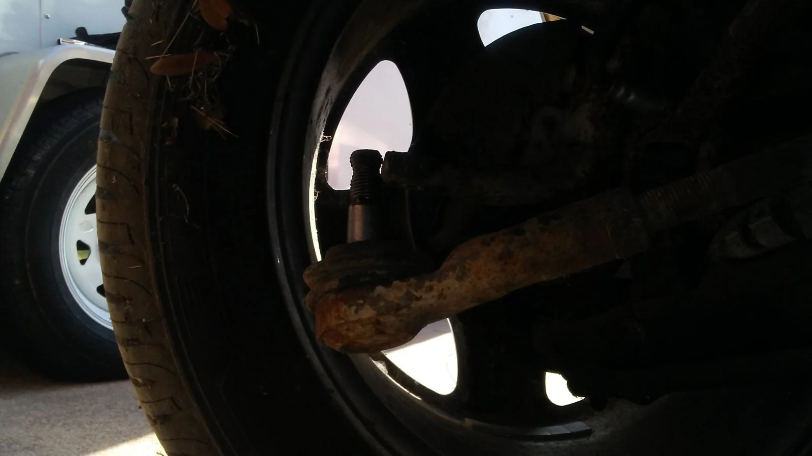

Tie rod ends, surprisingly enough, came out easy.
Got the engine lifted and started fighting with removing the rack. Took the two block-to-mount bolts out of the passenger side, and the mount-to-frame bolt out of the driver side.

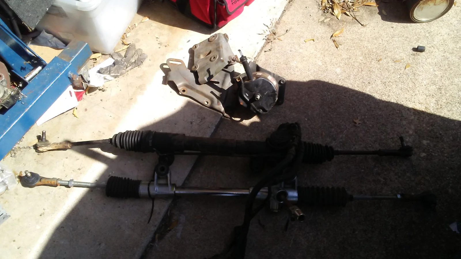

Old junk soon to find it's way onto Ebay.
More old junk soon to be Ebay bound.

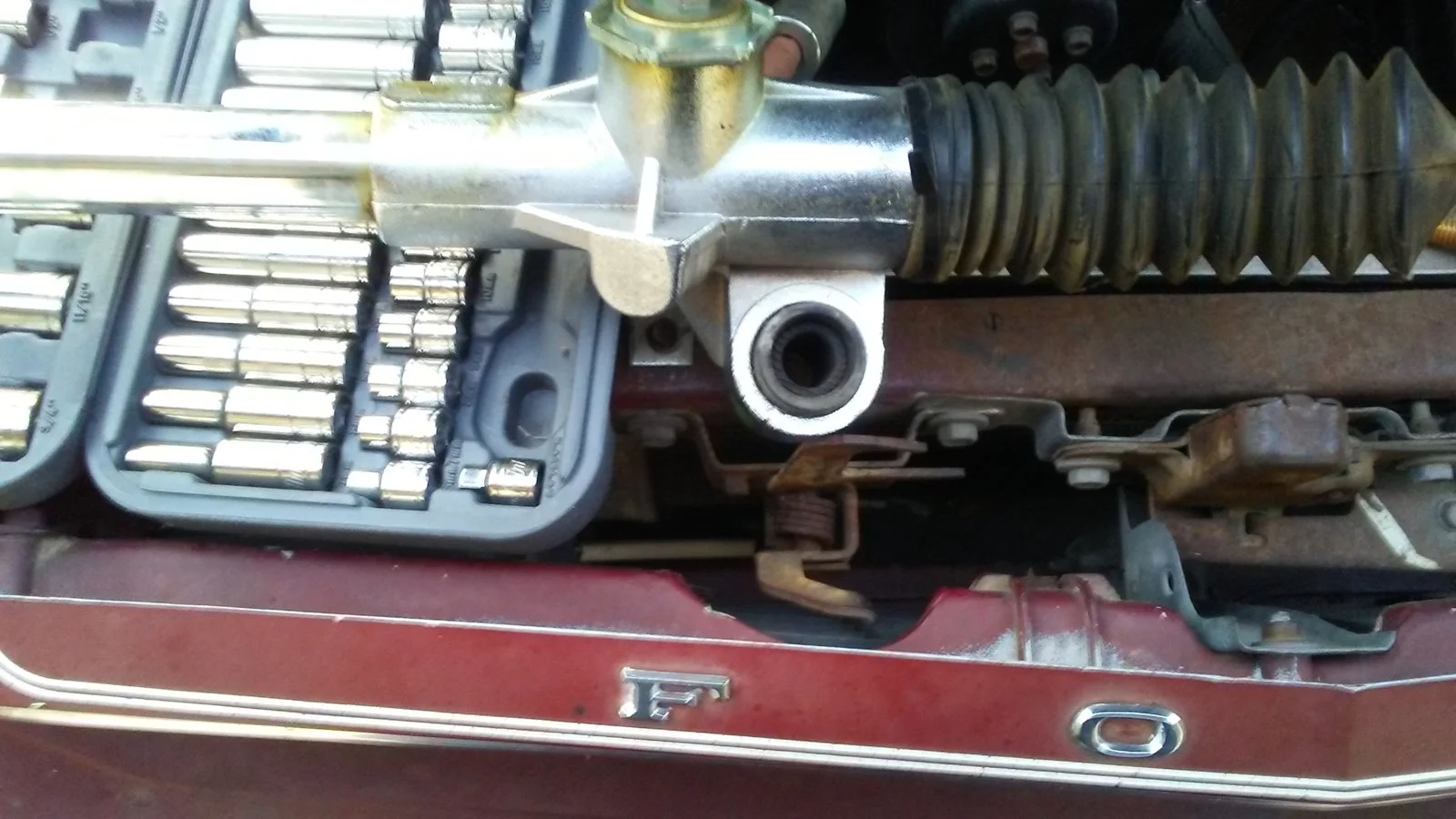

New rack next to old. I won't be using the chrome weld-on adapter that's on the shaft now, as the flex joint will bolt to the steering shaft and give more flexibility for the future powertrain plans which are currently top-secret.

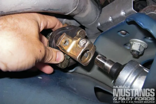

@74stang2togo Did you remove the bolt? I've been sitting here thinking about it for a minute.... I think the bolt for the clamp mechanism actually locks onto the main steering shaft through a half-moon notch in said shaft. Seems like I struggled with that for a little while thinking all I had to do was loosen the bolt, but it come apart pretty easily once the bolt was removed - you know since it wasn't physically stopping the removal of the intermediate shaft.... :cool:
I could be wrong and/or you could be done already! Better late than never - unless of course it's in this case!!
I dunno what vehicle this is from (looks like a Fox?), but this is what I'm talking about-
