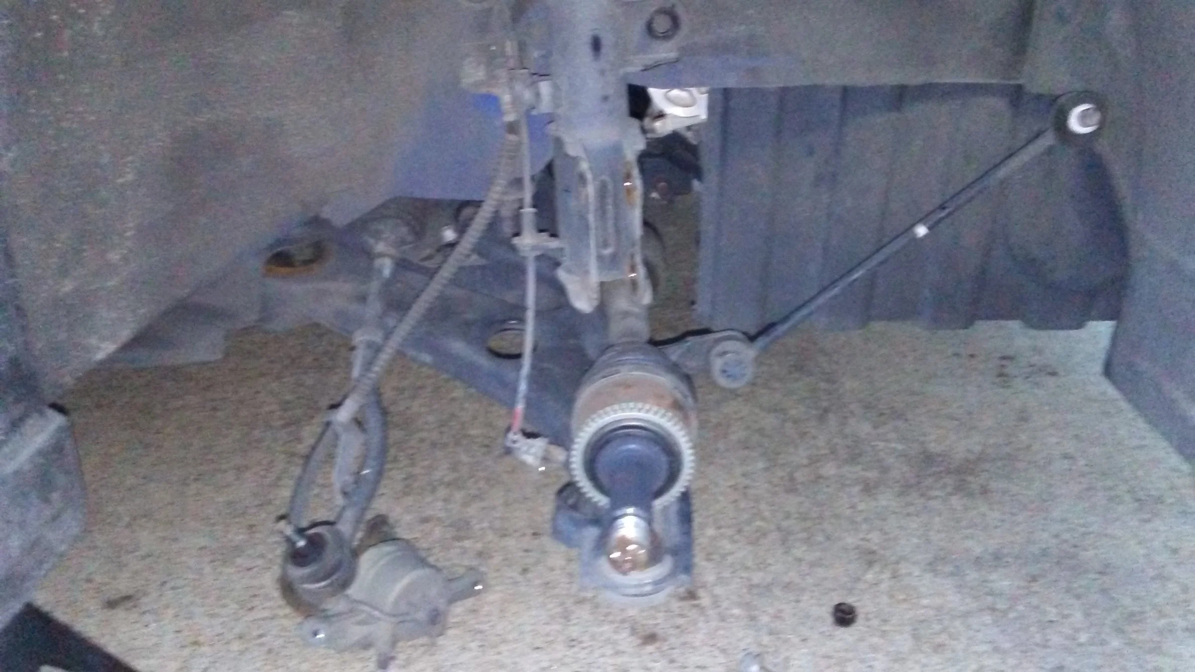

Thanks. Doing new hub assembly this weekend (had it almost all the way back together and one of the four bolts decided to crossthread... can't find a 12x1.25 tap anywhere in this damned town, mine is locked up in my toolbox 50 miles away, so I'm heading down there (on one of my extended days off for ASE testing, no less) to pick it up. Discovered a previous wrencher didn't install the brake hardware on the left front correctly, so I'm replacing that (how on earth do you screw up two pins and a spring on a fixed caliper?), new timing belt kit (with water pump), RF ball joint, and spark plugs are here (next weekend's project), then it's a fresh set of Bridgestones away from being the new daily beater. I'll have less than $1500 and two weekends tied up in getting it ready, so that'll be a $10,500 beater that would've retailed for $20,000 at my dealership (I love our employee discount plan on wholesale cars!)

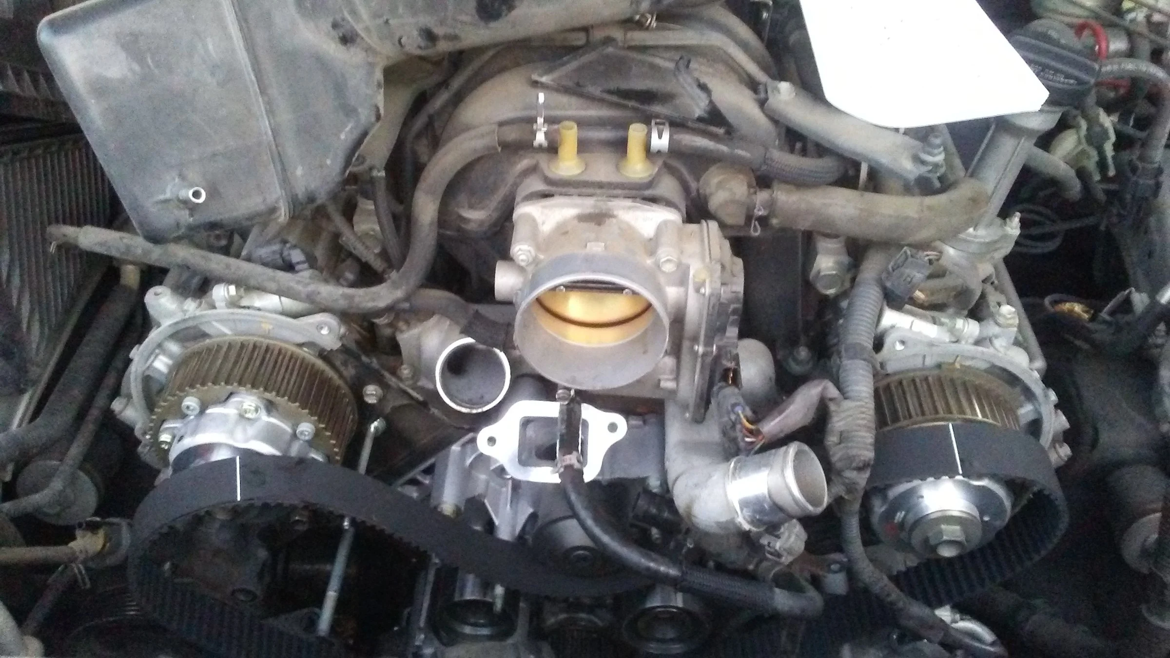

Timing belt time on the 'yota.
Not a difficult job, just time-consuming.

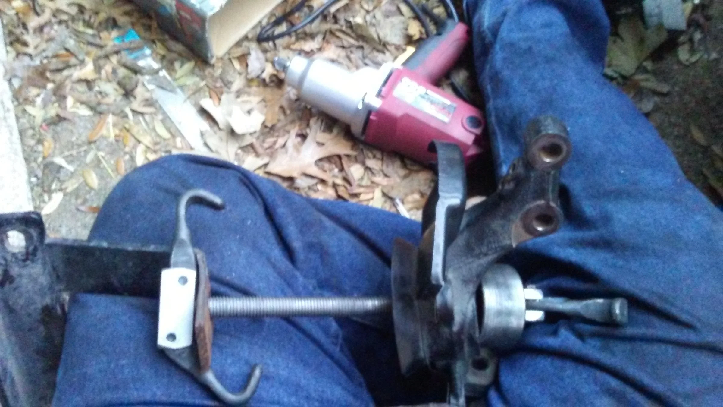

After a week where I broke two impact wrenches and a socket at work, I came home to do the wheel bearing on the Accent, and broke my press.
I improvised when it came time to reassemble.
The old bearing, a coil spring compressor, and the bracket for an old grille guard for a truck I don't have anymore. Don't laugh, it worked.

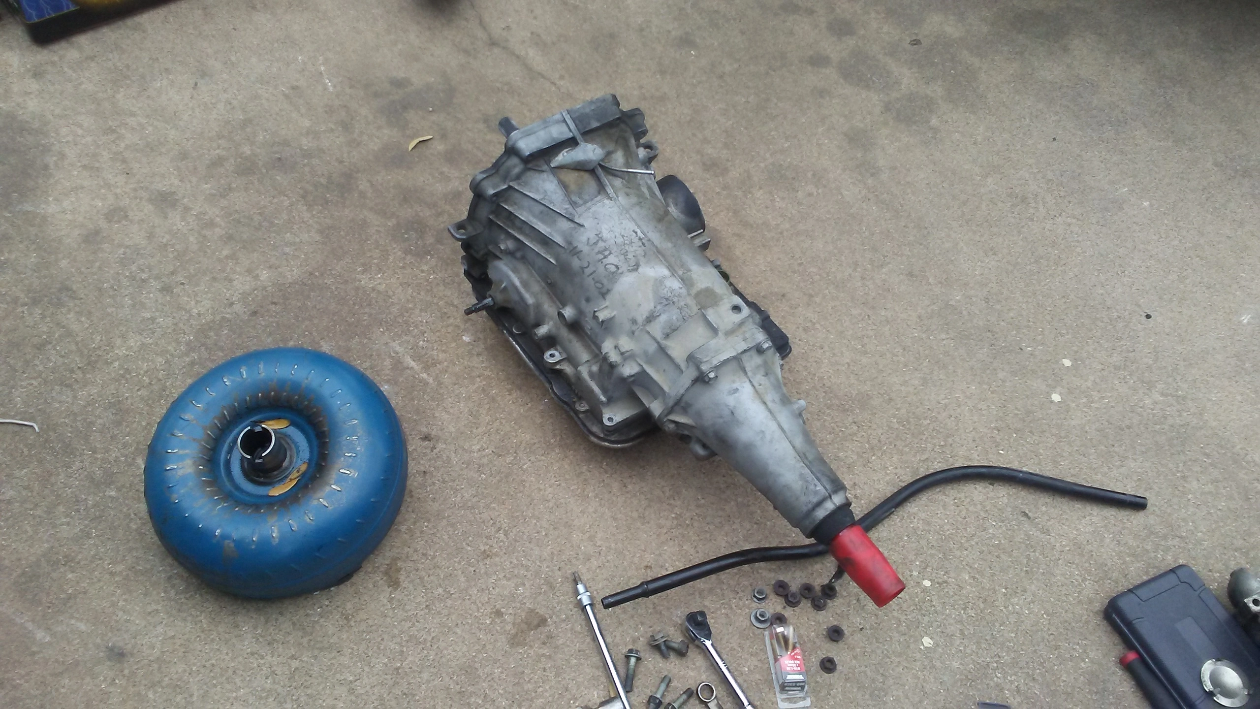

Spent all day Saturday on my back under my dad's Suburban wrestling out the "original" 4L60E that took a :poo: on him while pulling a trailer back on January 26th. I say "original" because we discovered during the removal process that we weren't the first ones in there (sloppy/lazy GM techs leave all sorts of clues, like a missing bellhousing bolt, and none of the electrical connector retainers put back through), and that the transmission and torque converter we took out were built 14 months after the truck itself (meaning it had a failure under warranty with it's original owner). Doesn't really matter, my dad bought the thing back in the mid 2000s and has put at least 120k miles of the 166k miles the truck has on it, so he got his money's worth from the original trans (for a piece of :poo: 4L60E anyway). All sorts of glitter in the fluid from the old one, and debris in the torque converter. The new Monster trans and Thor converter were filled and fired last night, we'll be going on a test drive with the 4Runner as the chase vehice at sunrise.

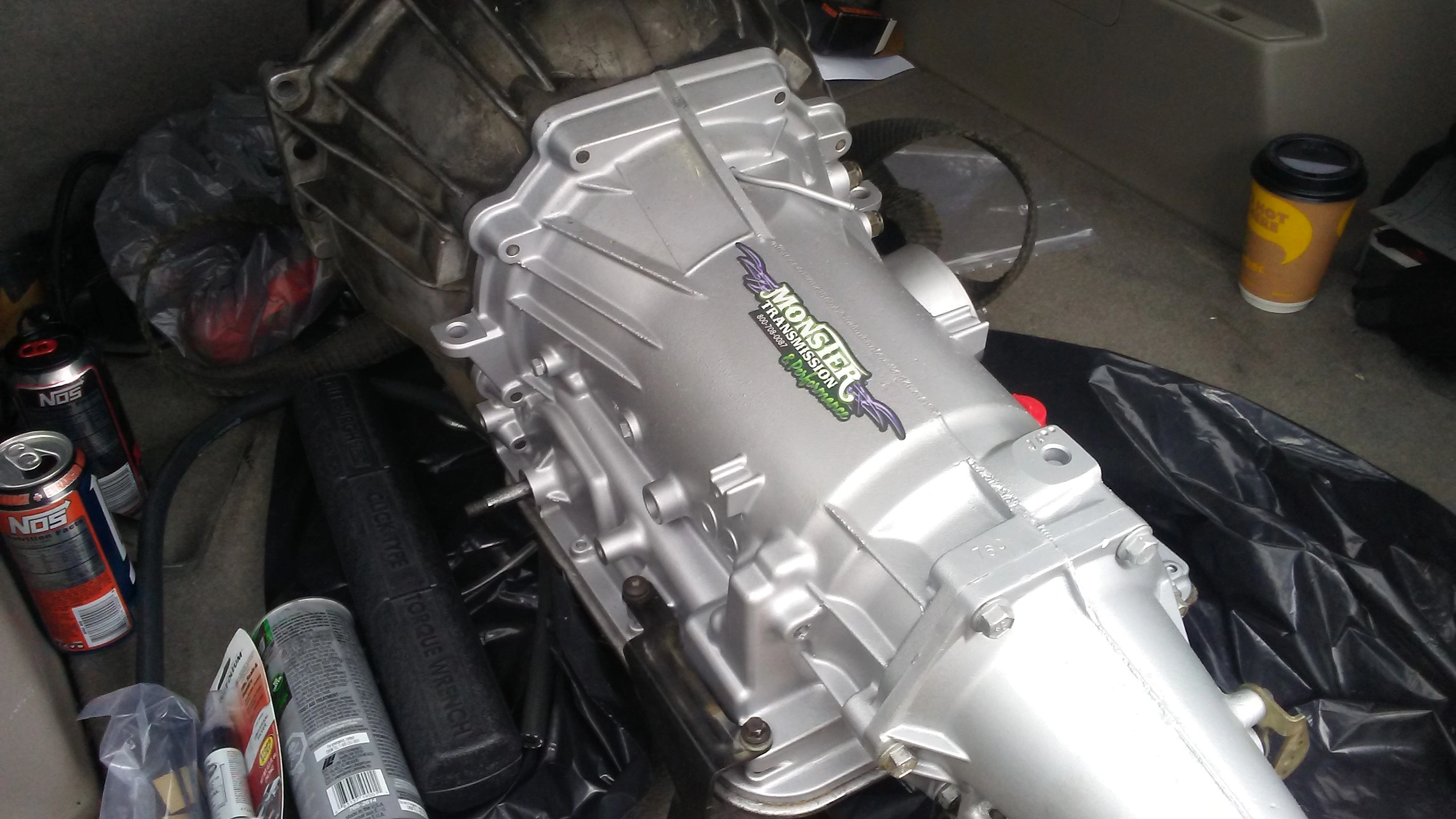

Okay, full details on the Suburban's transmission:
We installed the thing on March 12, as I posted before. Did everything by the book, hell, I even torqued the bellhousing bolts to spec. Flushed the cooler and lines, upgraded to the Derale cooler in place of the factory auxilliary cooler as recommended by Monster Transmission, fresh case of Dexron VI fluid, whole nine yards.
We test drove it on March 13 a total of 15 miles or so with me following in the 4Runner. No smoke, leaks, drips, slippage, or any other issues. Checked the fluid at three different stops along the way and let it sit and idle for awhile before checking it one last time, fluid level was perfect.
My dad went to go to a meeting in Waco with it, and didn't make it the 45 miles to the meeting before the "trans fluid hot" warning showed up on his dash. He let it cool off in a parking lot for awhile, then gently drove it back home. The "trans fluid hot" message didn't return, but the check engine light came on. I brought my scanner home from work the next morning and pulled a P1870 (transmission slippage) code.
We called Monster, and they wouldn't even talk warranty because they hadn't received our core yet. We wait for a week for the core to get there, down a vehicle yet again, and then they finally contact us back. Their "3-year handshake WOWanty" is as follows:
Monster Transmission and Performance will pay $50 hr labor and will supply the necessary parts needed for the repair at no cost to you or the client if needed.

If I'd read that particular bit of fine print before ordering, I would've ordered from somewhere else, but they make sure that's buried hell-and-gone on their website, and not anywhere near where you're looking at their transmissions.

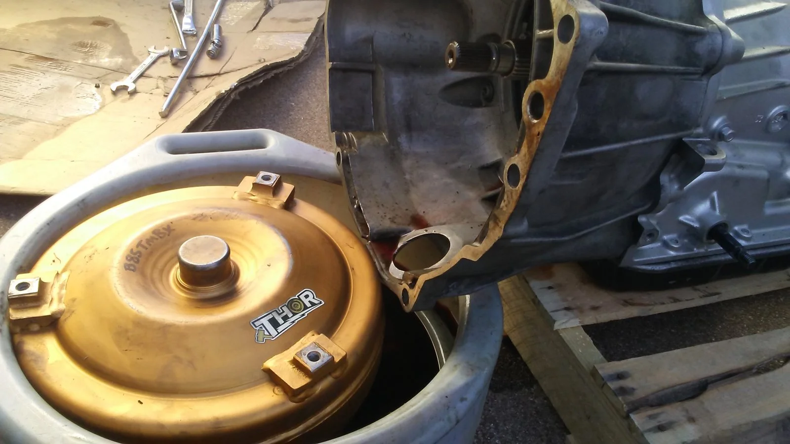

We take it to a transmission shop I've done business with before, pay out-of-pocket for diag, and their diag is that the transmission is fried due to improper assembly, that it's slipping in 2nd and 4th and isn't locking up the converter. Their only recommendation is replacement or rebuild.
So we call Monster, and they want US to pay round-trip freight on a defective unit THEY shipped us. My dad gets them to agree to pay half (if I'd been on the phone instead that wouldn't have happened, they would've been paying all), so I spent yesterday afternoon yanking their junk rebuild out of the Suburban.
