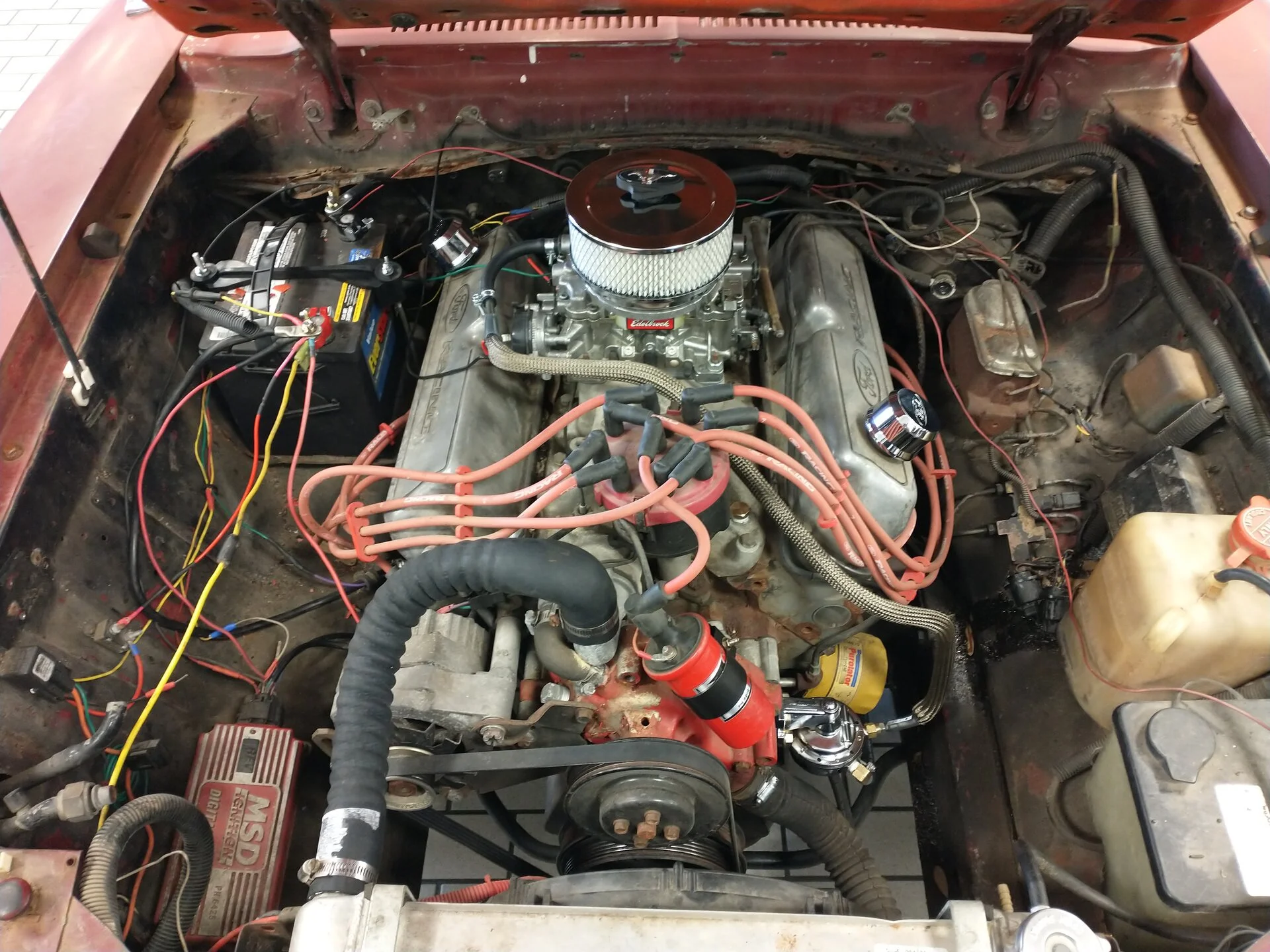

Air filter, carb, fuel pump, reb box thingy on left gone, lots of new/redone wires, new radiator hoses, valve cover breathers, improved coil mount/position, less grass and leaves, over all cleaner. Thats what I see. :shrug:
What they said and
we missed ground wire over alternator,
battery tie down,
green wire by MSD is gone,
weird manifold bolt stack,
insulated fuel line,
wheres the F-N solenoid?,
more :poo:ty wiring,
Valve cover breather,
dead rat cat piss smell gong away,
air in tire.

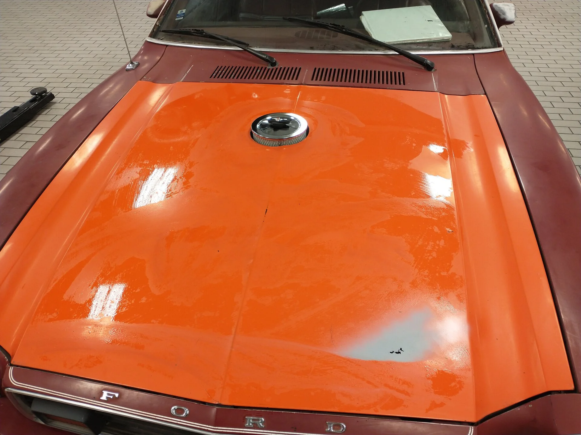

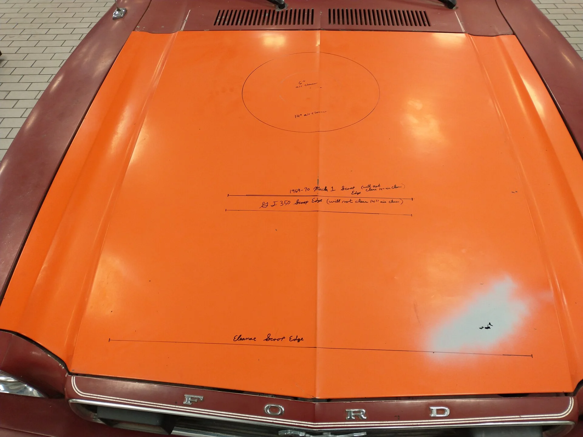

So... The new air cleaner doesn't clear the hood (not surprised), and this hood is a rusty old thing I don't have to care about anyway... So I've been plotting and scheming.

Not that you'll win any awards for originality, but the early Fox scoop will work. I'm sure you've seen the different pics of the hole I have in my hood that that scoop covers. Granted, you're not going to be able to run a high rise or carb spacer with it, but it'll work. The question will come up again once you throw that mod motor in there - I'm not sure it'll work with that either. But the 2 scoops you've written on your hood wouldn't work that way either..... :shrug:
