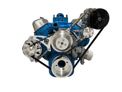

Small Block Ford 289 302 Serpentine Pulley Conversion Kit A/C & ALT SBF 1 | eBay
SMALL BLOCK FORD 289 302 SERPENTINE CONVERSION PULLEY KIT FORD ALT AND 508 SANDEN AC. NEW SMALL BLOCK FORD 289 302 COMPLETE FORD A/C AND ALTERNATOR KIT. CRANK PULLEY. WATER PULLEY. ALTERNATOR PULLEY.

The only absolute certainties at this point are that I will be ditching the GM alternator that's been on the car since I bought it, and that I would really love to do a smooth firewall when I re-wire the car... but I also want air conditioning.
