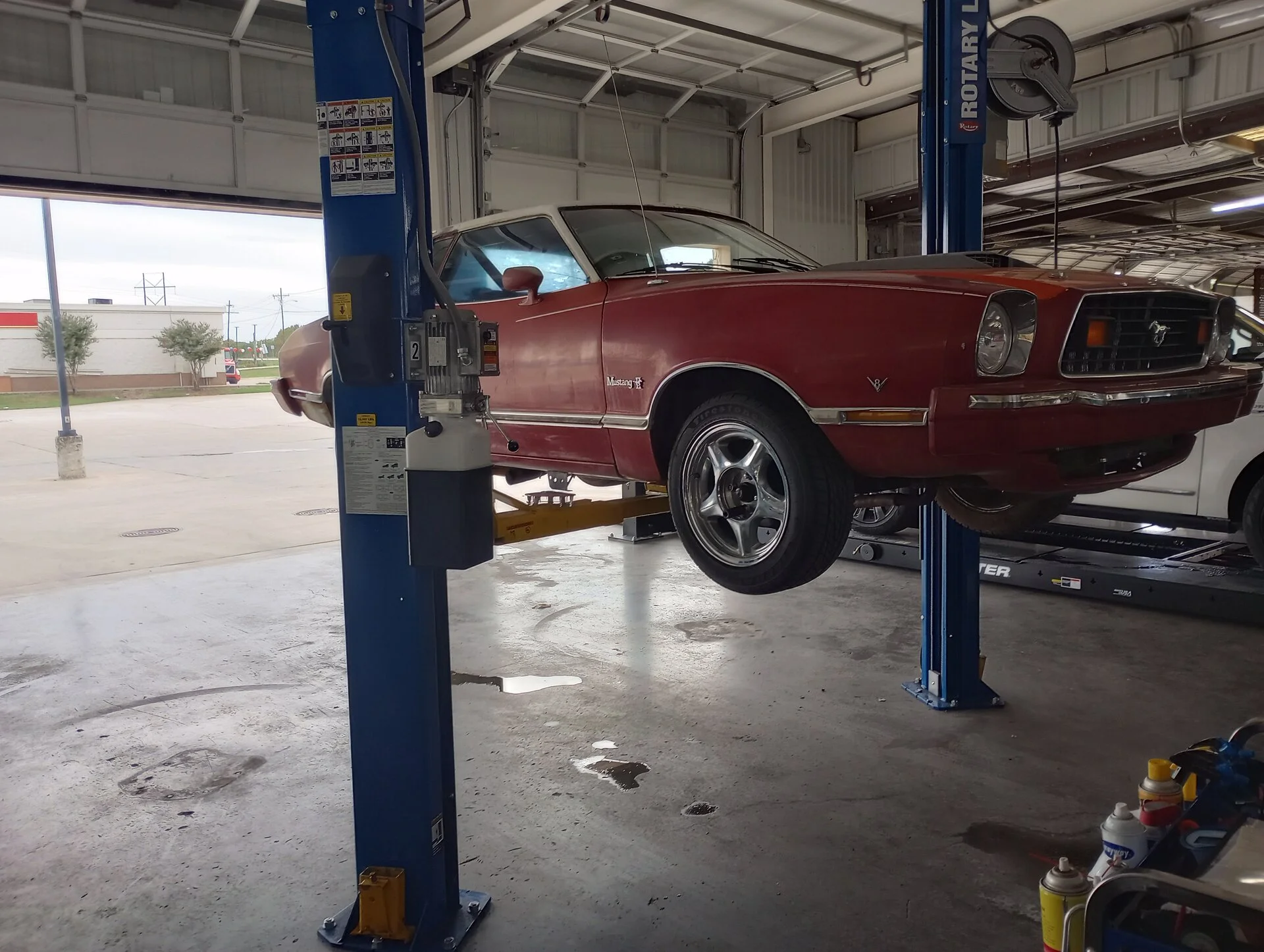

ESP is in the new shop for the first time this evening.
I had a chance to replace the 9-year old dry rotted Firestone 205/55/16s with a set of good used Kumho 205/60/16s for free, so I did. You wouldn't think an additional 10mm of sidewall between the ground and the wheel would make such a dramatic difference, but it does. I ran this size on my '76 years ago, so they'll be fine, I only went with the 55s to save about $25 per tire.
Gotta love free :banana:
We replace tires at 5/32" on used cars. One of these didn't quite hit 6/32" on the tread depth gauge, and the rest were barely at 6, so rather than the next owner of the Kia Soul they came from receiving a quote for tires when they come back for their first oil change and get mad about it, the used car manager and I decided to be proactive and put new tires on now. When it hit me what size they were, I asked for the old ones. ESP is lucky to be driven 100 miles a year, so 5/32" of tread will last a while. Bonus points for none of these tires having patches or plugs.
It was slow as hell at the shop this morning, so ESP ended up in a bay getting poked and prodded, trying to get to the root of the fan failure.
I have one of these:
I know how to use it.
I chased that gremlin from the battery all the way around the circuit before I found the cause of the blown fuse. A broken solder joint causing high resistance. A solder joint... that should never have been there, the very kind I rant against, that was only done because I ran out of butt connectors. That broken solder joint introduced high resistance between the battery and the self-resetting 30-amp circuit breaker that is between the battery and the relay, causing an excess amperage draw when the fan engaged (triggered by the temperature switch that grounds the relay).
At first everything is checking out fine but the fan. I even removed the fan and tested it outside of the vehicle with a good used battery I keep around, and found it to have one hell of a voltage drop when triggered with the power probe, but it's only drawing 10 amps, so I'm going to investigate that further later on.
It was only by a stroke of luck that I even found the bad solder joint.
So much of this car is "good enough for now" fixes that it's about time one of them bit me in the ass, but it sure was frustrating. That entire offending wire has been replaced by 6 gauge cable with properly crimped and heat-shrink-wrapped ends!
