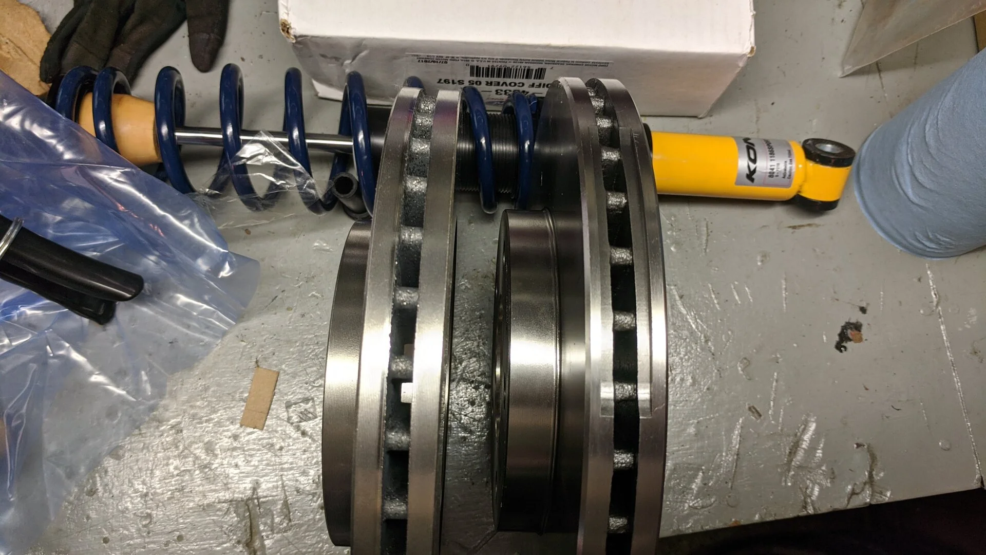

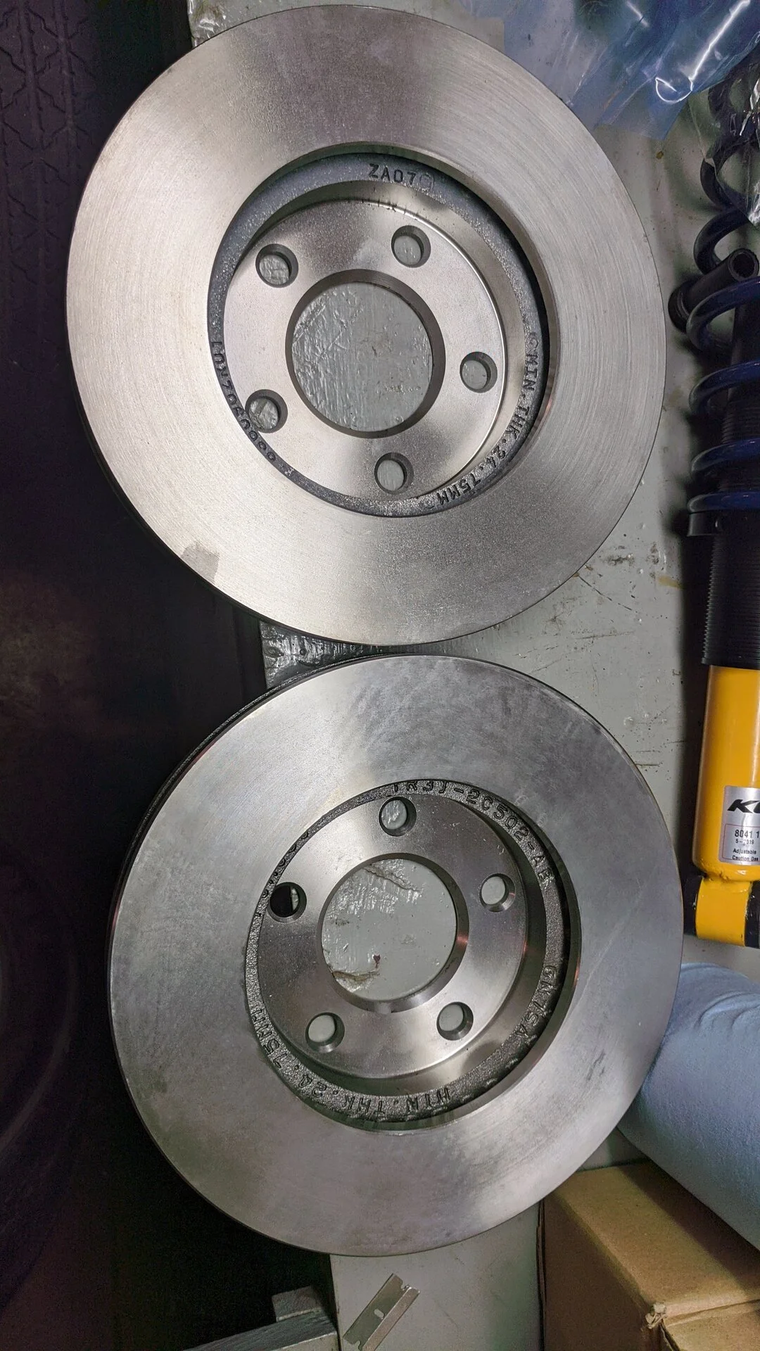

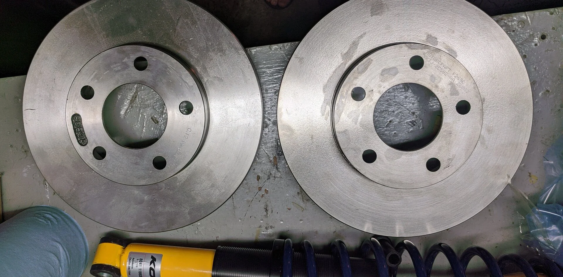

They are a bit more different than a coating. A bit too different for me to run them comfortably. Here are some shots of the rotors themselves, as you can see the castings themselves are different and the one that came in the plastic bag is the prettier of the two on the right.
198 is the rotor the Ford Dealership offers though they gave me when I told them where I got the 54 from. Anyone need a BRR-54?
Wayne Waldrep
Before I post a pic, do you have one of yours?

I'm blind....I see no difference...lol. Seriously..I don't.

Yeah there is 90% chance I am overthinking this but I have completely swapped my entire suspension, third member, as well as braking and steering systems since the last time I drove this car. If swapping a single rotor gives me that much less to potentially troubleshoot, I think its worth the effort.
