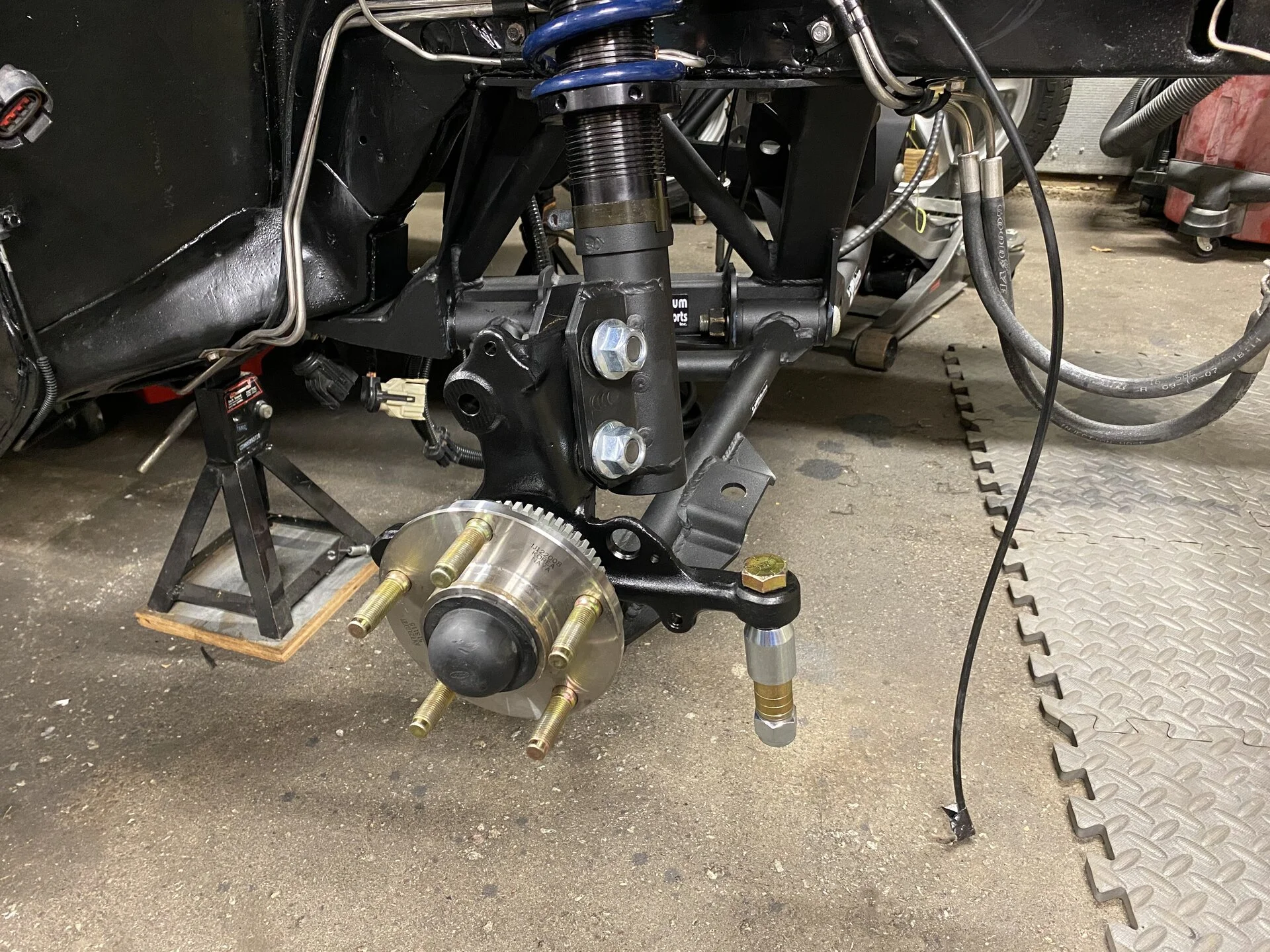

Negative. They are sold with the rings only. You can easily pull them off as they are a light press fit, or you can leave them on and they don’t interfere with anything

Different spindle so I would assume not. Would need to see if it’s the same part number, but wuick look suggests not.
Why the adversion to the abs tone rings? They just pull right off.

I think they look funky... If they pull off I can deal with that..TY.. I was looking at some ( 04-08?) that didnt' have them and since I am going to have to buy some new hubs and if these are the same hubs without the ABS rings why not?.....

They pull off very easily with a 3-jaw puller, or just cut them and split them off. I actually just removed a pair off a junk set
They aren’t really all that visible, especially once the rotor is in place.
