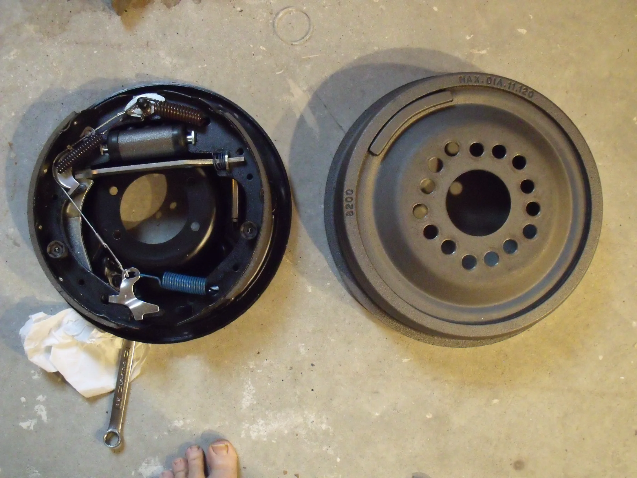

This Drum/Backing plate/ shoes and hdwe was a package I purchased at Quick Performance for the 9 inch installed in my 83... this conversation makes me wonder what size these cylinders are??
They are 11" drums

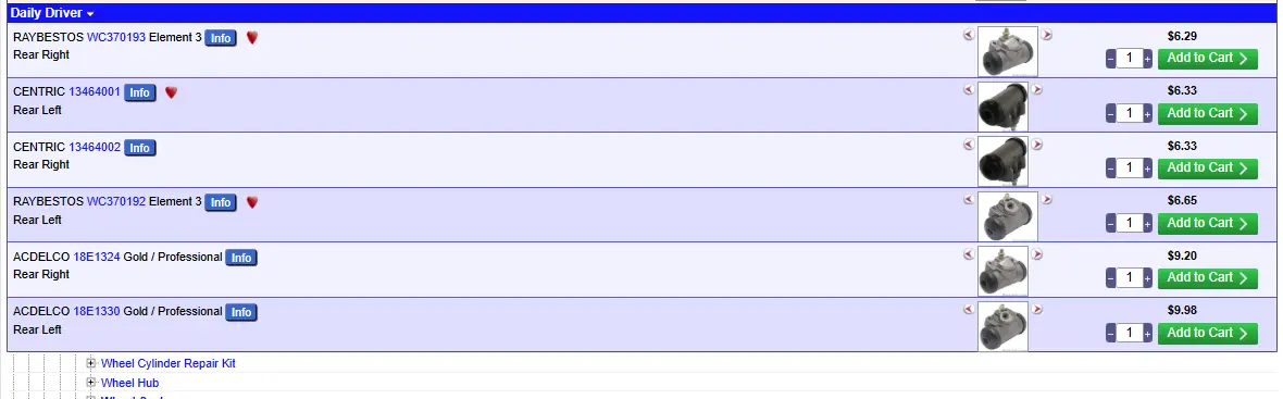

Mustang5L5 said:
‘89 Ford Bronco had the 15/16” wheel cylinders.
Thing is I don’t know the compatibility with the Mustang drum brake. Given they are $10 each on Rockauto, might be worth buying one to test out.
I have purchased the WC34876 and WCA37862 in hopes that maybe I am getting it right, but I don't think I am. The old thread on the Corral calls out for WAGNER WC 34876, but it doesn't seem those are 15/16"....maybe it was a typo and the upgrade is supposed to be a 13/16" wheel cylinder?
I show 13/16 for those part numbers.
These are the ones I see calling out 15/16" bore. For a 1989 Ford Bronco.

Yes, thank you, I did see that on rock auto as well. I'll try to grab a pair locally, but still would like to be 100% sure about this. I am doing this for the possibility, if I upgrade to the SVO front calipers on my '91 GT.

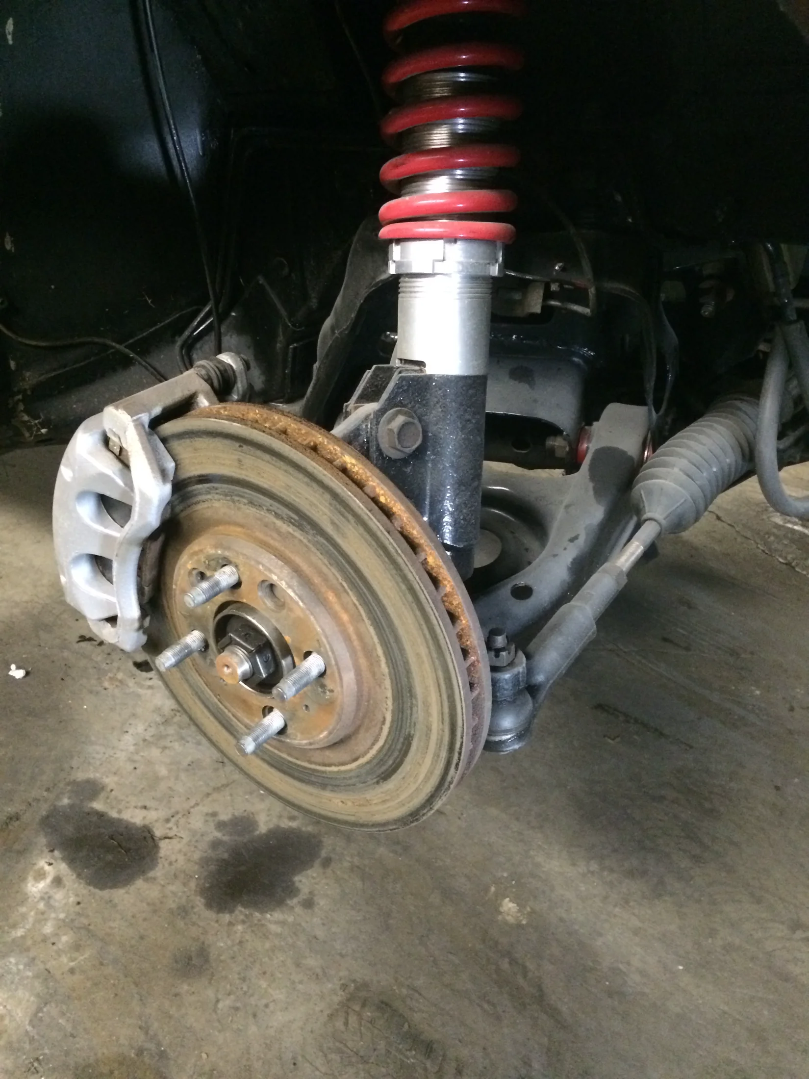

Calipers and rotors are both from a Lincoln LS/Jaguar S-type. Calipers are similar to the Mustang PBRs except the pistons are different. Mustang caliper is dual 45mm pistons, Lincoln/Jaguar is dual piston 45mm/38mm.
For hub I used one from a 89 Thunderbird (5x108 and smooth backside of hub) and re-drilled for 4x108. I did the same with the rotors as the Lincoln/Jaguar is also 5x108. I used them for 4 years before switching to 5 lug. You can get OEM 5x108 rotors in many sizes up to 15.75" diameter (I have a whole list if needed).
If you wanted to keep 15" wheels you could get front rotors from an 89-97 T-bird, they are dimensionally identical to OEM SN95 rotors except they are 5x108 bolt pattern, then redrill them to 4x108. SN brakes, spindles and keep your factory 10 hole or turbine rims (I will be doing this someday with another project).
94/95 spindles will only move your rim out 1/8". If you relocate your lower control arm inboard for better suspension geometry you will actually be in under the fender more than you are today.
