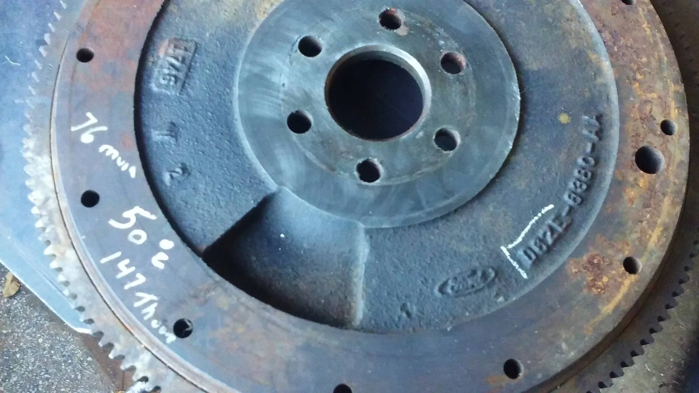

The more research I do, the less hope I have. The 302 I have is a 1985, on the flywheel someone had painted it 76 Mustang "50oz" but the part number (which cannot be found anywhere in the internet) dates it as a 1976. The part number is D6ZE-6380-AA. So if the part number is correct the imbalance would be 28oz instead of the 50oz I need for the later engine, unless this is some type of aftermarket speed part which I highly doubt. Ugh I think I'm going to scrap this trans as I have these issues and haven't even figured out which starter if available will work.
Here's a picture of the flywheel

It is possible that someone had the flywheel rebalanced for the 50oz engine. It's been a while since I've looked at mine, I don't remember if mine has the same larger hole at 3 o'clock in your pic. There is definitely some research that needs to be done! As for scrapping the transmission - they aren't known for holding up to a strong 302 very well. If you want to keep the manual transmission, a T5 isn't a really hard swap. Many of us have done it and can give you a rundown on what you will need to do if you choose to go that route....
