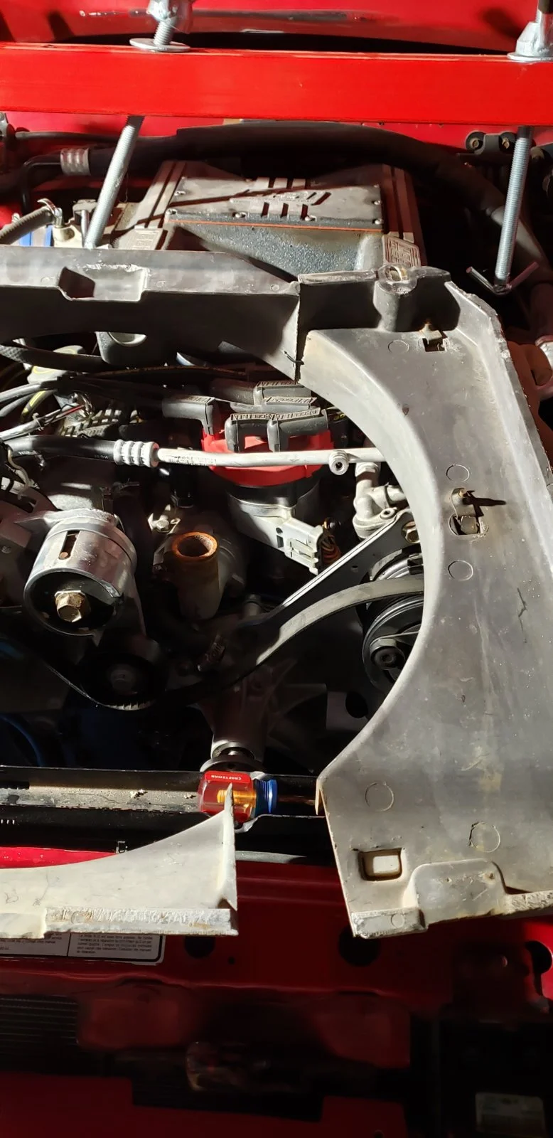

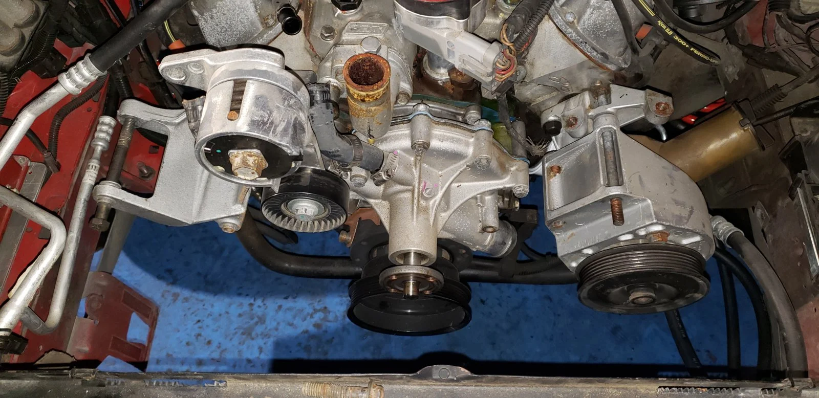

Here lately it seems like I can only get out and work on the car maybe 30 minutes a day if I'm lucky. I'm making very slow progress, but I am getting a little done. I drained the coolant the other night. It's impossible to drain my radiator without taking a bath and getting coolant everywhere, but I was able to catch most of it to reuse. It barely has any miles on it. If you guys think I should just change it feel free to chime in.
Here is where we are right now.

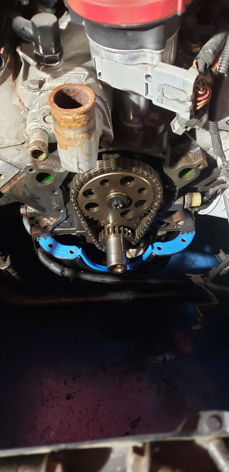

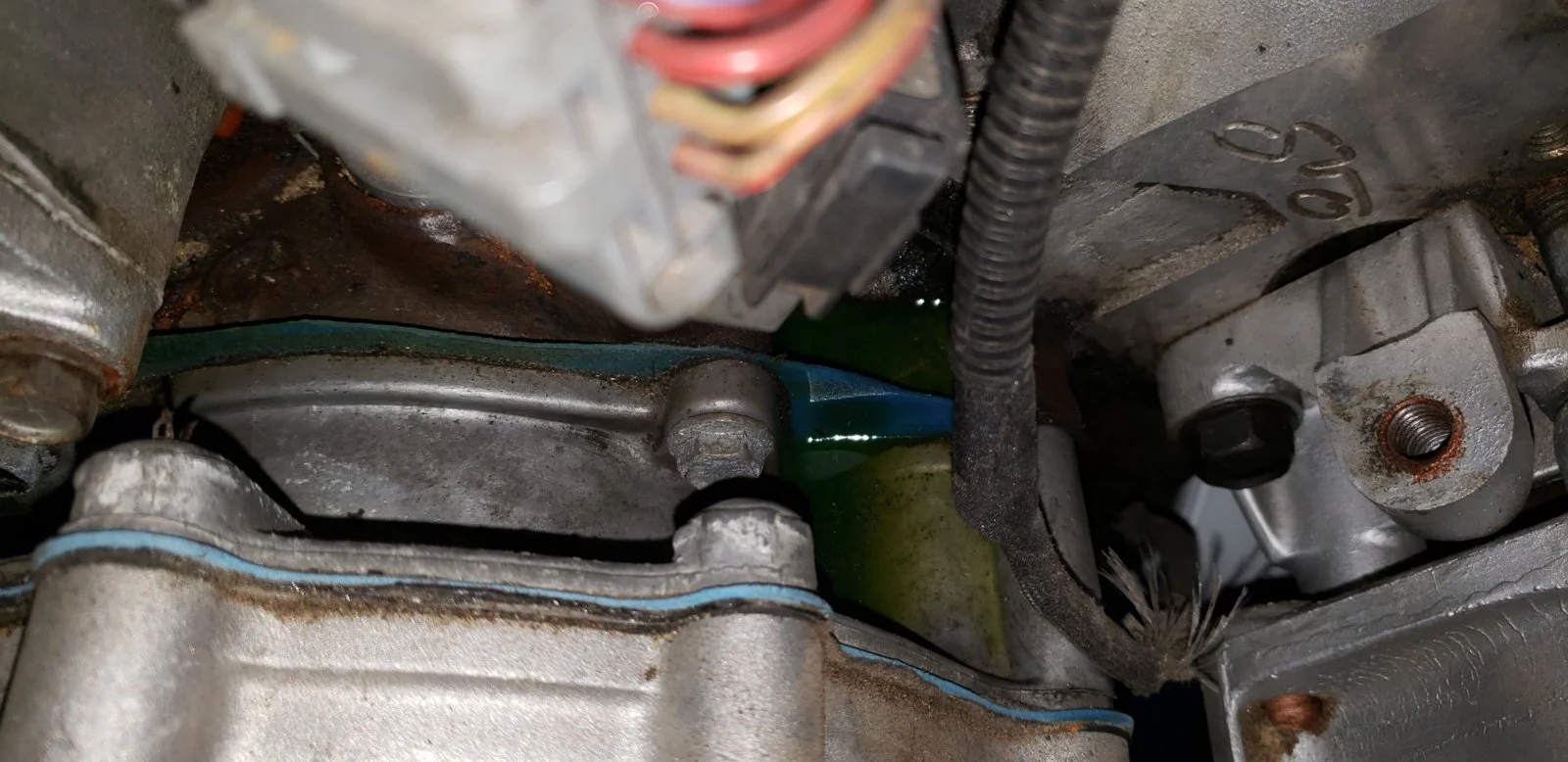

You can clearly see behind the water pump coolant is pooling on top of the timing chain cover.

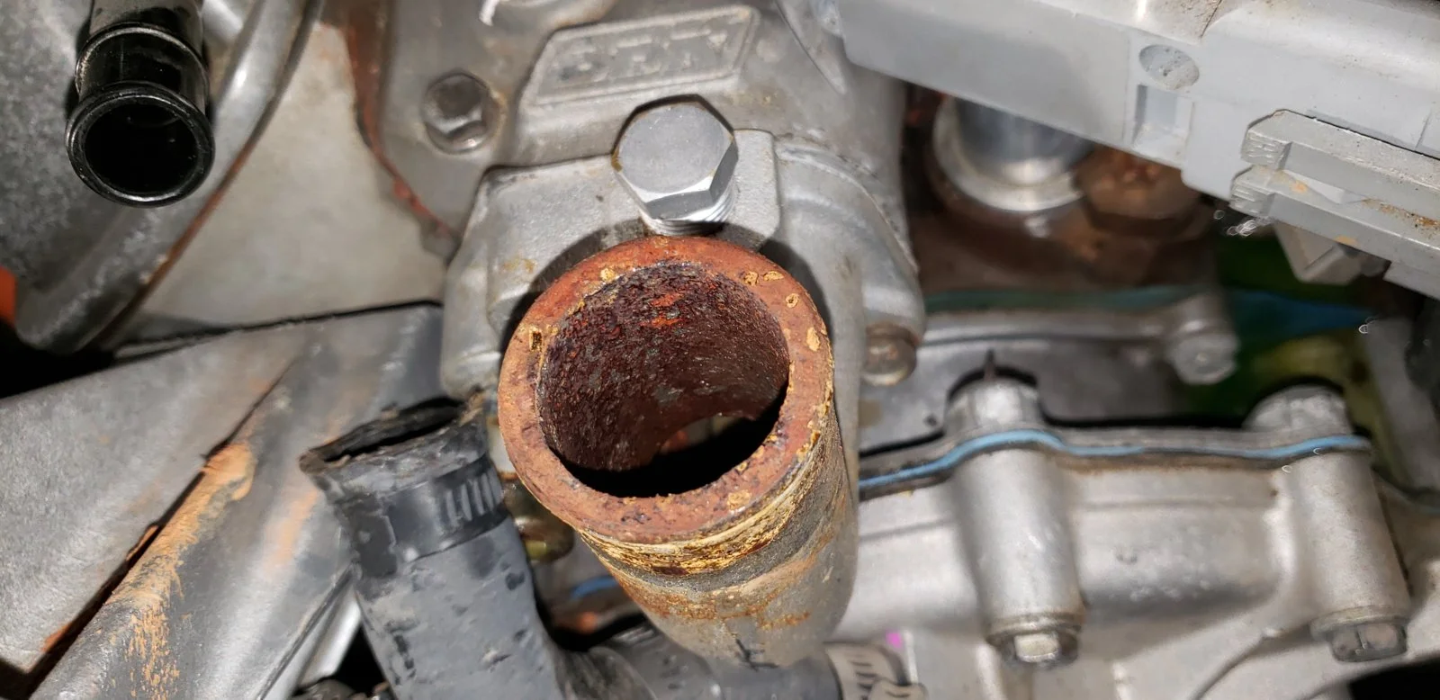

What did surprise me was the thermostat housing.
That thing is new as of a little over a year ago. I think. I changed it out, but don't remember exactly when. No matter what it barely has any miles on it. I got it from Rock Auto I believe. I also remember using distilled water to fill the system. At this point I'm debating on ordering a new one and just biting the bullet, paying extra and getting an aluminum one. What do you guys think?

Stupid is the gift that keeps on giving sometimes. I got everything cleaned up and had my fingers crossed that I could put the cover back on without having to drop the oil pan. I've got a one piece gasket on the pan, so the part of the gasket that goes under the bottom of the cover against the pan is part of the one piece gasket. I'm not going to cut it as that would defeat the purpose of the one piece gasket. The problem that I'm running into is that the gasket is getting pushed back into the pan as I try to install the cover.
At this point I have loosened the motor mounts and I'm using my jack stand to lift the motor up a little. If I can tonight I'll take all the bolts off the oil pan and try to pull it down a little. The kicker is if I do that I need to pull the entire oil pan gasket, clean up the mating surfaces, and reinstall the gasket. I used black RTV to seal the gasket. I was planning on using the red anaerobic gasket maker this time.
I'm open to ideas on how to do this without pulling the pan. I even thought about trying to place fishing string across the gasket so that after I set the cover I could try to use the friction of pulling the string to drag the gasket into place. I'm not very confident that that would work though.
You should be able to loosen the front oil pan bolts and then progressively loosen the side oil pan bolts and not loosen the back oil pan bolts keeping the seal in the back. This should give you enough flex to get the timing cover back on.
If not, then you need to drop the whole pan, install the timing cover, then put dabs of sealant on the front and back, and finally reinstall the oil pan again.

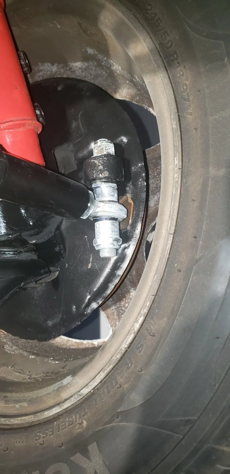

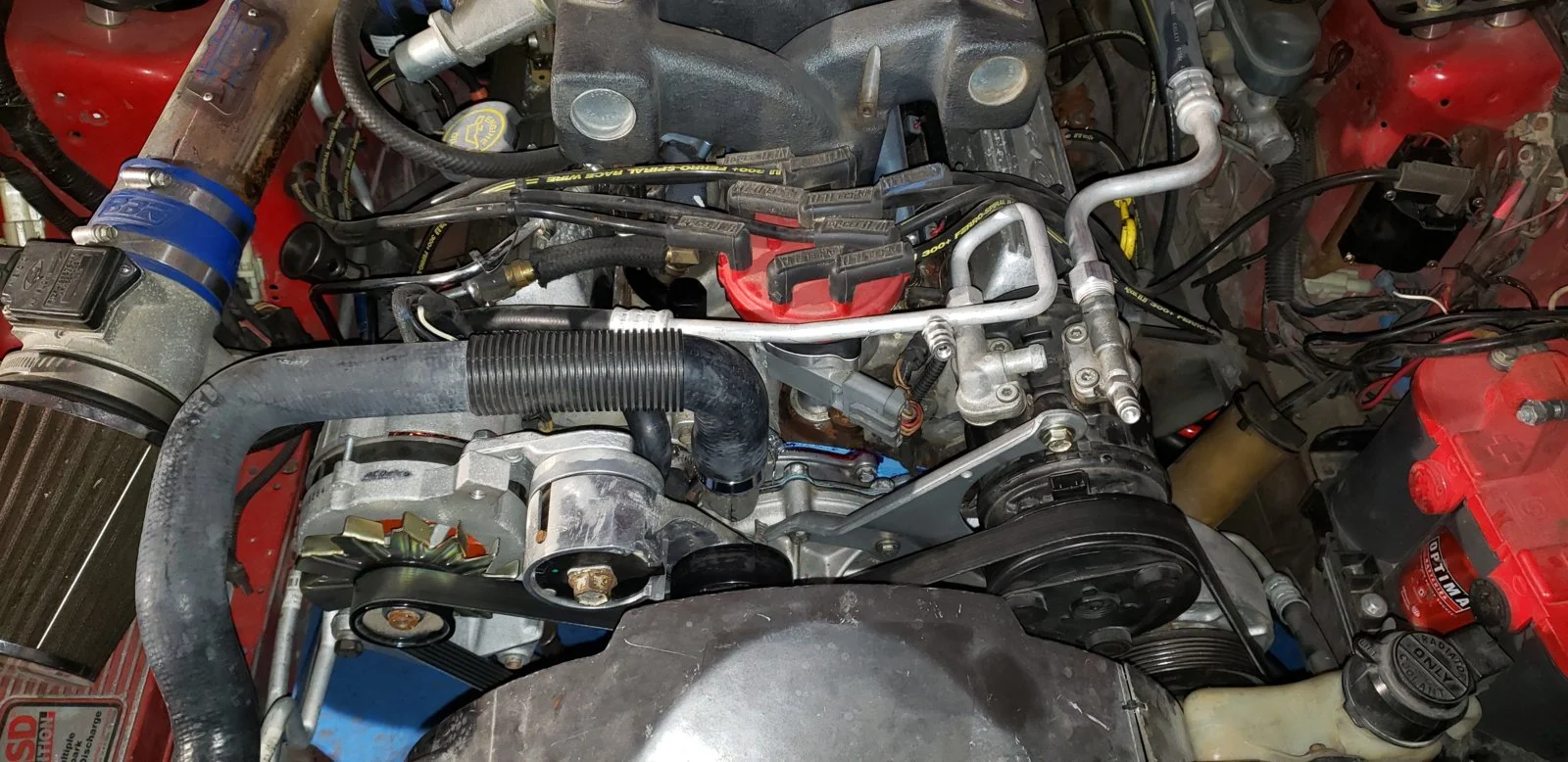

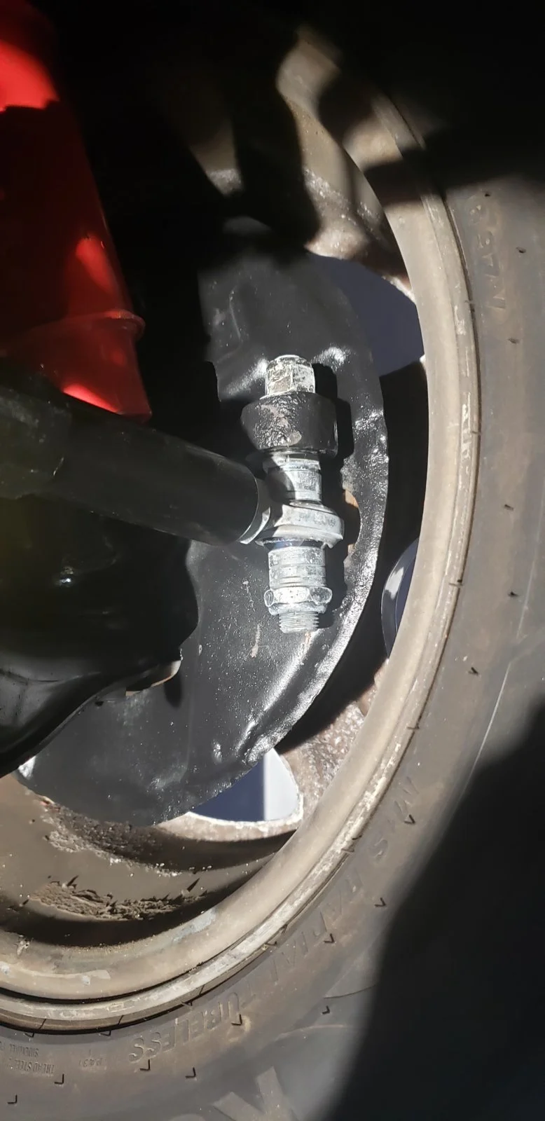

Moving along on putting everything back together at this point. An observation though. I installed a SVE bumpsteer kit a little over a year ago and really haven't driven the car more than 100 miles. I'm sure they are fine as far a function goes, but I'm surprised they oxidized the way they did.
At this point it is all back together! I filled the coolant system last night, so I'll check it tonight and make sure it isn't still leaking into the oil pan.
I'm not sure why the previous owner did this, but I'll probably get a new OEM shroud at some point.

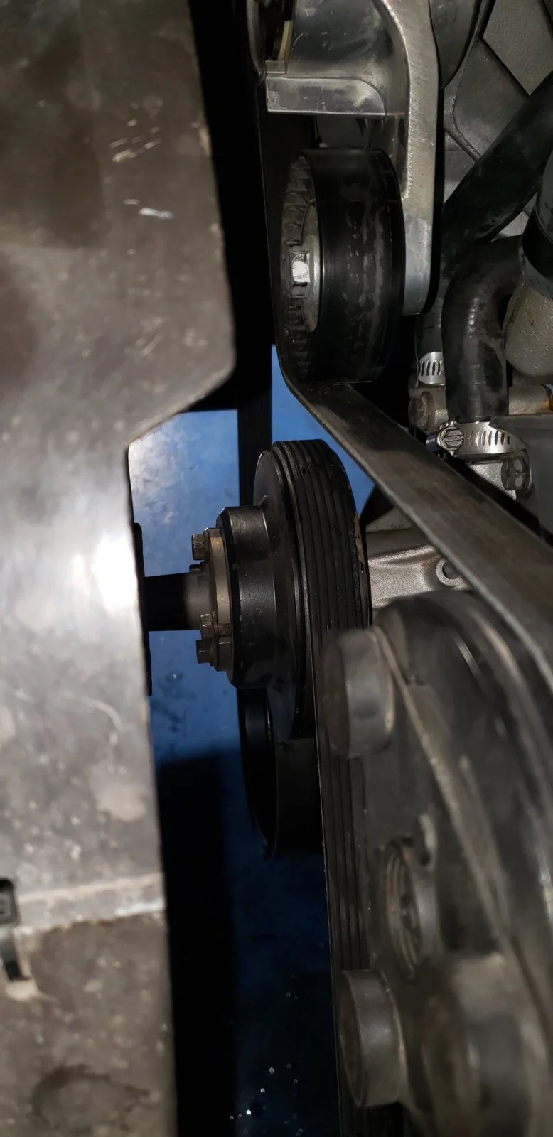

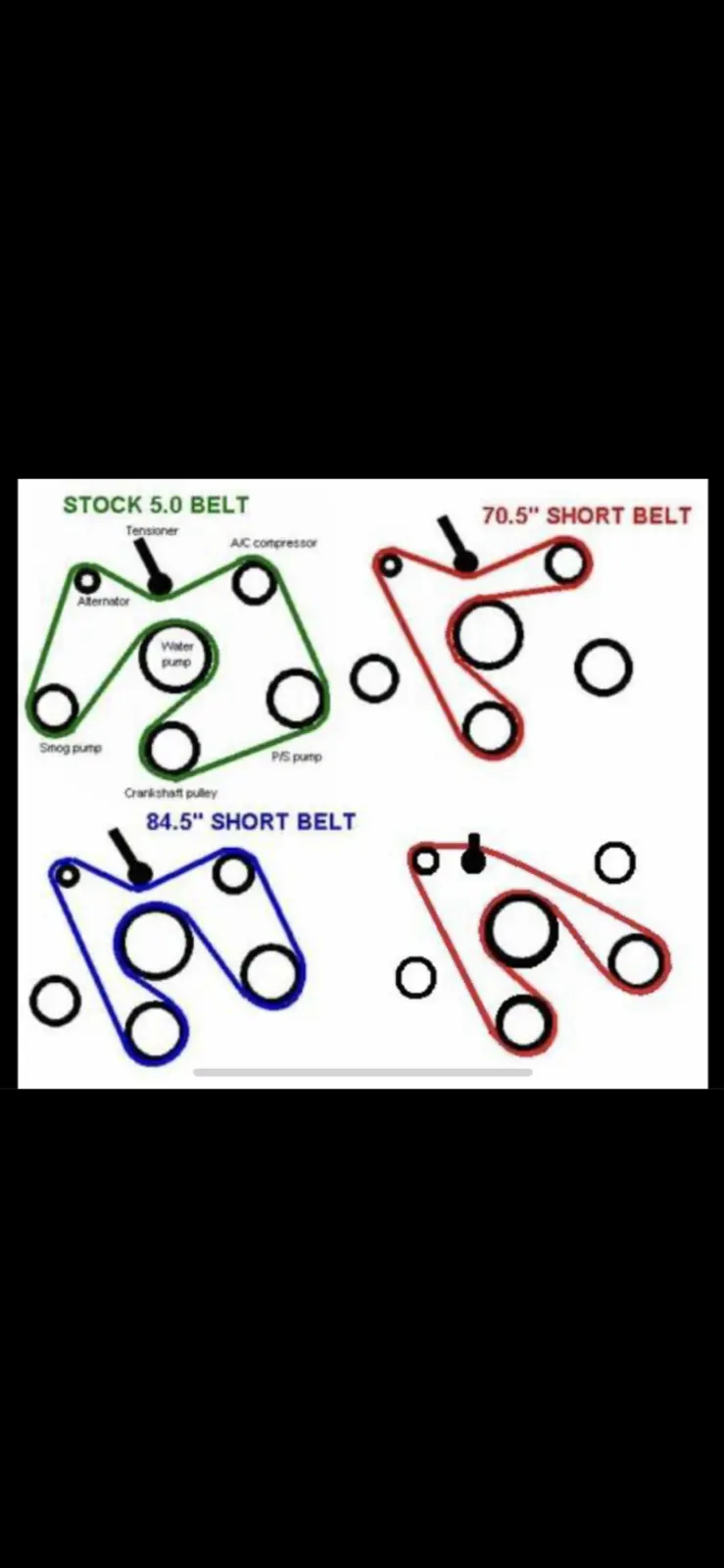

Something that I noticed last night while installing all this stuff is the belt goes around my water pump the opposite it would if I had a smog pump. This might be a dumb question, but is my water pump spinning backwards? I did notice when it was running that it didn't cool the best even with a new pump.
How did you swing that new of a car and the insurance in high school? (Insert a Jealous emoji here) I had a 27 year old car that looked cool but was a slow six cylinder. I did not get a 5.0 Mustang until partway through college, and it was a 12 year old one from one of my dad’s business friends who “upgraded” to a turbo Probe for his traveling sales job.
Yeah, I was just looking at drawings online and it appears to me that even though it is routed different it is still spinning to pump in the correct direction. I think I'm making mountains out of mole hills over here again. I just saw it last night and it got me thinking is all. Thanks for the responses.
