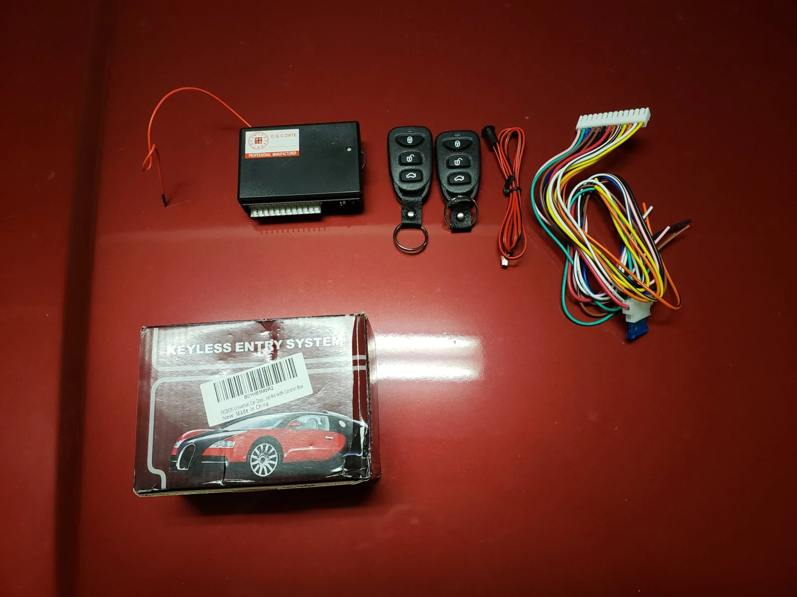

This is the keyless entry kit that I got off of Amazon.

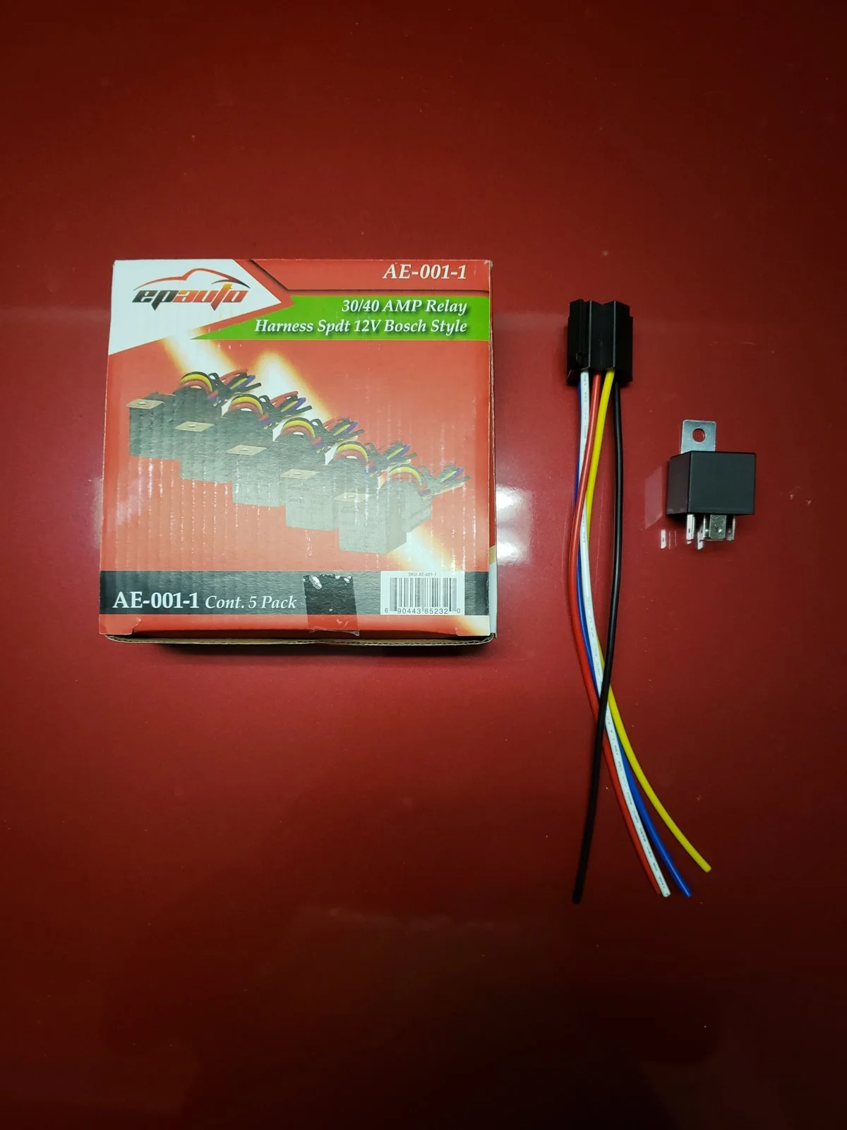

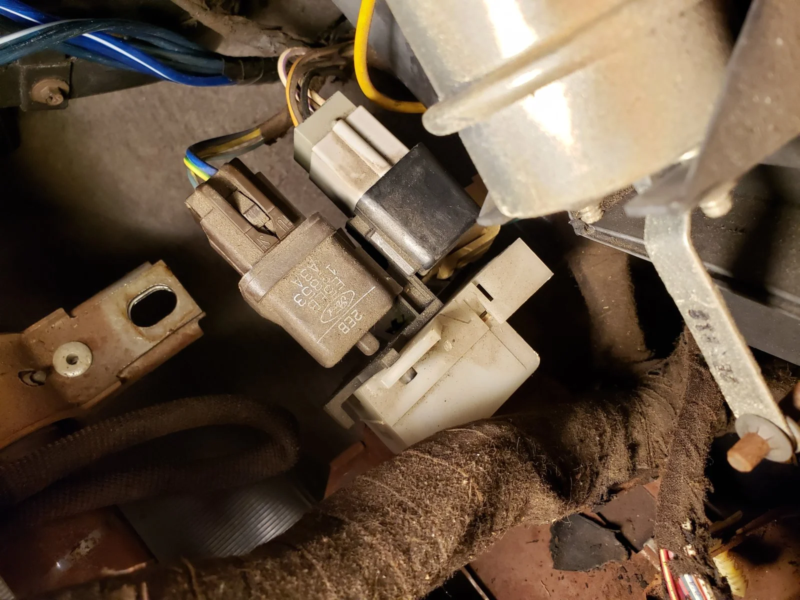

And the relays.

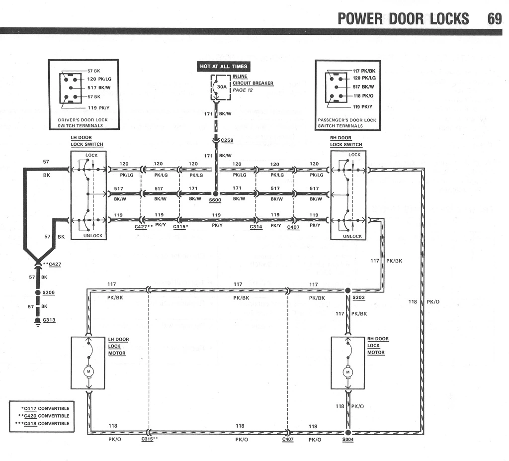

After doing some digging around on the site I came up with this helpful wiring diagram.
From everything that I can come up with the motors are grounded by attaching them to the door frame. There is constant hot going to the lock/unlock switches. When you hit lock or unlock it sends positive voltage to one side of the motor or the other. Depending on the side it either locks or unlocks the doors. Simple enough. The kit that I bought sends an impulse signal, but it can take the voltage, so you need a relay. I found this diagram for wiring up the relays.

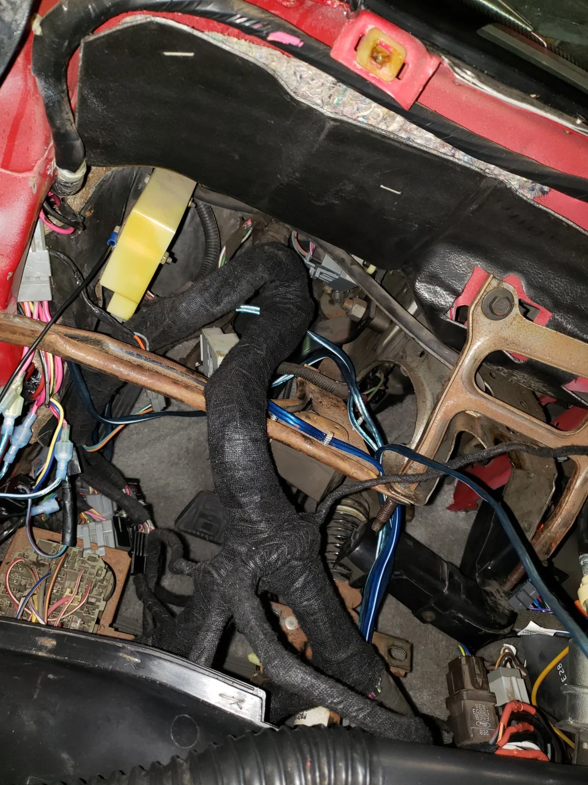

Soooo, last night I wired the relays up as shown above and spliced them into the factory wiring harness. Keep in mind that my harness had already been hacked before it got to me, so I wan't doing any new damage. I wasn't trying to do the permanent install, just see if I could get the unit to lock and unlock the doors. The factory harness wire is #10 or #12 wire intended to carry a higher load. All I had on hand was some #16. The intent was to use it once or twice then do the permanent install with heavier wire. Long story short it didn't work. When I hit the drivers side lock button in the car it straight smoked the wires on the relay, burned the rocker switch up and locked both door lock actuators in the locked position. Thank God I had the good since to open the doors before experimenting. When I get home tonight I'm going to dig further into it to see what happened and to figure out the replacement parts list. Any idea what I did wrong? My car is a 92 if it makes a difference.

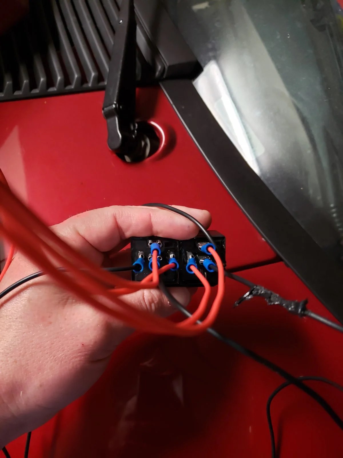

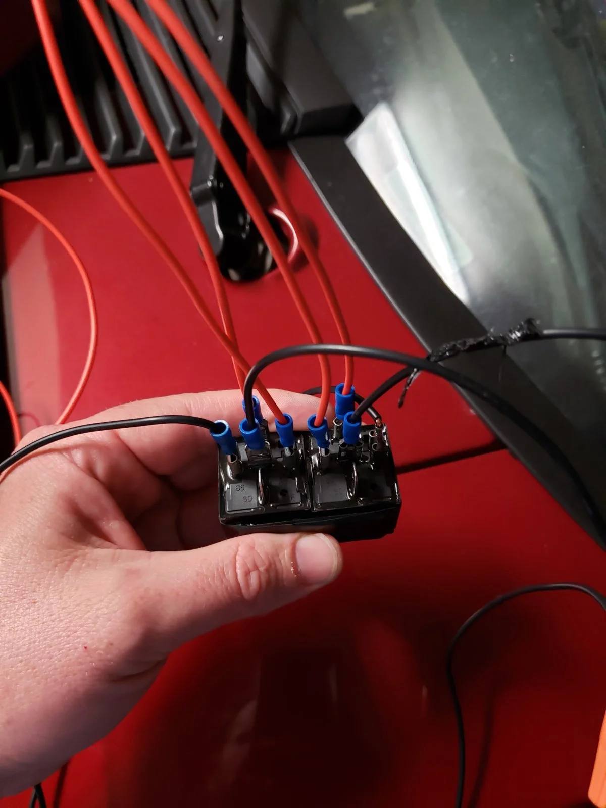

This is how I have my relays wired up.
When I first wired it up the door locks worked using the switches on the door, but when I try to use the key fob the relays click but the doors do not luck or unlock. Now the switches don't want to work. This seems fairly straightforward but its kicking my butt. Any ideas of what I'm doing wrong?

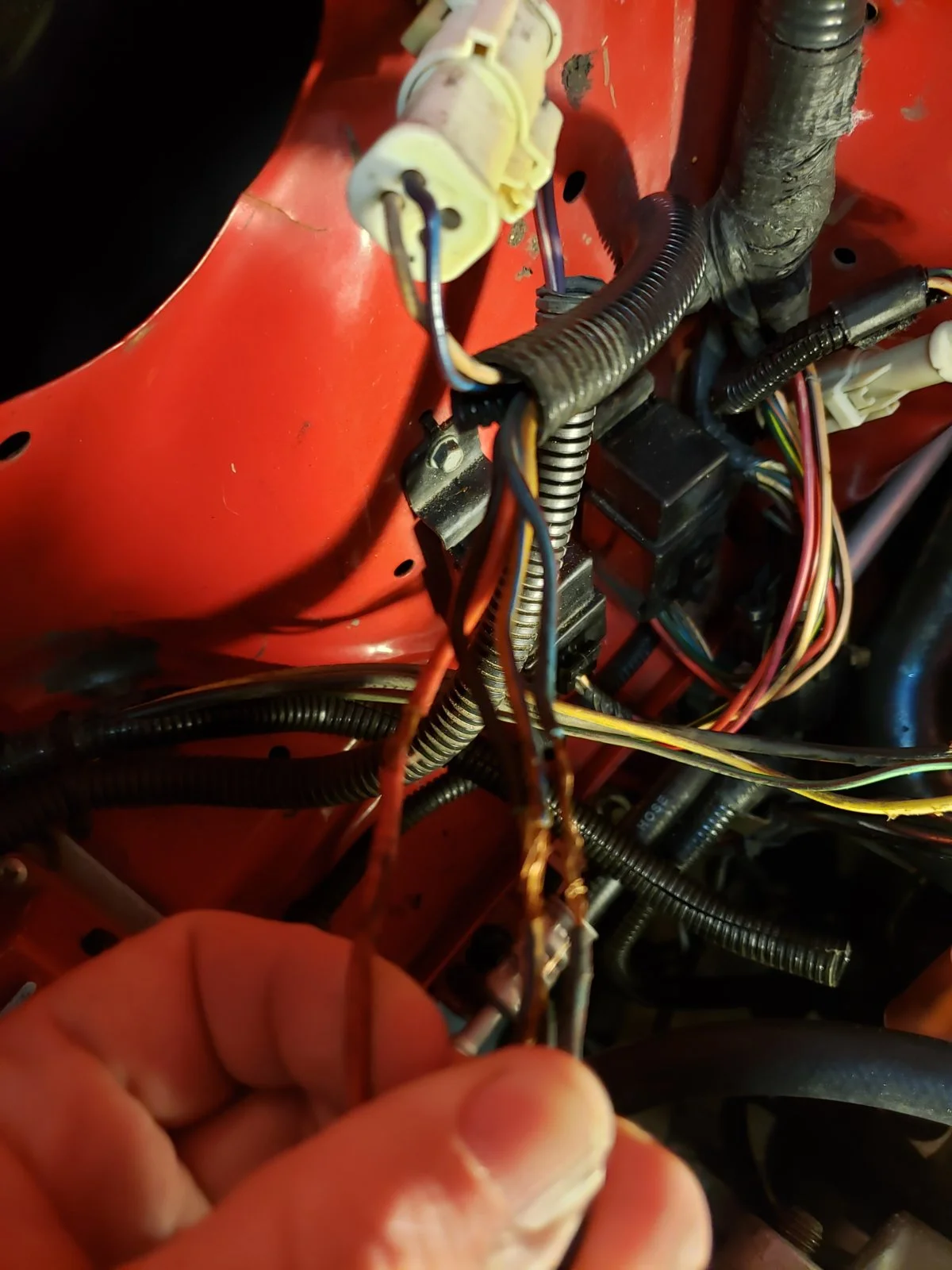

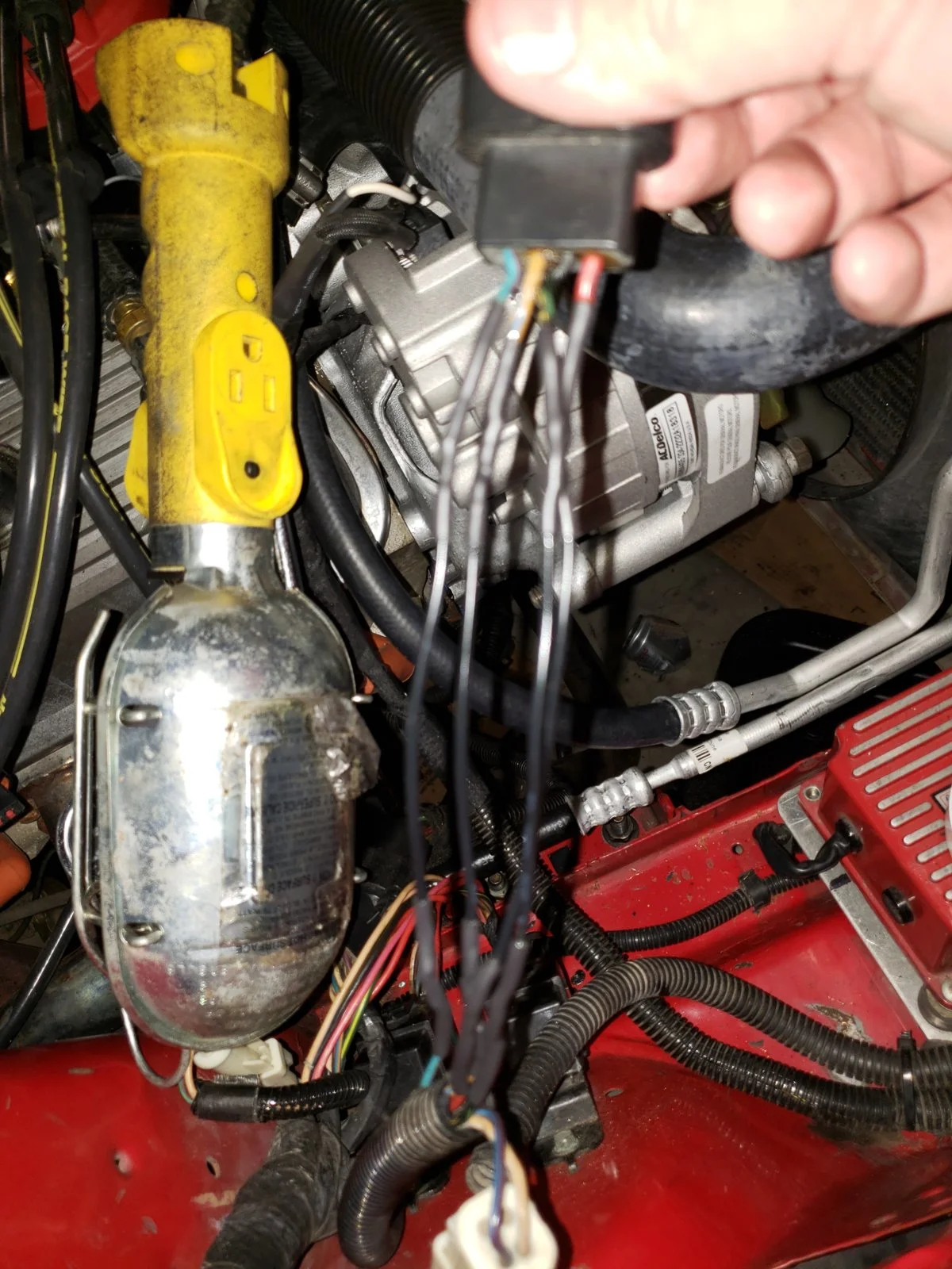

Still working on what's going on with the locks. In the meantime I got to looking at the under hood wiring. I found the the mass air harness had been rewraped, and didn't look quite right. I unwrap it and found that the shielding had been stripped in on the wires and jumper wires had been spliced in. I've got no idea why this was done. Any idea? Now I'm trying to decide if I want to just wrap the skint wires with electric tape or if I should cut out the bad and solder them back I together. What do you guys think?
Get yourself some heat shrink that is lined with adhesive. That'll provide even more corrosion protection.
Adhesive-lined heat shrink came in the Motorcraft wiper motor kit I used to replace the original on my Mercury (to adapt a later single plug motor on my car that originally came with a two plug motor).
I got the keyless entry working. Finally. Haven't had a lot of time to work on it. I had the wires swapped on terminals 30 and 87a. If they are not right apparently it will short out half the circuit resulting in fried switches among other things. This might be obvious to some just by looking at the electrical drawing. Wasn't to me. I've got pictures I'll post when I get to a computer.
