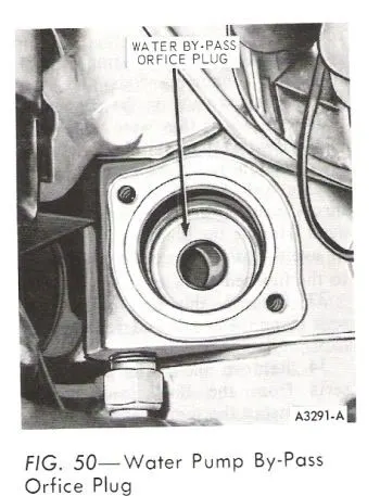

The 351C requires a unique thermostat that seals the bypass when it opens. If there's a generic 'stat in there, you have no hope, it will overheat. Even with the right 'stat, if the bypass restrictor ring is missing, it will overheat. As for your reading, if grounding the lead causes a "hot" reading on the gauge, but it does nothing when connected, either it's the wrong sensor, or the sensor is dead. Find a used one, all the currently available replacements suck, and read way too high.

Angryman, after reading both of your posts My guess is that your missing the restrictor plate and have the wrong or stuck stat.
Without the plate and proper stat for the C engine, your temp guage will not show what the temp is untill it starts running hot.
Look at the pic 2+2Gt supplied, the sending unit is in the upper corner and
without the plate and correct stat that blocks it off when open the coolant mostly goes back thru the block and not out to rad.
This will show as low temp reading till the coolant starts to do a heat transfer with the cooler coolant from the rad. By then the block is hot but not showing at the guage.
Thanks for the replies. I took the housing off and the thermostat out. Its a Gates 33129 which is a correct replacement for the 351c. I also see the restrictor plate inside the tank. Now that I know what I'm looking at I was able to determine that the thermostat was not stuck open either and was in the closed position which doesn't help firgure out my problem.

I am a little confused though about the restrictor plate and my eyes are starting to go crosseyed from searching the internet. I have a plate that looks like it is cast integral inside the block. The diameter off the hole is about the width of my thumb. Is there supposed to be a removable restrictor piece on top of this, or is that it? I have read where the integral unit was only on the 351M and that the 351C was supposed to have a removable plate.
