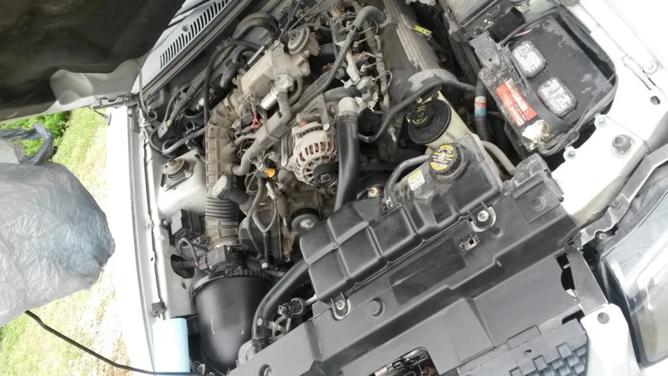

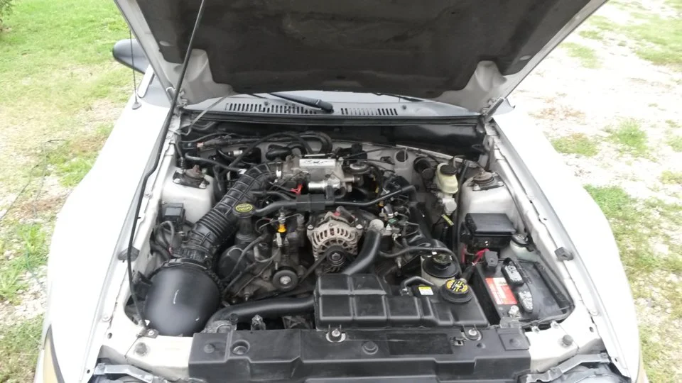

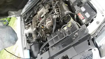

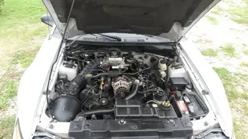

An easy way to tell if the engine has been modified extensively is to look at the color of the injectors. Your pics show that you have the stock orange top 19lb injectors.
