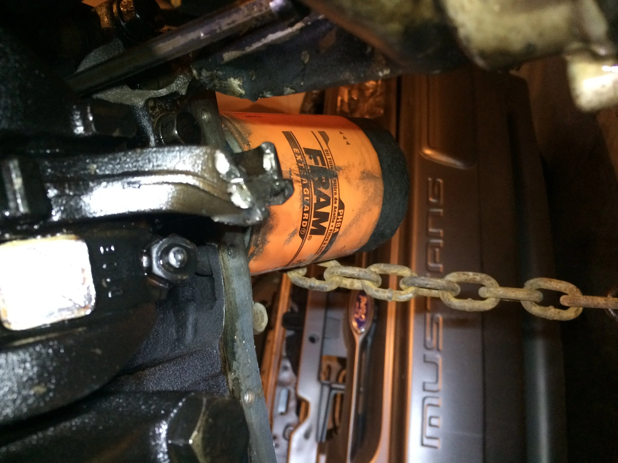

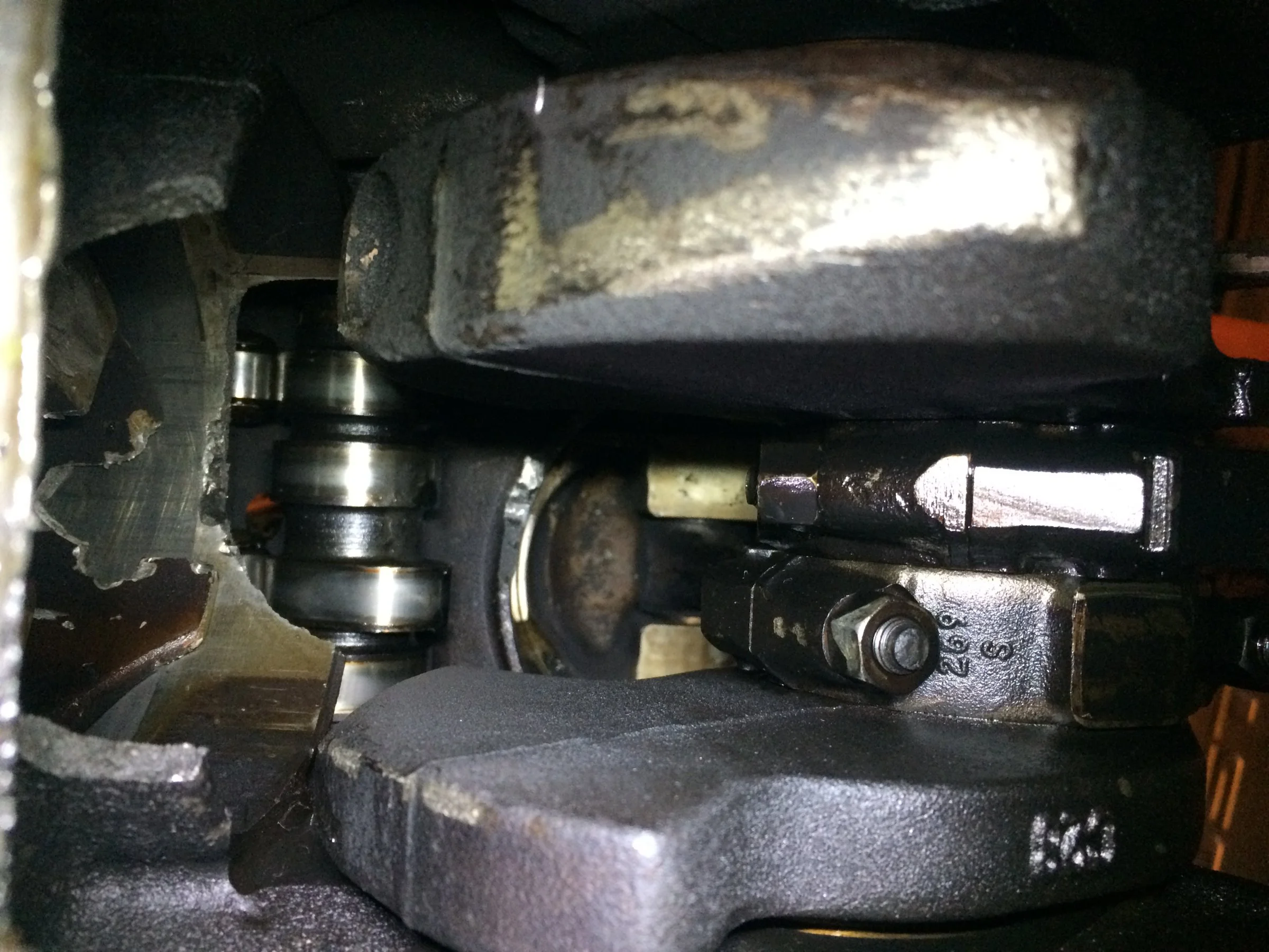

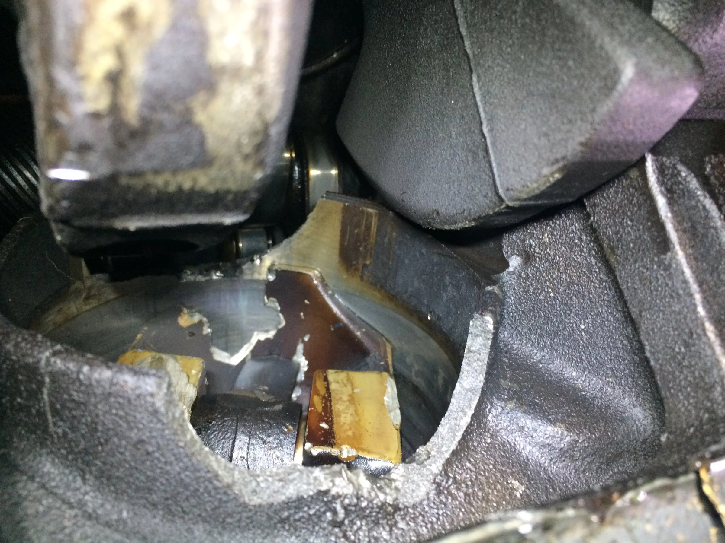

Hey everyone, just picked up my first Mustang on Saturday for a pretty good deal. Car is in great shape but it blew a connecting rod and chewed the block up pretty good.

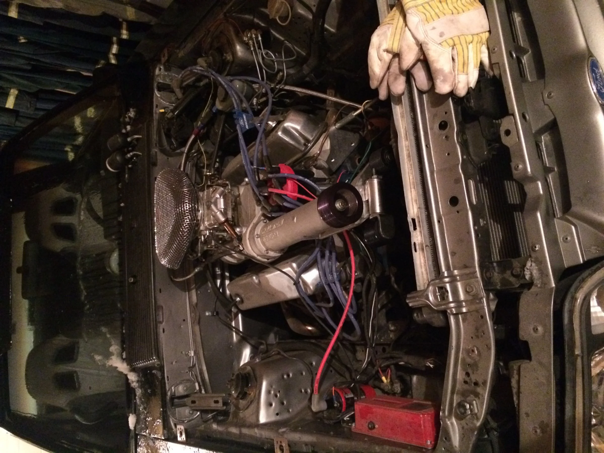

Currently the car has a 302, with
- Edelbrock e street heads (1.900" intake valves, 1.600" exhaust)
- Holley 670 cfm carb
- MSD ignition box, blaster 2 coil and msd distributor
- BBK shorty headers
- Weiand 174
Not too sure what it has for valve springs but it has comp 1.6 roller rockers, lifters and cam are tore up from metal containments

Thanks guys, yeah the block I have is beyond the point of repair. The rod that let go tore it up nicely.
