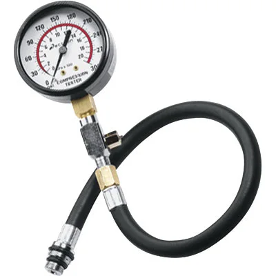

You can do a compression test yourself by getting a compression gauge from a local parts store:
Remove the spark plugs, install the tester into each cylinder, hold the throttle wide-open and crank for 4 or 5 turns. Repeat for each cylinder and look at both the absolute and relative (i.e. compare highest and lowest on the engine).

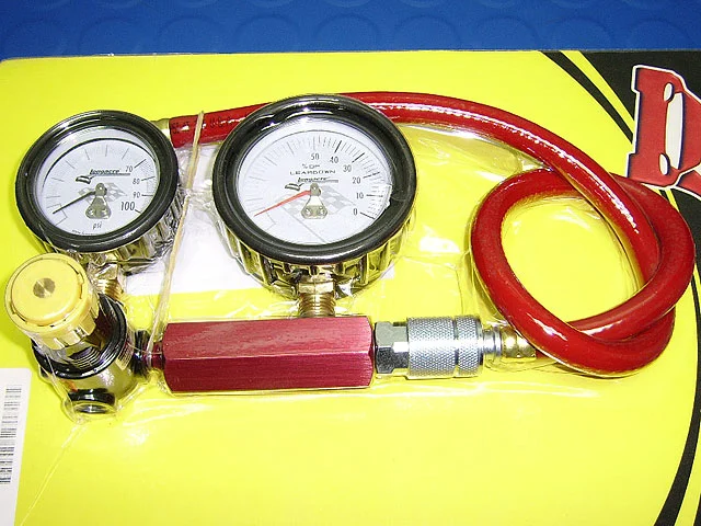

This will show basic engine health. A leakdown test will provide more detail on the state of things like the rings, cylinder walls, valves and seats etc. You need a tester:
and a source of compressed air for this one. The cylinder is pressurized and the rate at which the pressure bleeds down -- past things like the rings and valve seats -- will further define for you the condition of the engine. With the cylinder pressurized you can detect leakage paths: open the oil cap...if you hear air rushing out you can determine the rings are leaking. Out the exhaust or intake suggests valve sealing problems. And so on.
