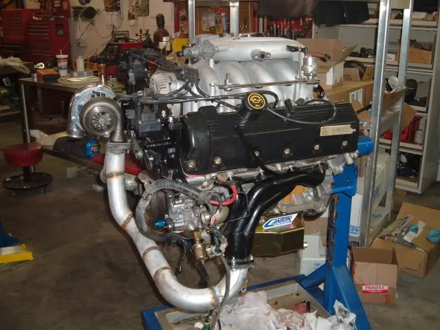

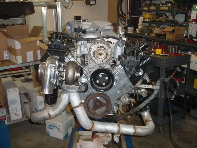

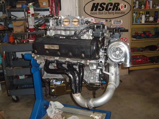

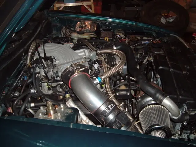

the Single kit will be almost identical to what i've got now, It will just use a different set of custom tubular headers. V-band clamps on everything w/ your option of Mild steel, aluminized steel or stainless steel (stainless will be extra $$). I can offer JUST a hot section w/ headers and Y pipe to the turbo. Or i can do a full kit minus turbo stuff. or a COMPLETE kit. I can do 38mm or 44mm Wastegate flanges.
I'm looking at making approx. 700-800rwhp on my Single T-70 kit. If i dont get close to my goals, it will be removed jigs made and replaced by a Twin 61mm Kit. And then i'll be making jigs of the twin kit to begin selling them.
Here is what my kit looks like:
Everything will be Tig Welded, and High Temp Paint Coated. IF i can find a local jet hot coater ( I've found 2 recently), i can have everything jet hot coated for extra. There are a few differences between the kit on my car and what i'll be selling.. 1. I will have the airfilter pointing the opposite direction on the turbo for more hot section/cold section clearance. 2. The downpipe will not be a full exhaust. It will only be about 15-30" long and the remainder of the exhaust will have to be done by an exhaust shop for differences in car setup reasons. 3. The turbo May be mounted where th battery is located requiring a battery relocation kit (which will not be included in the kit), but would like opinions on if you would want this or not.
The Goal is for me to make a Turbo kit available that is REASONABLE in price.. I'm not in this to make thousands of dollars, but i'm not going to barely break even on materials expenses either.. The turbo's will be from Master Power, and the Wastegates will be either Tial or a Tial knockoff that i am currently using w/ great success. BOV's will be buyers option. Or i can supply the hot section

Are you going to redo the drivers side header to clear the oil filter?
How much ground clearance with that 3? inch down pipe?
Will you include the MAF? (I know you said - fuel injectors/pump)
Will you include an intercooler?

just to give you guys an idea of the power i'm making untuned with the setup in the pictures above.
In 3rd gear w/ 3.55's in a IRS, and 14lbs of boost, i start spinning at 65mph and keep spinning until i shift into 4th, then once i get back on the gas i start spinning again.
This is with 5* of timing and a 10.5:1 air/fuel ratio, as i am untuned until the 5th of may.
