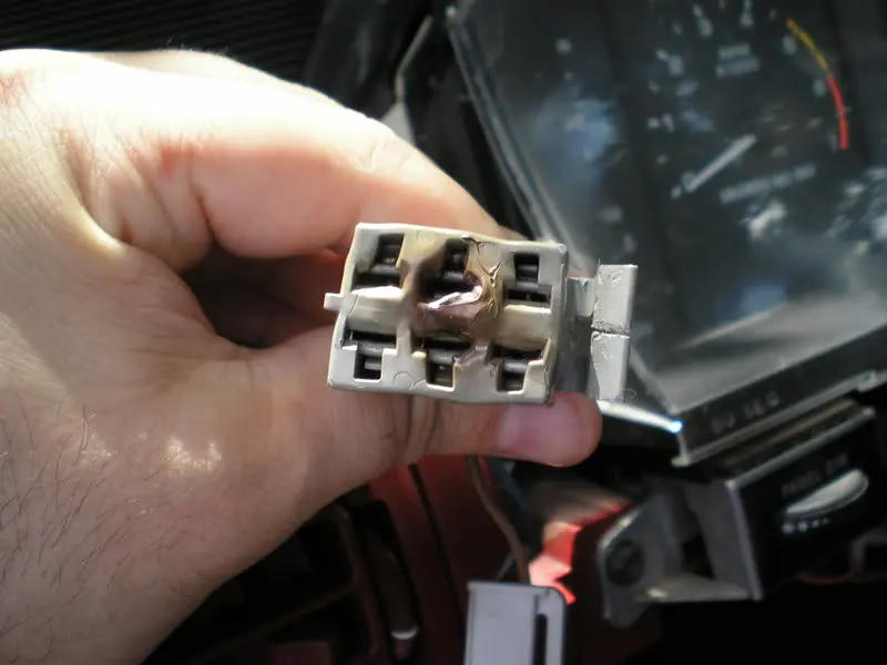

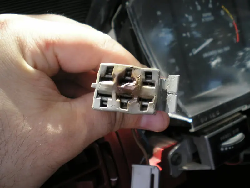

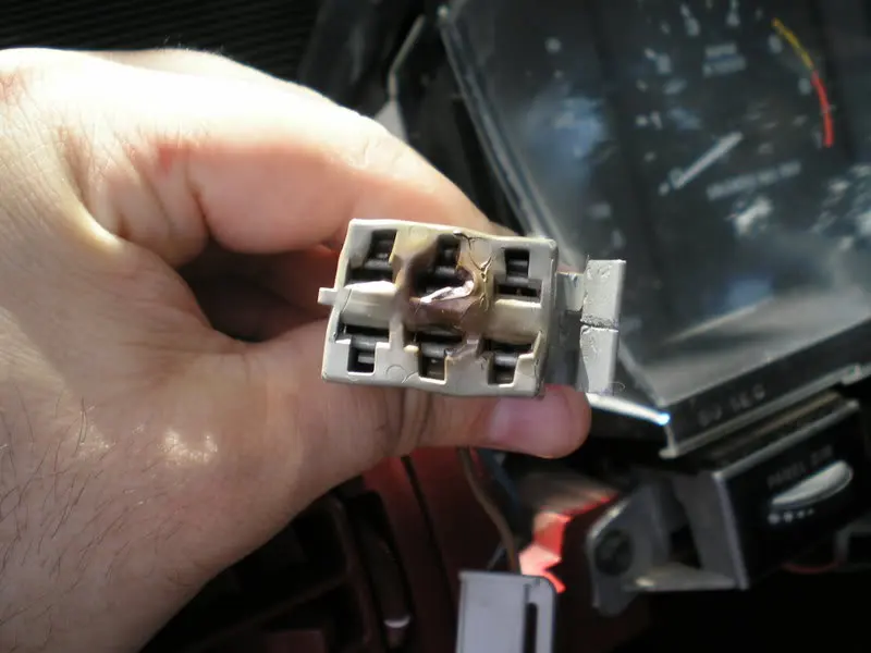

The power mirror switch decided it didn't like the car this morning. FUN!
I noticed last night that when I got into the car, the drivers side mirror was all the way up and to the left. Didn't really think anything of it after my experience with that repair shop yesterday. Got in the car this morning, and it had done it again. I thought I'd just run down to a junk yard and get a new switch. Obviously I never made it that far. Luckily I was in a parking lot of one of my customers, so a fire extinguisher was close at hand. The damage is all superficial thankfully. Not even the wires to the switch got melted. Just the switch. I'm also lucky it didn't get those two butane lighters siting RIGHT above the flames.
I've got a buddy of mine who knows EVERYBODY making some phone calls to see how cheap I can get the replacement parts. So far, I need a new switch, upper and lower console plastic (ashtray, whole nine yards), & new harness ends for both the cigarette lighter and the mirror switch.
As a side note, does the mirror switch have power all the time? even when the ignition is off? I know the lighter does, and I couldn't find a fuse labeled "Power Mirrors" so I just pulled the lighter fuse.
Mirror switch is powered by fuse #8 which powers all of the interior lighting, hood light and radio. It is hot at all times (not switched).
