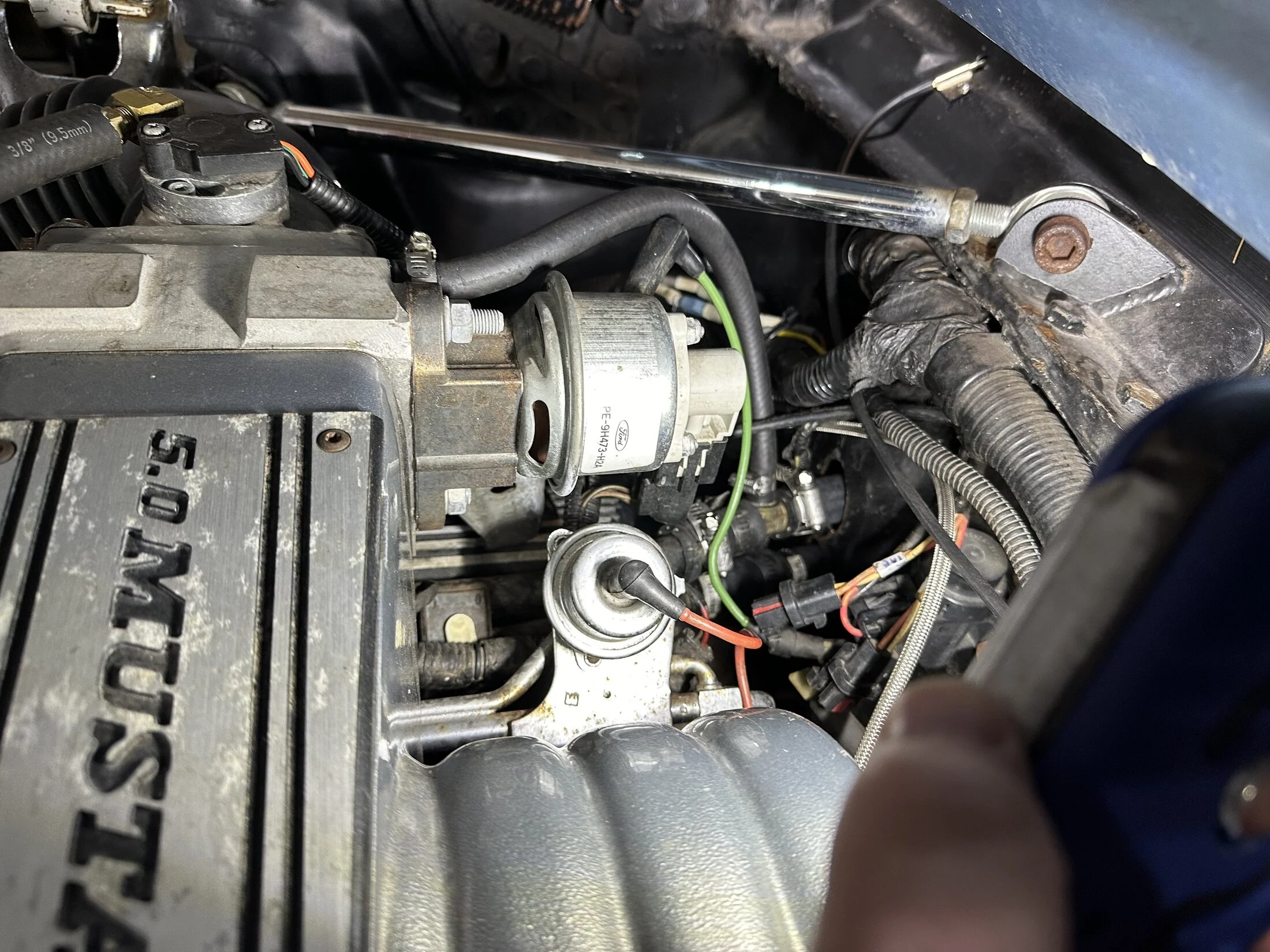

Also, his BAP sensor is connected to the intake manifold vac, but he's running a C3W mass air ecu. He needs to remove that vac line. I bet if he solves that and the ACT issue the car will run much better.

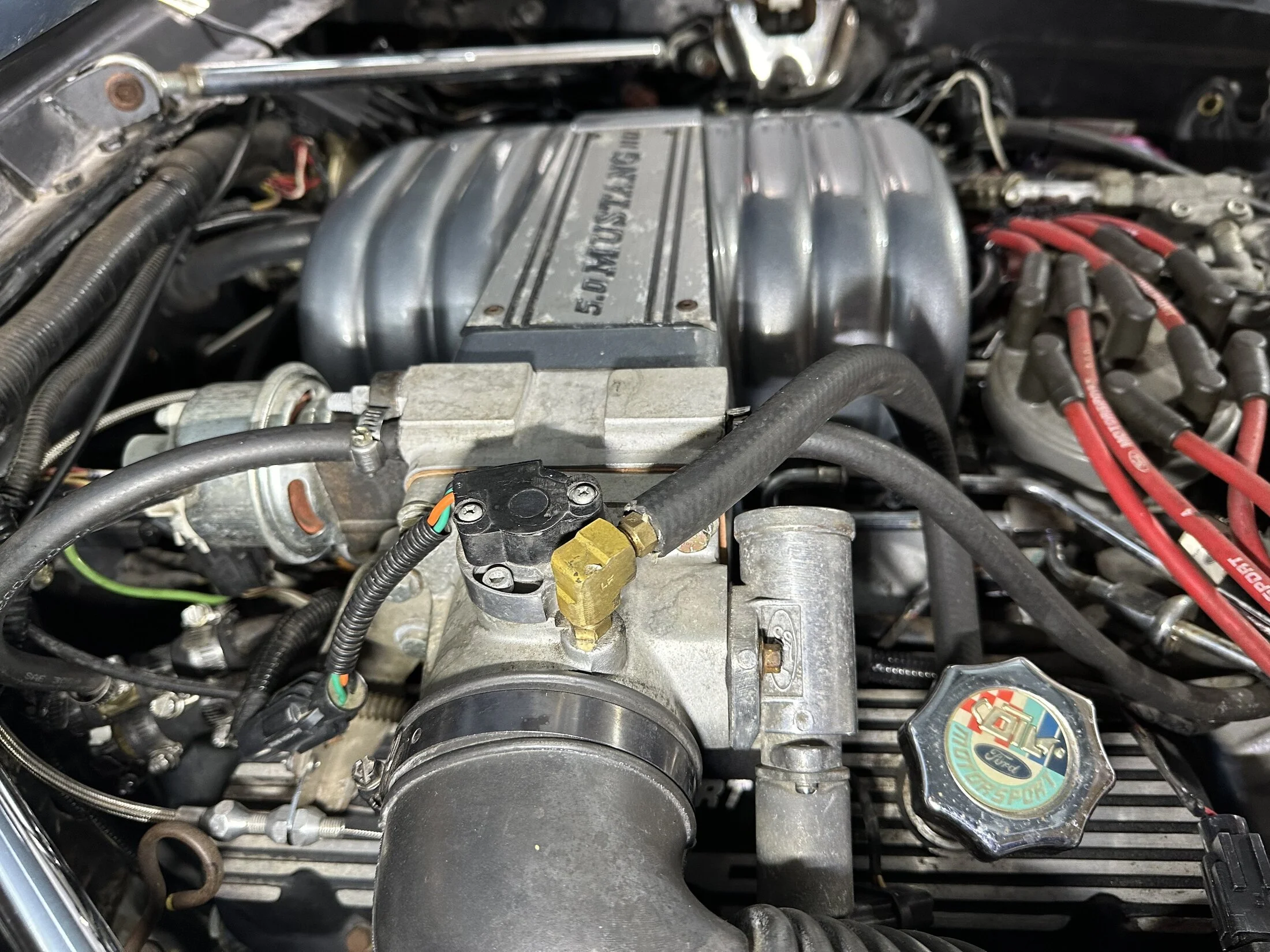

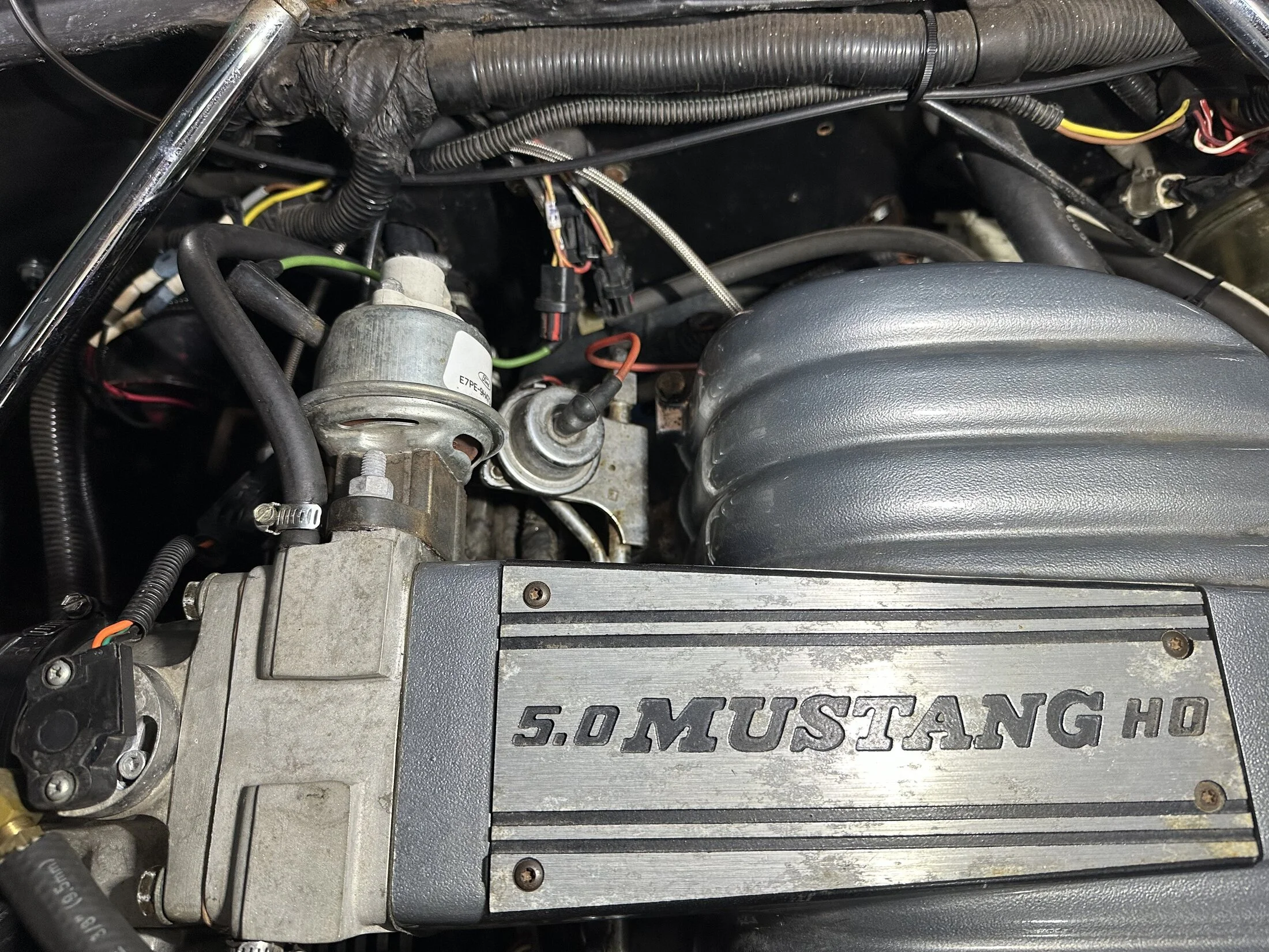

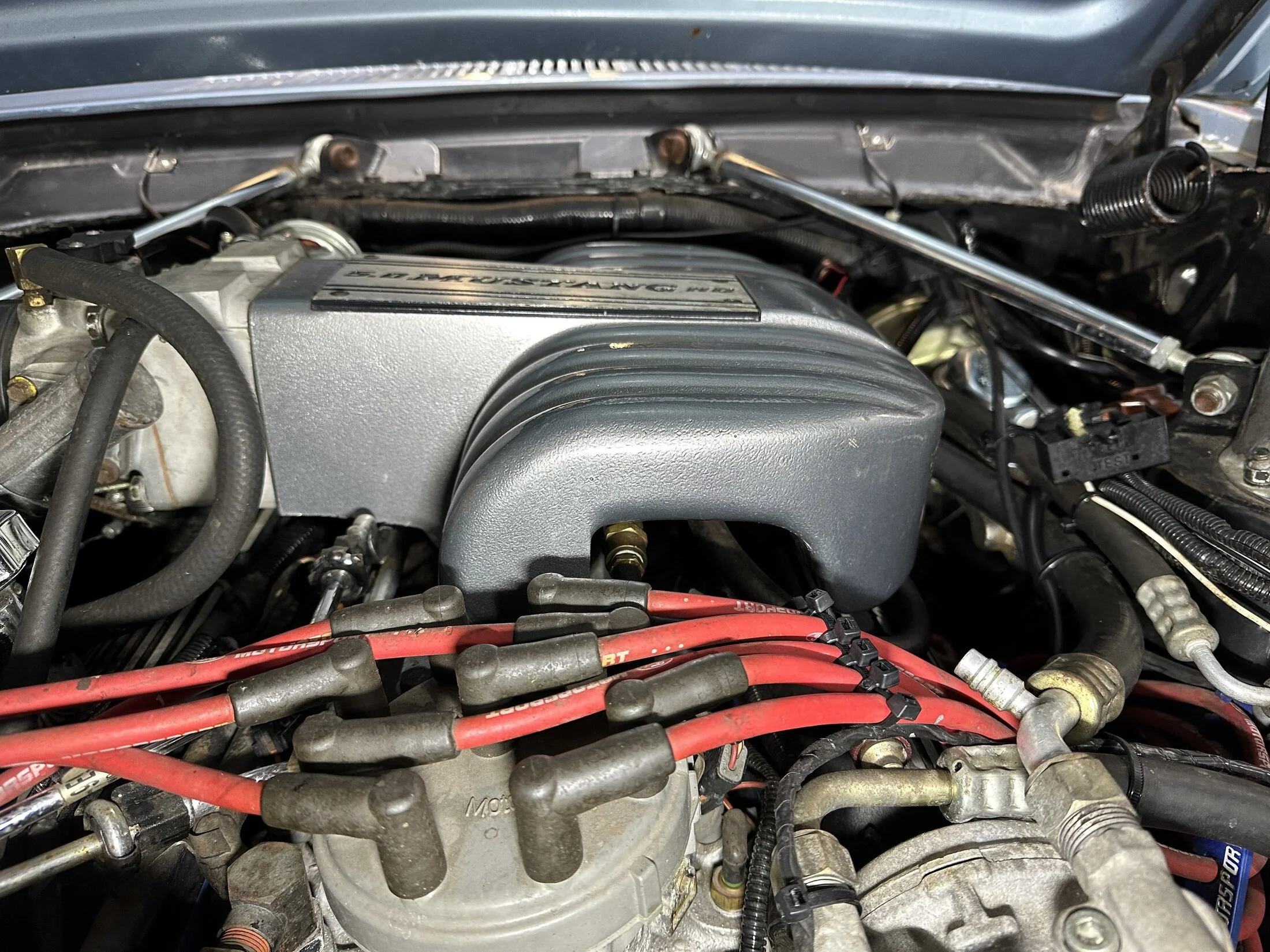

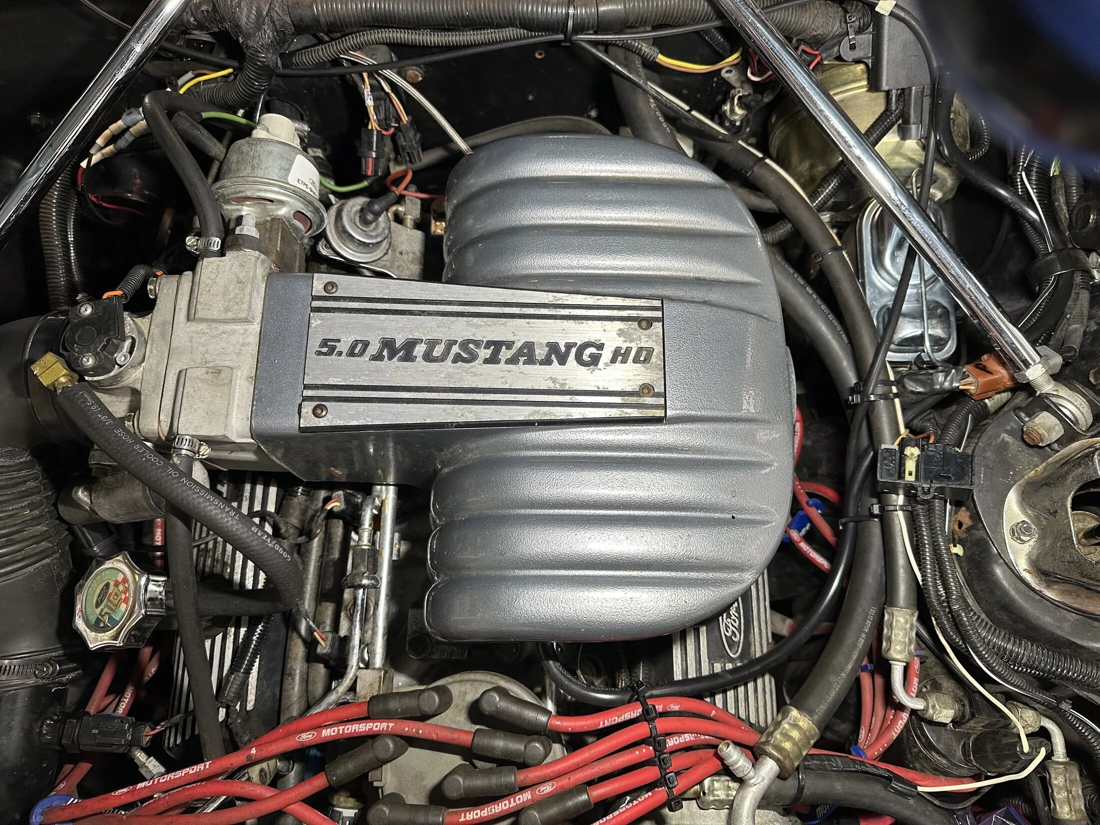

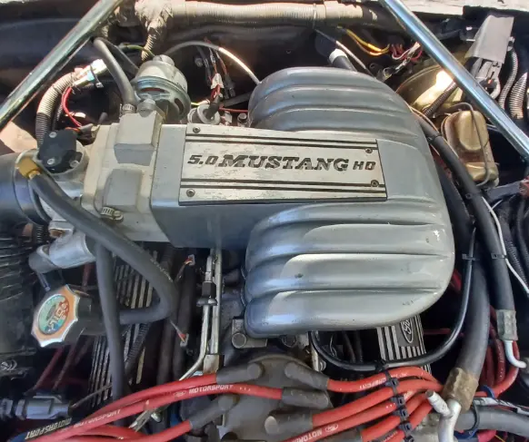

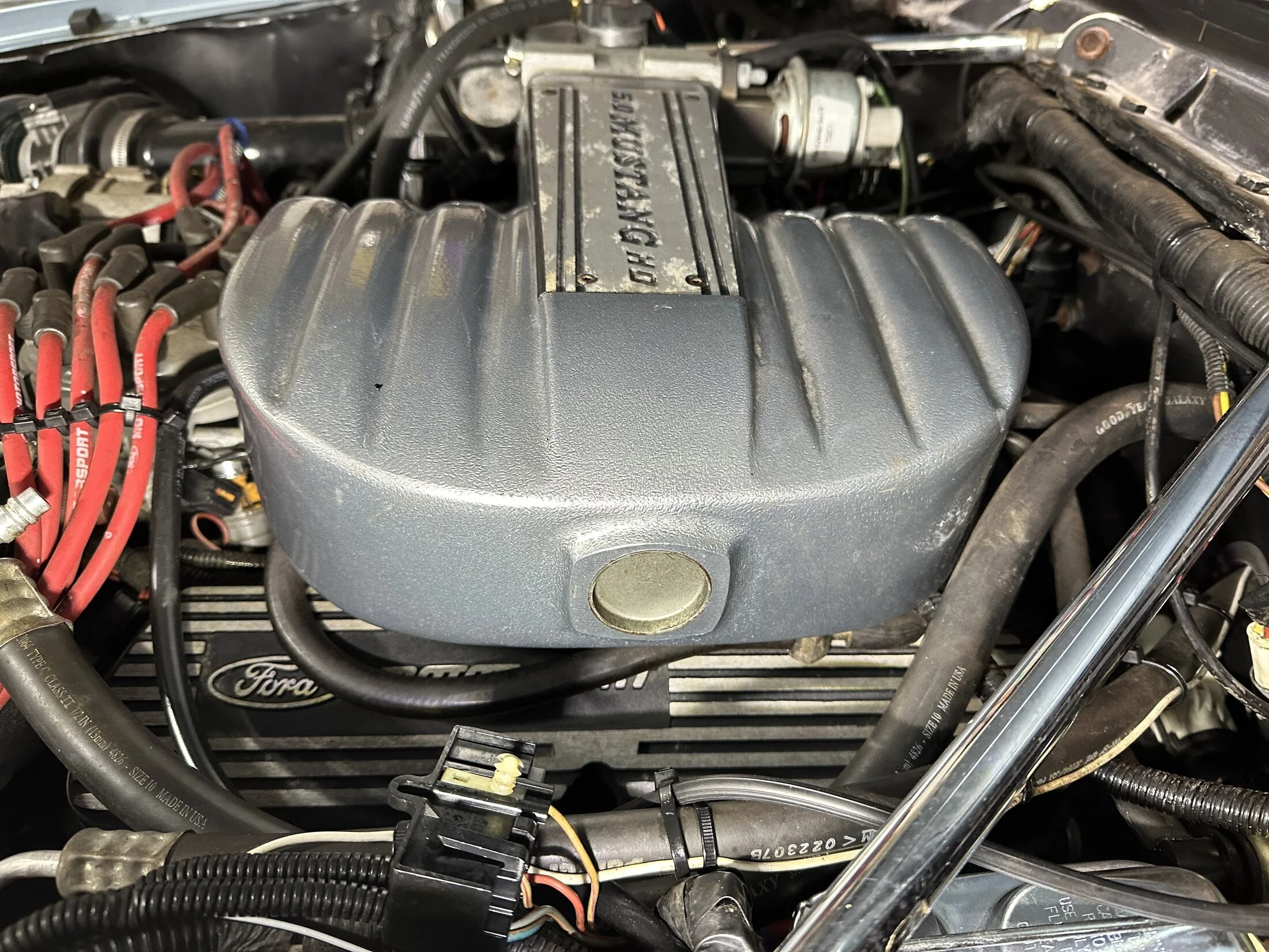

Also....why was this done to a stock HO intake??
Not certain but I believe this is an attempt to fit the efi intake into the early Falcon/Mustang engine bay with power brakes. Greatly f's up the air intake volume/flow
I would have tossed a 1/2" spacer on it instead to lift it up.
The reduction in plenum volume concerns me, as well as starving the front and rear cylinder.
I told him to just get an Explorer upper and lower and get rid of it. I think somebody got cute as there appear to be room for the stock intake as I have seen them on other 65-67 cars with no mods.
I didn't read the comments here and i saw that intake, thought it was some kinda curved camera filter.
If that's a modified stock intake, i wouldn't even bother troubleshooting anything else with it in place.
I never cut open a factory intake, but i can't imagine its good.
While i'm not a fan of short runner intakes on a stock engine, anything has to be better that whatever that thing is.
What’s sad is that AeroCoupe gave him the best advice money couldn’t buy, and he is still wasting his time over at VMF with hairbrain ideas, instead of resolving the two codes he got from the ECU. I sent him a PM recommendation: take it to one of the 2 know shops in his neighborhood who know these cars and let them fix it. He told me he’s considering it. I also told him to take a few more level pics of the intake so we can get a better look at the unusual setup.
It’s a one off by someone that had/has no clue about airflow. I suggested he get an Explorer upper and lower. By the pictures and from the 65-67 Mustangs with Fox Mustang EFI swaps I’ve seen there was no reason to cut the intake down because the stock fit with no issues.
if his skill level is not high I would probably suggest picking up a standard HO intake and starting from there.
I don’t mean that as a “clean up the bay” suggestion, but rather a serious suggestion as it could also be a cause of the issues he is experiencing related to poor fuel economy. He might have uneven volumetric efficiency to each cylinder which is screwing up the air/fuel mixture.
Reactions: General karthief
ACT sensor is already relocated to the tube between the TB and MAF so the Explorer upper and lower would work. I think it has GT40 heads (crate motor) which is why I suggested them.
