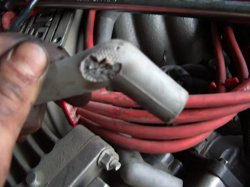

1: Your spark plug wire on cylinder #3 will ALWAYS look like this after about 6 months or so no matter how much they cost or how its positioned

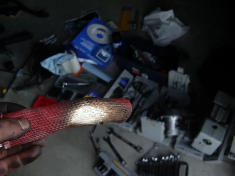

2: Yes, even if you use those high-heat boot protector sleeves (this came off the plug wire pictured above, notice the huge white spot where arcing had occurred)
3: Obviously, this arcing of the plug wire onto the header will cause an occasionaly misfire, that can inevitably lead to confusion, loss of temper and mental anguish

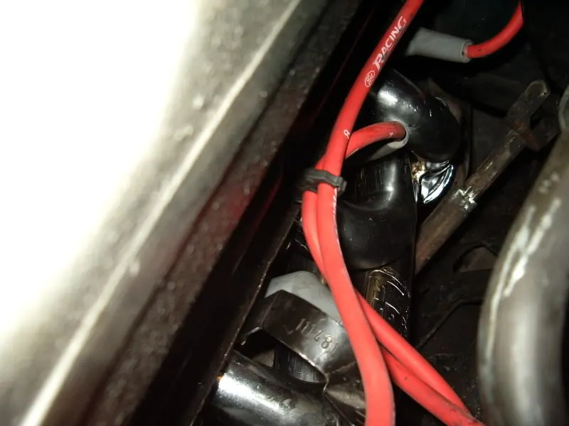

4: How the f*** are you supposed to get this damn whale of a header in or out of its dwellings????
I hope this changes the minds of any of you who are considering buying equal-length headers, especially Mac ones. I'm replacing mine with BBK standard shorties, and so far I've got the passenger side all buttoned-up, it was ridiculously easy to install.
As for the driver's side, I'm stuck. I faught with it for 4 hours trying to get it out from the top, but its not gonna happen. Tomorrow morning I will remove my X-pipe and steering shaft and try to take it out from the bottom.

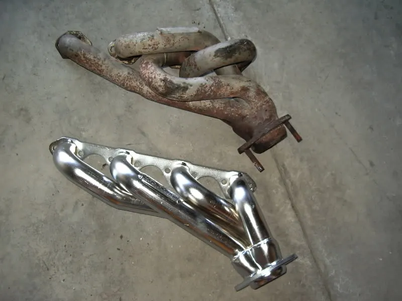

Well both headers are finally in. I caluculated that I spent a total of 8 hours getting the old driver's side header OUT of the car. The new BBK was bolted-in in a matter of 30 minutes. I had to first take-out the steering shaft, then remove my mid-pipe, which the previous mechanic who installed it welded the bolts at the rear flanges so they wouldn't back-out, so I had to cut those and get new ones.
That would've been enough but my car is a 'vert and has that goddamn cross-brace below the K-member, and that had to come off as well for the header to slide-out. 2 of the bolts for that had to be grinded-off.
Here's the bastard next to the new kid:
Finally installed and all buttoned-up:
Well after 2 full days of header swapping, I'm not 100% done, I still have to put the 'vert brace thingamabobber back on and tighten the mid-pipe-to-cat-back flanges which I just loosely bolted-up. But I did start the car just to make sure I put everything back on correctly, and it fired right up :rolleyes:
This was by far the hardest thing I've ever done on my car. I think an engine swap would have been quicker and easier. You long tube guys are probably laughing at me now.... I don't even want to imagine how much harder those are to put on.
