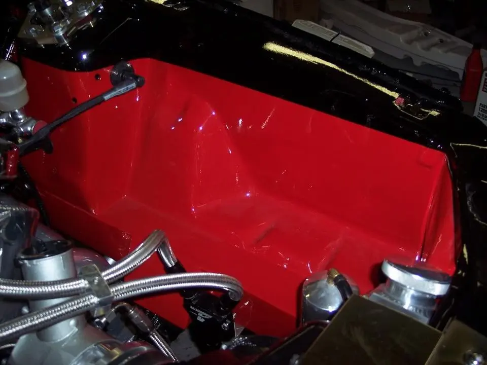

I mounted the coil where the washer tank used to be. Basically, where the hole is in the fender apron, i was able to mount the coil there, with the harness side in the fender, so all you see is the coil wire side.

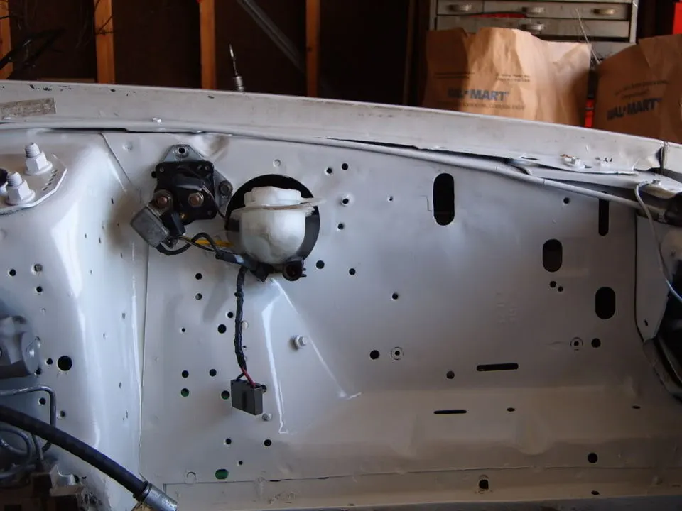

Which solenoid are you talking about? The starter? If so, that is mounted upside down in the fenderwell, there were a few wires i had to extend, but nothing major.

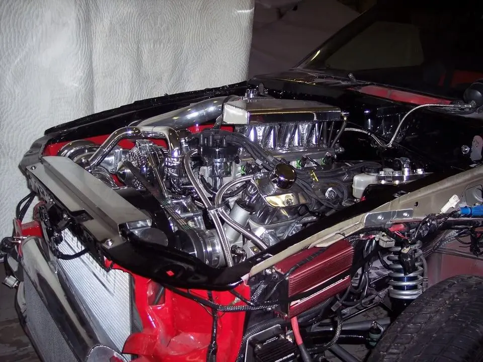

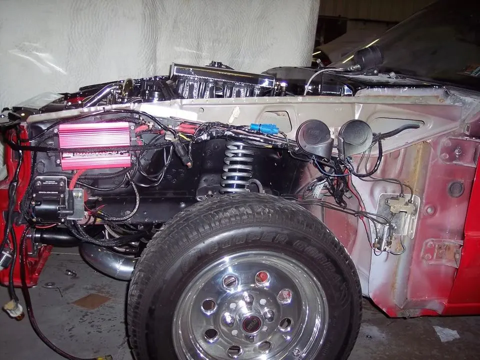

my coil i left in the stock location but will be moving it soon. my solenoid is mounted in the driver inner fender. here are some pics of mine.peace
john:p

Thanks for the responses and pics. I am going to go finish up this little project tonight I hope . I have decided to put the coil and solenoid in the engine bay mush like the way chuckman has his mounted.

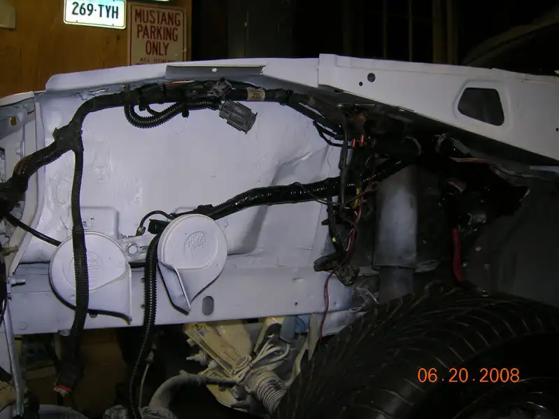

Smoked ya - that is an amazing job!! and thanks for the inside the fender picture that will help me when I can't remember what plugs where tonight .
