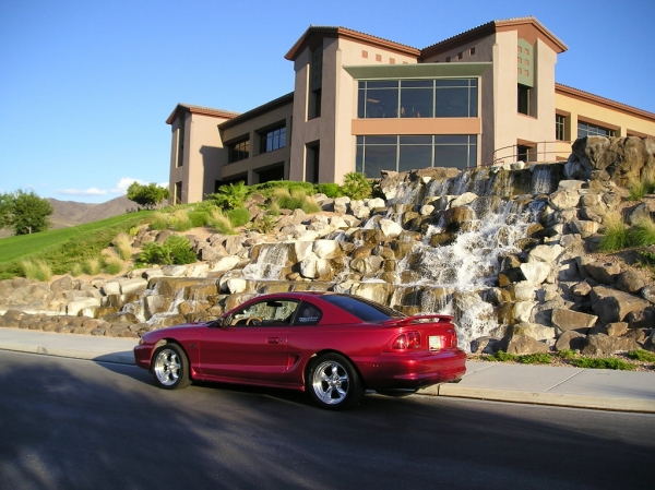

If you don't mind that it doesn't drop much (.75"), its a great kit for the money. The swaybars are a couple of mm thicker. I think the C springs drop too low in front. The bullitt rear springs have a rate of 250 which i think is perfect for acceptable comfort/handling. If you got the C springs you would have to buy caster camber plates.
My car with bullitt suspension (waiting for install of MM front coilover)
-wade
I have had it on my car for a while.....handling is much better..however I still have the stock sway bars.....I wish the drop was better but if you want something in between stock and dropped then this is the kit....I am going to be getting new springs soon or chopping my bullitt springs to lower it to a more "lowered" stance
pics...
