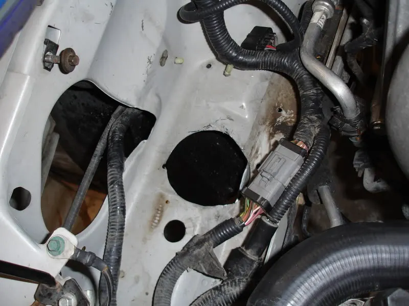

Looks like a decent kit, but you will have to trim the pipes to fit. You will also have to cut a hole in your fender for the pipe from the throttle body to go down into the intercooler. If you dont want to cut at all, I beleive paxton makes a FMIC kit, but its 1600 bux.
Use a hole saw bit for a drill. It looks way cleaner and it only took 2 min to do. I used an air grinder to smooth the edges, and it turned out very well. The metal is pretty thick stuff, but it can be cut fairly easy with the right tools.
To cut the pipe a band saw would work the best. You could also use a hacksaw, cutoff wheel, jigsaw, etc. I have a handheld bandsaw :)
