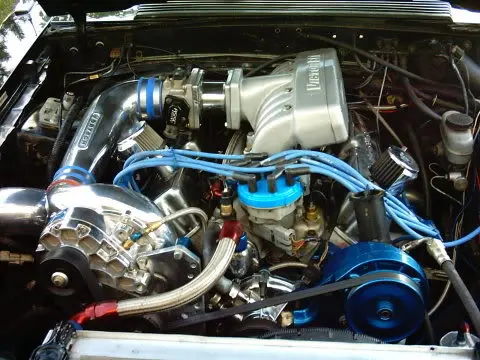

Thats what I used before I put on the blower,its just 2 brackets and the power steering pump moves up to where the ac was,then I put the blower on and had to go with the ac delete w/ pully and that didnt last long,put the ac compressor back in. I know summit carrys the 2 bracket style.

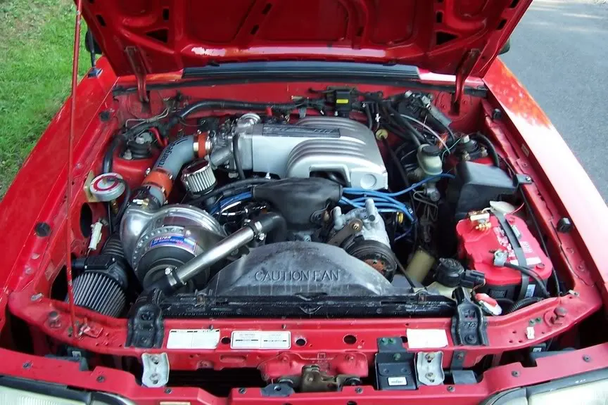

Here's how I did one
There are other ways to do it depending on your exact set-up.
The kit that moves the AC up is the FMS kit
That looks good rick. I'll look into trying to fab something up like that. I've looked into the FMS kit and have noticed that people have issues with the tensioner pulley and the water pump pulley making contact.
Its very simple to do actually, I done mine without any problems at all. I do have a 93 Cobra WP Pulley though to clear my 8" crank, but I didnt buy a new P/S Pulley like some say. Just done the little tensioner mod and it worked out great.
The hole in the plate where the tensioner goes needs to be redrilled and youll be fine.
