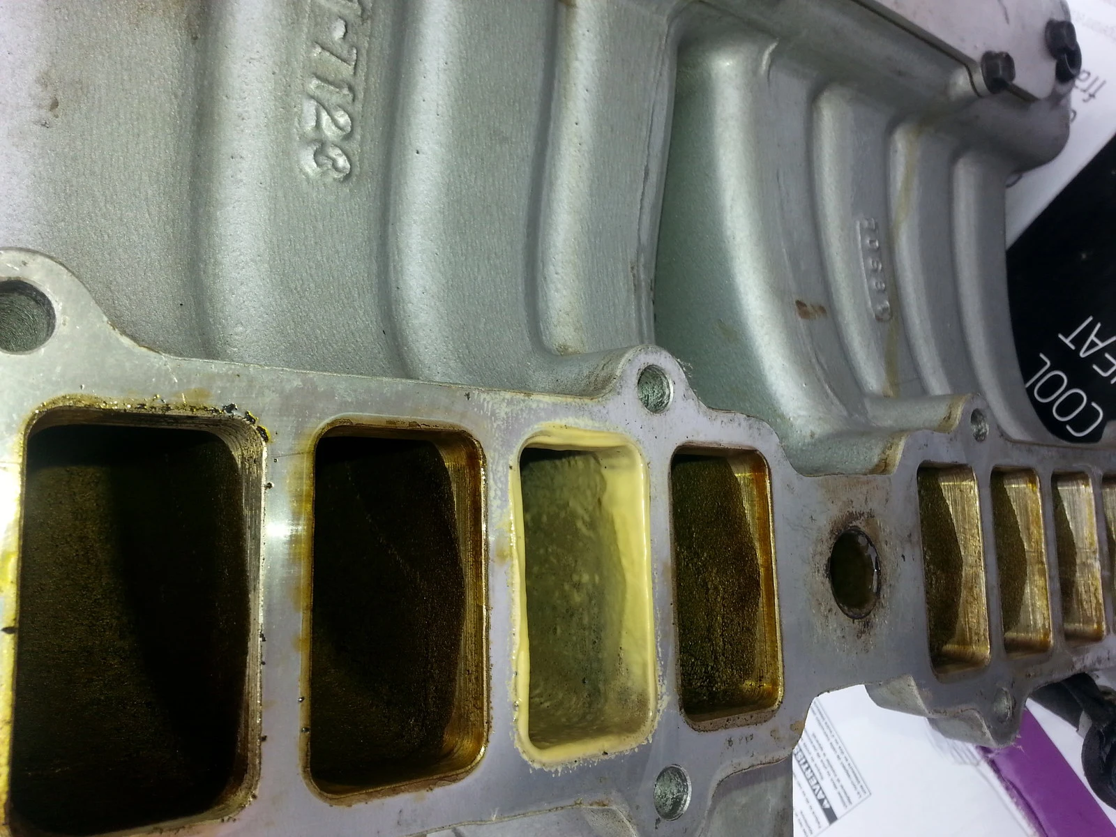

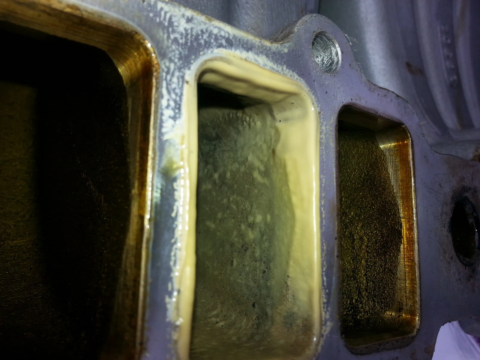

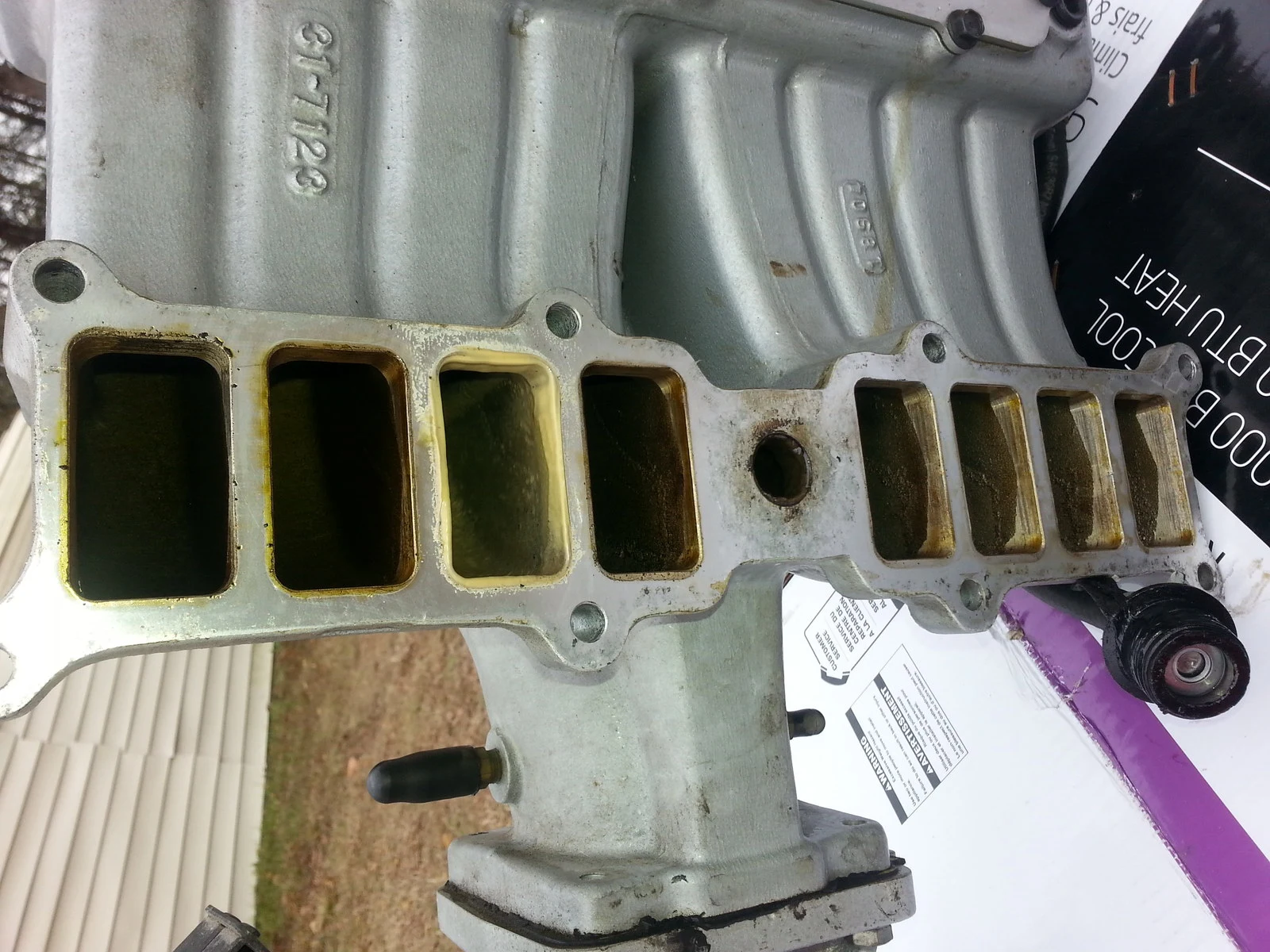

Just pulled my intake off as a part of my going to clean the throttle body and this is what I saw: going to try and post a pic here straight from my phone
just that one runner. I changed the intake gasket about 6 yrs ago and about 40+k miles. First time I had an intake bolt that had rung off and i was ineperienced at the time and didnt fix it right away thats why i ended up fixing it in 07 when the intake gasket blew. I did use felpro # 1250 but i thought i read something where guys were saying there was a better overall gasket to use. Is there one?
And what causes an intake gasket to blow if the car doesnt run hot? Is it just age and mileage?

Is your question why is there yellow stuff in that intake port? What is the nature of the yellow stuff? Wet, smells like coolant or something else? There is no coolant that circulates in that part of the intake manifold. Do you have the throttle body still plumbed with the EGR coolant? Pressurize the EGR coolant passages with compressed air and listen for air at that port.

there is no EGR on the car

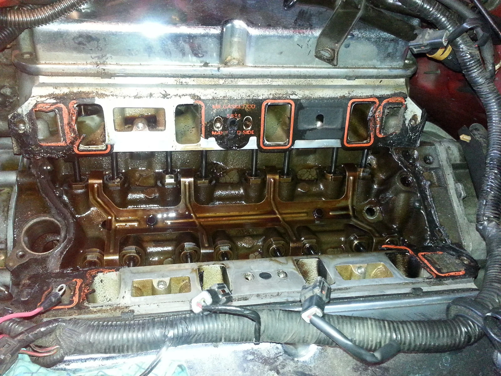

look at this intake gasket and tell me if you think that would of been the cause of water getting in there.
i'm confident this was the main culprit of my problems

The pictures posted are of the intake manifold plenum . I did not see a gasket, so I have no way of knowing what damage the gasket has suffered.
Here's what the gasket is supposed to look like:
What does your gasket look like?
There is no coolant circulating through this gasket. All there are are intake ports and the EGR gas port in the center of the gasket.
i posted a thumbnail of my engine with the entire intake off. No my plenum gasket is the more square one for the edelbrock performer rpm 2 and i'm talking about the intake manifold gasket
Still not completely sure how the coolant got into that runner specifically, but yes, it looks like your gaskets squished around the intake ports. Felpro makes a version of the 1250's that have a steel core and cannot be over tightened very easily. Might want to give those a try.

yeah im not sure either. I have to call edelbrock in the morning because I've read the instructions again where they said to not use the steel core one's for that the aluminum intake couldnt be torqued enough to prevent a leak without damaging the intake. I've read where guys said that thousands of guys have used them anyway though so i just want to see what they say in the morning and i will ask alot of questions
The only water passages in the lower intake manifold are the first ports on either side of the front of the manifold. It seems unlikely that water would get that far back without leaving some trace in the intake runners more towards the front.
even if you look at the gasket and where the water jackets are on front of lower, by it being torn up that badly, would water not be sporatic and get that far back?
what are the only options you think water would be in that one port only?
Water having leaked from the front water passage into the lifter valley would have created the water/oil milkshake we often hear about. I may have missed something in your previous post, but I don't remember it being mentioned.
