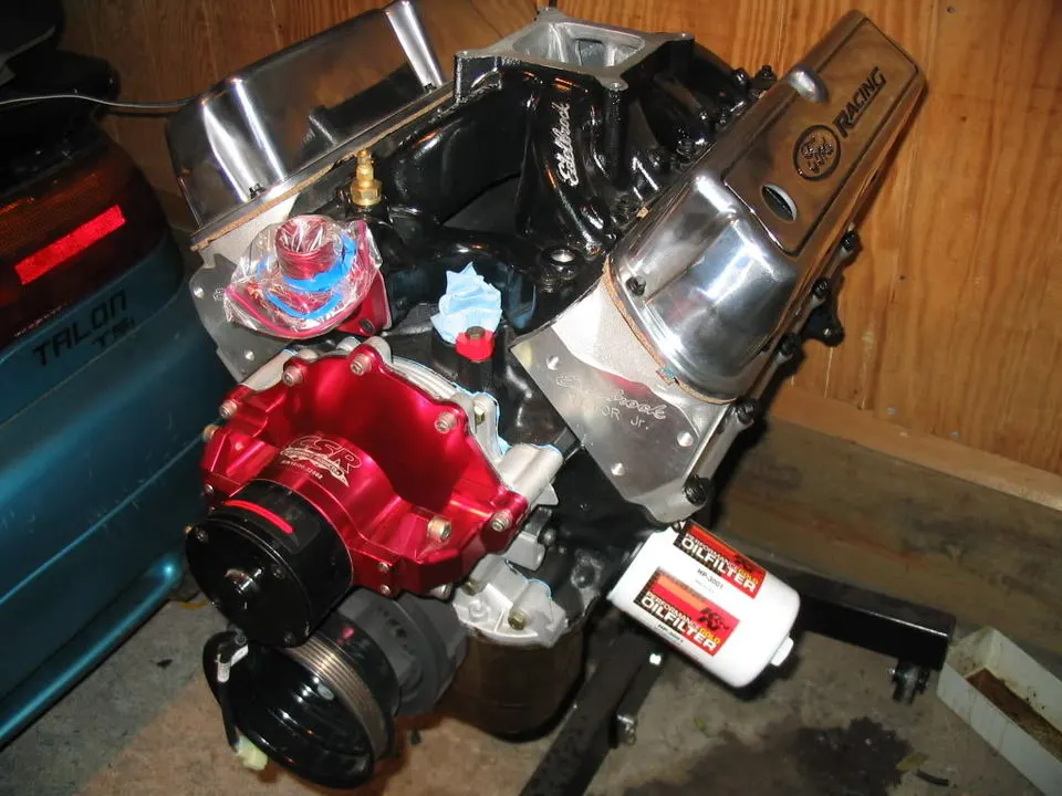

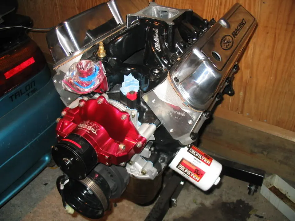

i have the csr pump, engine isnt in the car yet but ive heard only good thinks about them. Got there t stat housing to match the pump:D
