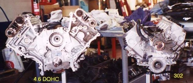

LUCAFU1 said:
are you sure a 4.6 weighs more then a 460?
They don't, they're just similar in size.
I've entertained the idea of a 4.6 quad cam, but i'll have to wait until I have that winning lotto ticket in hand. Then I'd big bore and destroke it to ~4L and see how high I could spin it just for kicks.
Annyway, I'd get the MII front end before struts.
